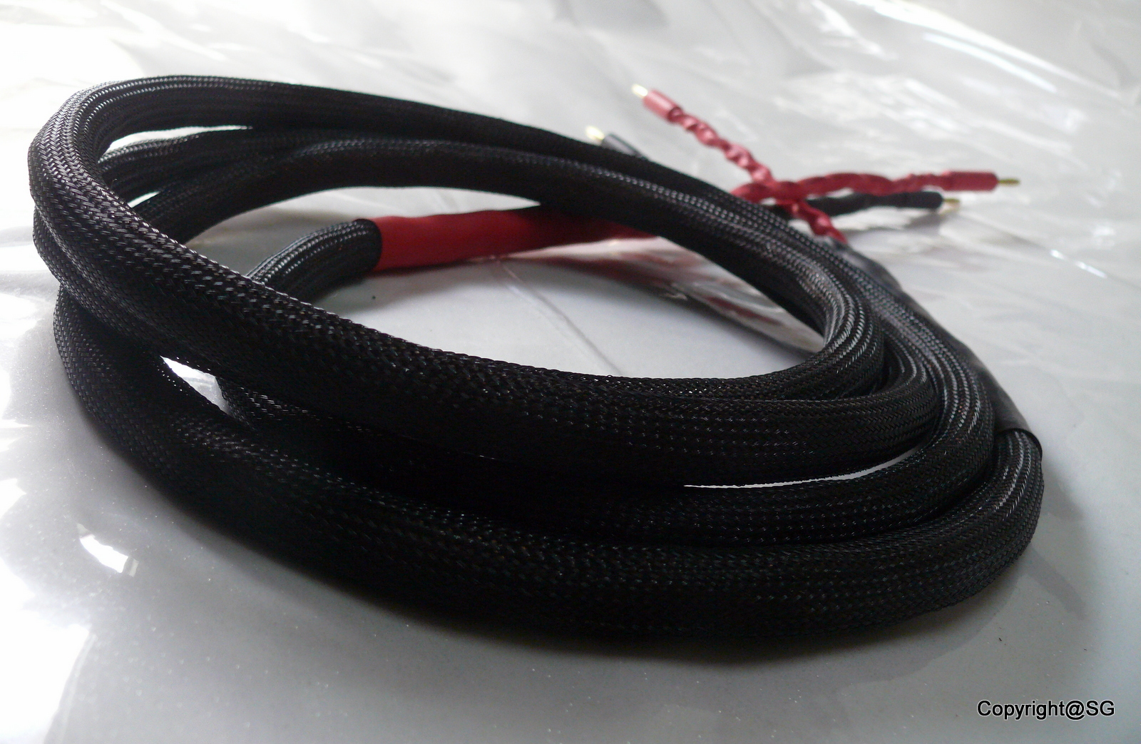

I Am a firm believer of cables and it's effects in your chain,And to that effect have done tonnes of cables in various ways,My braided cables are the one's I swear by !
I usually use Silver coated copper with PTFE Di-Electric,That is the best I have experienced (have heard my share of all the exotic cables).
This is the braided Speaker Cable I did many moons ago which is the basis of all my cables which has since evolved to a different level altogether.

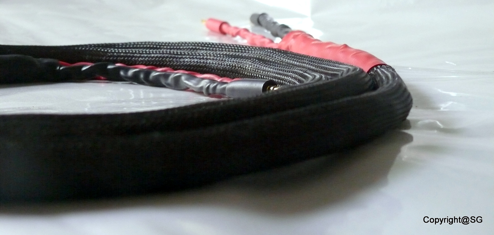

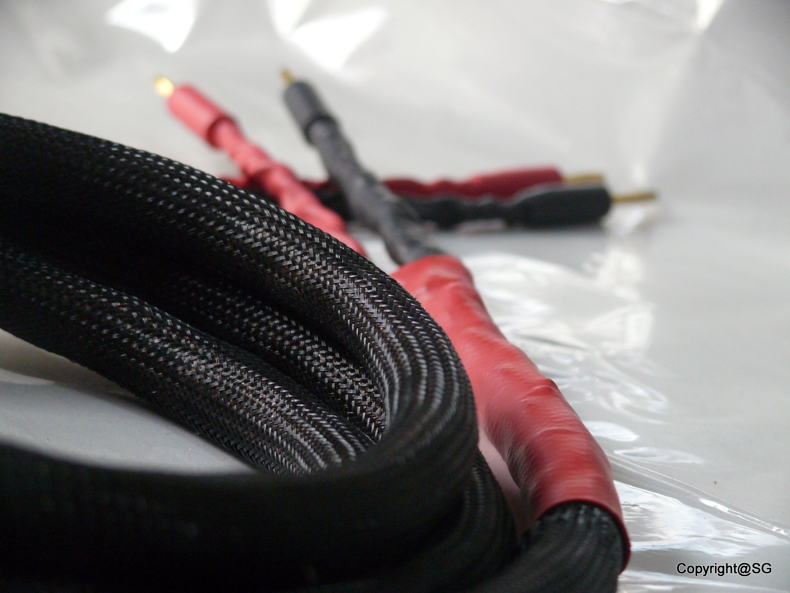

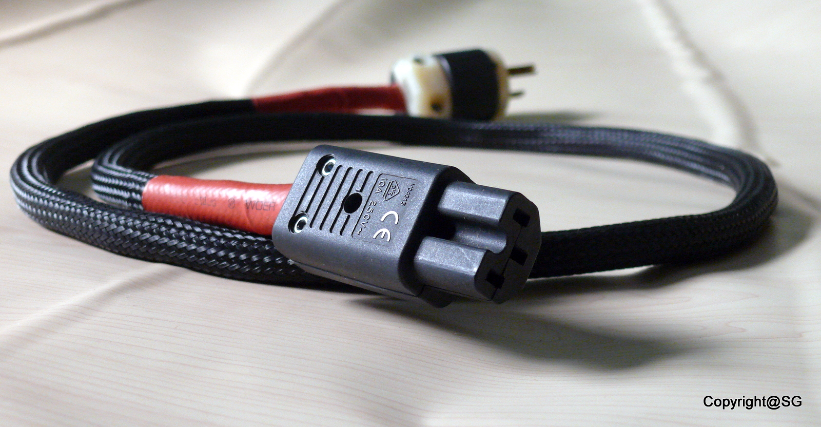

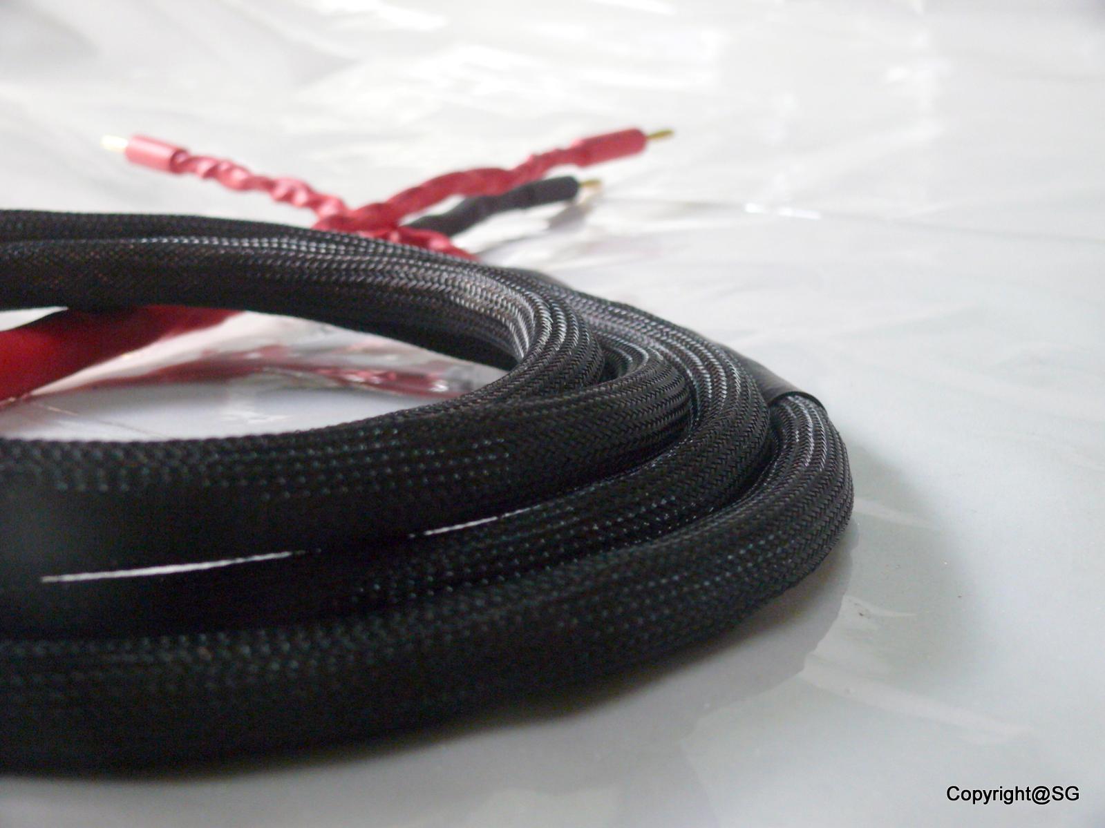

Ok Moving on,To the others who do like,Here are some of my other works.
The New Speaker Cable ( 6 X 12gauge Silver Coated Copper with Teflon)
The measurements are as follows :
L : 0.01mh ( for 3Mtrs)
C : 100nf (for 3Mtrs)
R: 0.00 (unmeasurable)

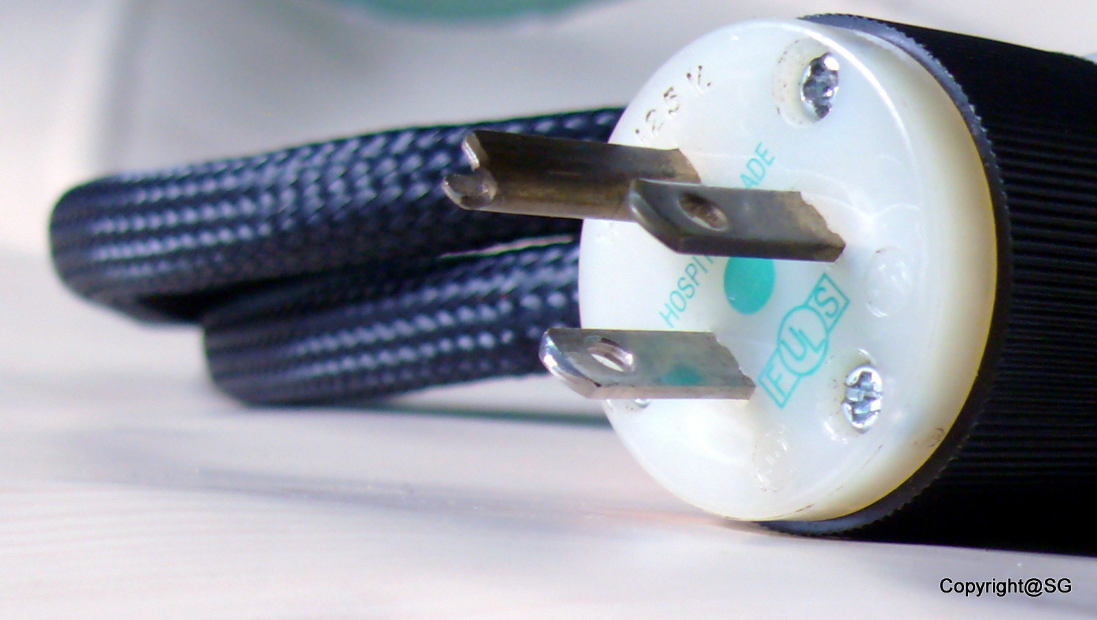

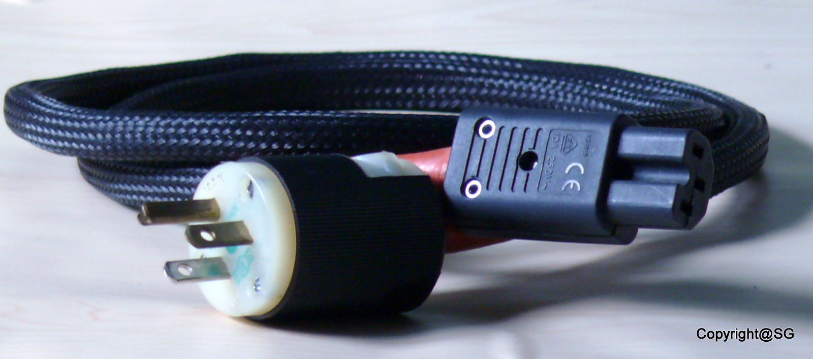

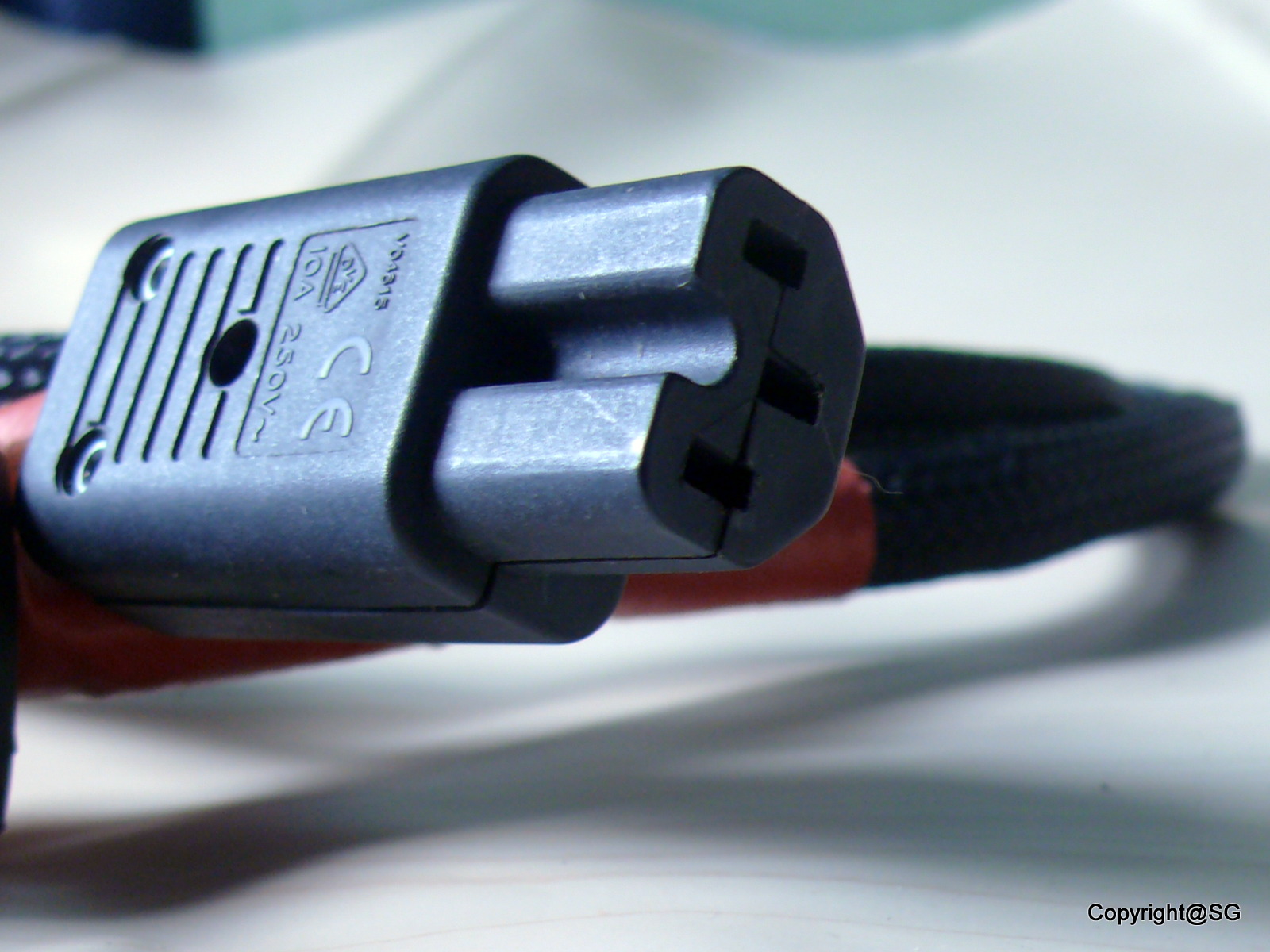

Next is the Power cable with the same configuration ( 6 X 14Gauge Silver coated Copper with Teflon)
Regards.

This thread started as a question about why/where on cable threads. Some of us explained what happens in cable threads. Thanks for demonstrating that we were right, by offering recipes and putting your hands over your ears.SoundsGreat said:Finally I never forbade anything or anyone from doing anything,I merely stated the obvious fact that if someone does not agree then this thread is perhaps not for him/her and he/she has tonnes of other thread which might have all action that they are looking for,So instead of wasting time proving what is not,Just move on to one's fav thread let everyone live happily ever after
I think this means "nobody else has tested it". That is true of most DIY items.I have tested it exclusively
I think you meant to say R not measured, or not measurable with my limited equipment. Pity, as R is by far the most important parameter for a speaker cable. Assuming you meant L in mH and C in nF, those values look wrong. 33nF per meter is very unlikely unless you have added parallel capacitors to the cable in a misguided attempt to achieve an RF characteristic impedance of around 8 ohms.The measurements are as follows :

Assuming you mean nF instead of nf; and mH instead of mh. Those values are almost certainly incorrect; either your meter is broken or you really haven't measured it.
