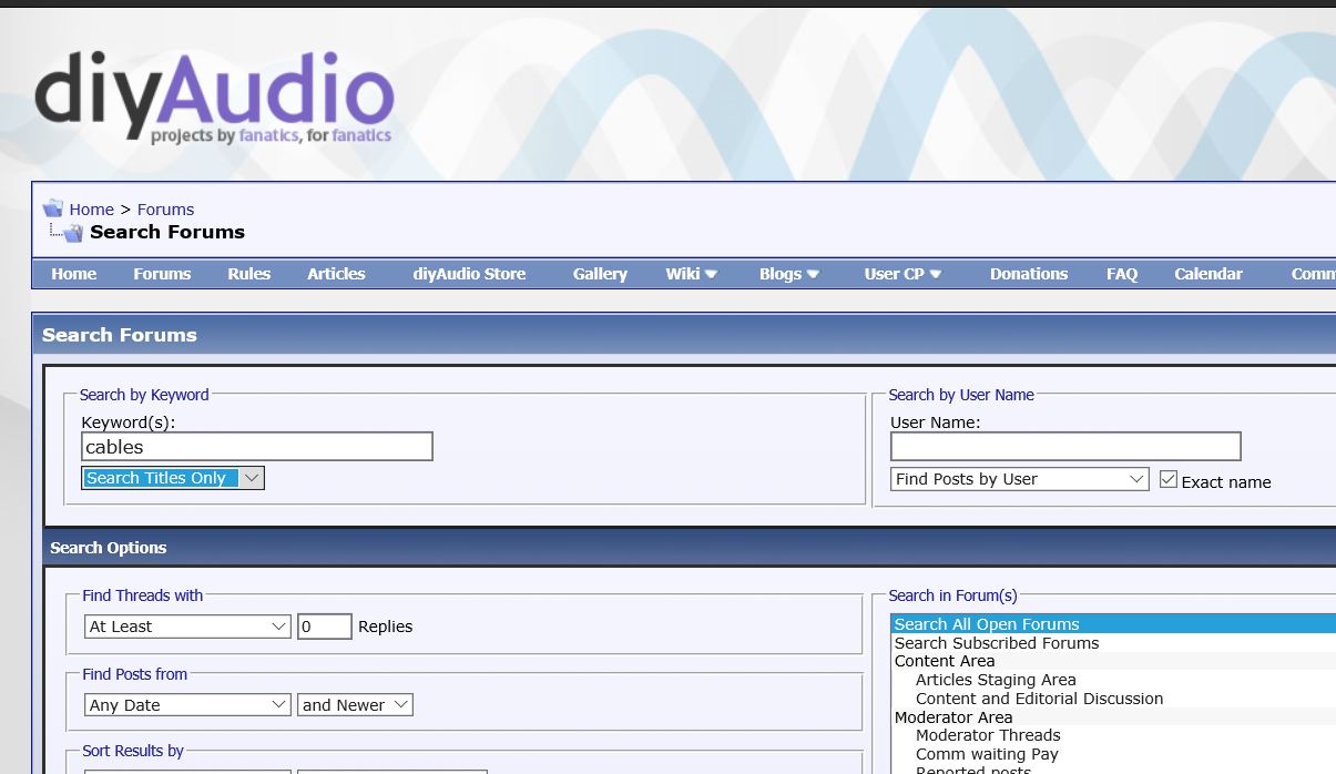

I'll tell you where and why in a minute...
Try 'search' > 'advanced search', enter cables for 'Keyword' and make sure to select 'Titles Only'. Pick the threads with most replies......
(Many such threads get closed because they become to heated and without any substance. Most engineers select cable on suitability for the job in hand... they don't have magic properties)
And welcome to diyAudio :)

Doh! I searched for "cable" (not "cables"). The singular isn't used very often, for some reason.
Thank you.
