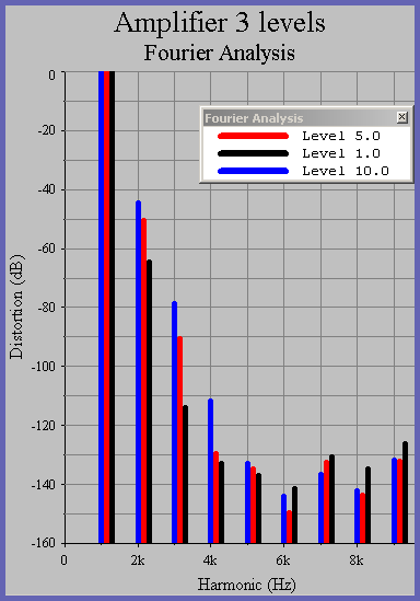

I am currently investigating, testing an amplifier project at this forum.
It has been introduced not long ago.
This amplifier shows Hiraga Pattern in fourier.
- see attachment
Same amplifier at three voltage output levels: 1, 5, 10
So blue pattern is at 10 times higher output than black pattern.
Notice:
Black patter has 3rd 50 dB lower than 2nd.
Still, at output level 10 times higher, BLUE PATTERN,
the 3rd is 35 dB down
and 4th is 32 dB further down.
You may guess this is one TUBE Amplifier 😉 Because it could very well be ....
But it is not.
If this amplifier has got Global Negative Feedback?
- Yeah, right 😎 .... it has not.

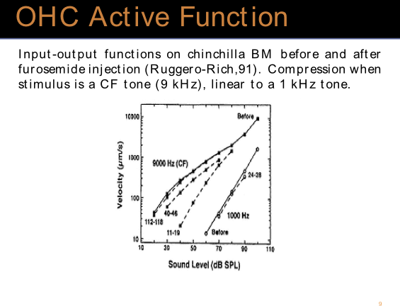

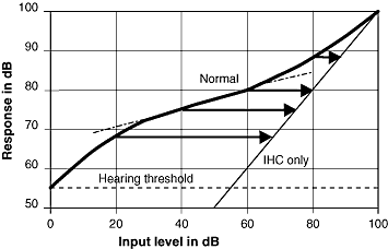

darian (if still in doubt),
cochlear compression is nature`s way to increase the sensitivity of human hearing. Due to inner hair cell insufficiency below 50-60 dB SPL, the outer hair cells perform an active amplification, whereby basilar membrane vibrations are boosted.
A wide range of input signal is compressed to smaller range through level-dependent amplification, maximum compression is 4:1, 2:1 for soft sounds, 1:1 at very loud sounds.
This function in detail appears to be almost inextricable. Don`t even think about trying to make an automatic gain control like that.
Normal=OHC+IHC
Une grosse différance, no?
Normal=OHC+IHC
