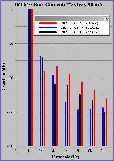

thanks for your post 🙂
Hiraga maybe, you say, suggested we would try to get a succesively decreasing of dist by order.
Would be interesting to see if he wrote about this.
Maybe the main thinking of my topic could be changed to:
Just going for minimum THD % is no guarantee for best amplifier.
Because two identical 0.1 % THD values
can be very different in the individual harmonics content.
Like I show in my IRF610 bias FFT diagram,
where the IRF610 is a buffer within feedback loop.
THD will not tell the magnitude of 3rd, 4th, 5th etc.
It is like when you will go buy green apples and apples are in bags.
There can be any number of red, yellow or green in those bags.
On each bag is told the number of apples 10, 30 apples, 60 apples.
So which one would you buy in order to get most green apples 😀 😀
There might be 10 green apples in the 10-bag but only 1 green apple in the 60-bag.
The THD % is one total quantity. Tells not about specific harmonics & details, qualities.
But what kind of low distortion?
This is where our opinions are bit different.
There is no question about we all want low distortikon.The question we would know more about, is:
What harmonics content, in detail, is desired?
If the THD is within the same range of magnitude.

- When optimizing, go for Lowest 3rd harmonics .. not THD!!
