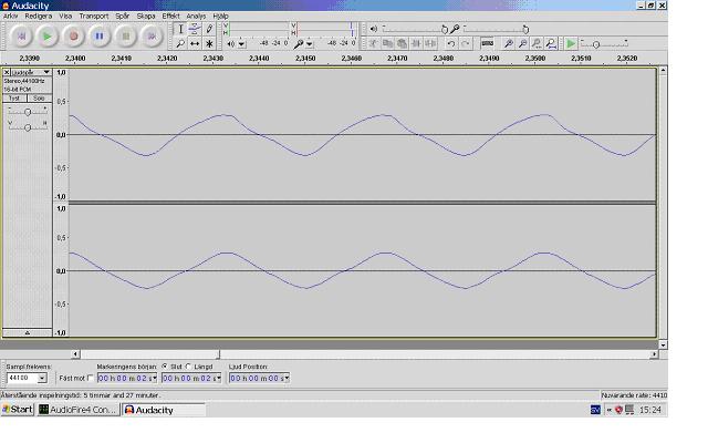

Pan said:And what I brought up with the flute above brings us right back on topic.
The note I analysed contained plenty of 3rd order harmonic but still sounded very warm and smooth.
And that makes me wonder.. is it really so that we should focus on pressing down the 3rd order and allowing more 2nd order?
To my ears it sounds better to lower the distortion and make it more symmetrical (dominantly odd order harmonics). This also results in lower IMD levels./Peter
