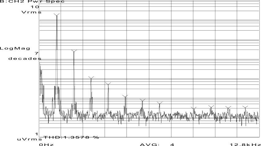

Yes, listening at pure sinewaves there is a masking effect that means a spectrum like the one you showed is tolerated much better than the same power of distortion spread out at equal level at the harmonics. Playing music will result in lots of intermodulation products though which are non-harmonic and those are not masked the way low order harmonic products are masked.
My preference is as low distortion as possible until it's not audible anymore. The distortion performance that you posted will not likely be transparent but will result in audible coloration.
That the hearing is nonlinear in many aspects does not change the things mentioned above.
/Peter

Brett said:Looking at the THD spectra posted earlier, the worst case results are 70dB or more down and the differences between them minimal. Who cares?
To my eyes it seems like the 2nd order harmonic is about -40dB and THD 1.3% or so.
That is much even for a speaker and nothing I would want in an amp.
/Peter

Nope. Look at post 27 where 2H is about -70dB. Also read the percentages.Pan said:
Lumba Ogir and I are talking about the graph/link in post 62. ;-)
/Peter
/Peter
But the thread was started re preferences about biassing based upon simulated spectra at the levels I mentioned. Irrespective of the spectra shown (of the three in that graph), you won't hear the differences between them.
- When optimizing, go for Lowest 3rd harmonics .. not THD!!
