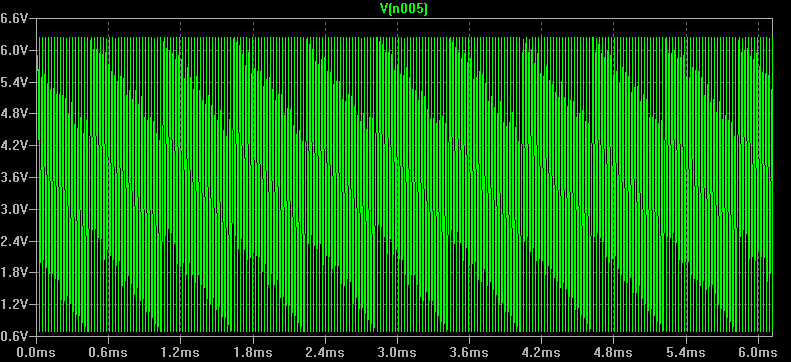

There is also this theory:
The brain might not be able to pick out the finer details after just one cycle of a waveform. But one cycle after another, perhaps the brain finally "realizes" the details of the waveform.
It has to do with aliasing such as on a computer monitor. Look at a simulation waveform such as below. You can see a reproduction of the waveform as a "heterodyne" of the original because of the aliasing.
Perhaps our brains are just like this. Sometimes our brain can't compute it all at once but if it looks at the distorted waveform and the "heterodyne" it can see much finer details than it could after only one cycle.
I believe this is what was shown in the experiment mentioned above.

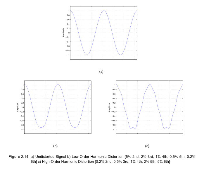

Hi everyone,
look what high-order harmonic distortion products do to the precious signal waveform. Your highly dependable software would show exactly the same THD level for (b) and (c).
Just another illustration of how worthless the THD standard is (SMPTE and CCIF not a bit better), so don`t be so delighted every time, maybe Nirvana is not reached after all.
yes. this is one of my points with this topic
your attachment shows this issue clearly.
even if such high levels of distortion is unusual these days.
And yet :D
90% of the peoples in this forum uses THD
for basic compare of amplifiers and other gears
THD, TOTAL level of distortion, can give only a small hint.
But tells not much about the sound quality
or even circuit quality. As two identical THD figures
can be so very different when looking at harmonic frequency details.
Bravo mfc, you are right.
Very, very true. I believe that in an instrument such as a piano, the correct harmonic balance gives rise to what we would call a "musical" sound having to do with mathematics. In such an instrument I don't believe it is as important how pleasant it sounds to the ear but how the notes are tied together by the harmonics. Perhaps Mozart would be able to inform us on this concept.
Anyways, although I do believe that sound and its perception can perhaps be explained completely in non-subjective terms, I know that there are things that we don't know yet about the subject and things that we won't know for a very, very long time. For now all we can do is give it the sound that "sounds best" and infuse it with our quality. If it's not done with scientific precision, then maybe it'll at least be done with quality.
