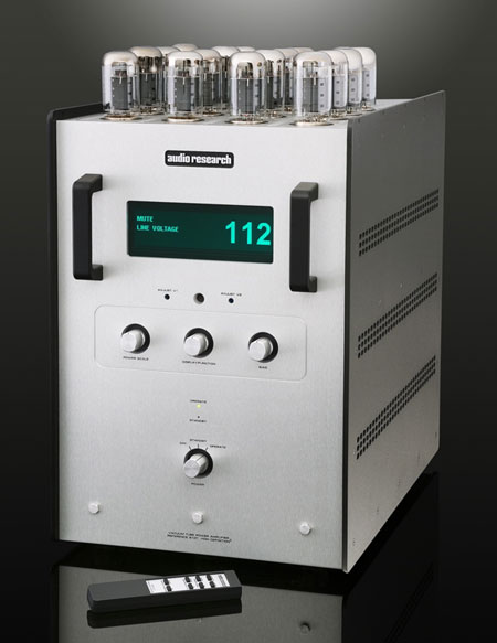

Next time you give your brother a birthday present, think about this one.
No trouble with power delivery, although there might be with power supply
costs.🙂
costs.🙂
costs.🙂
Lol, is that a tube powered mini fridge?
