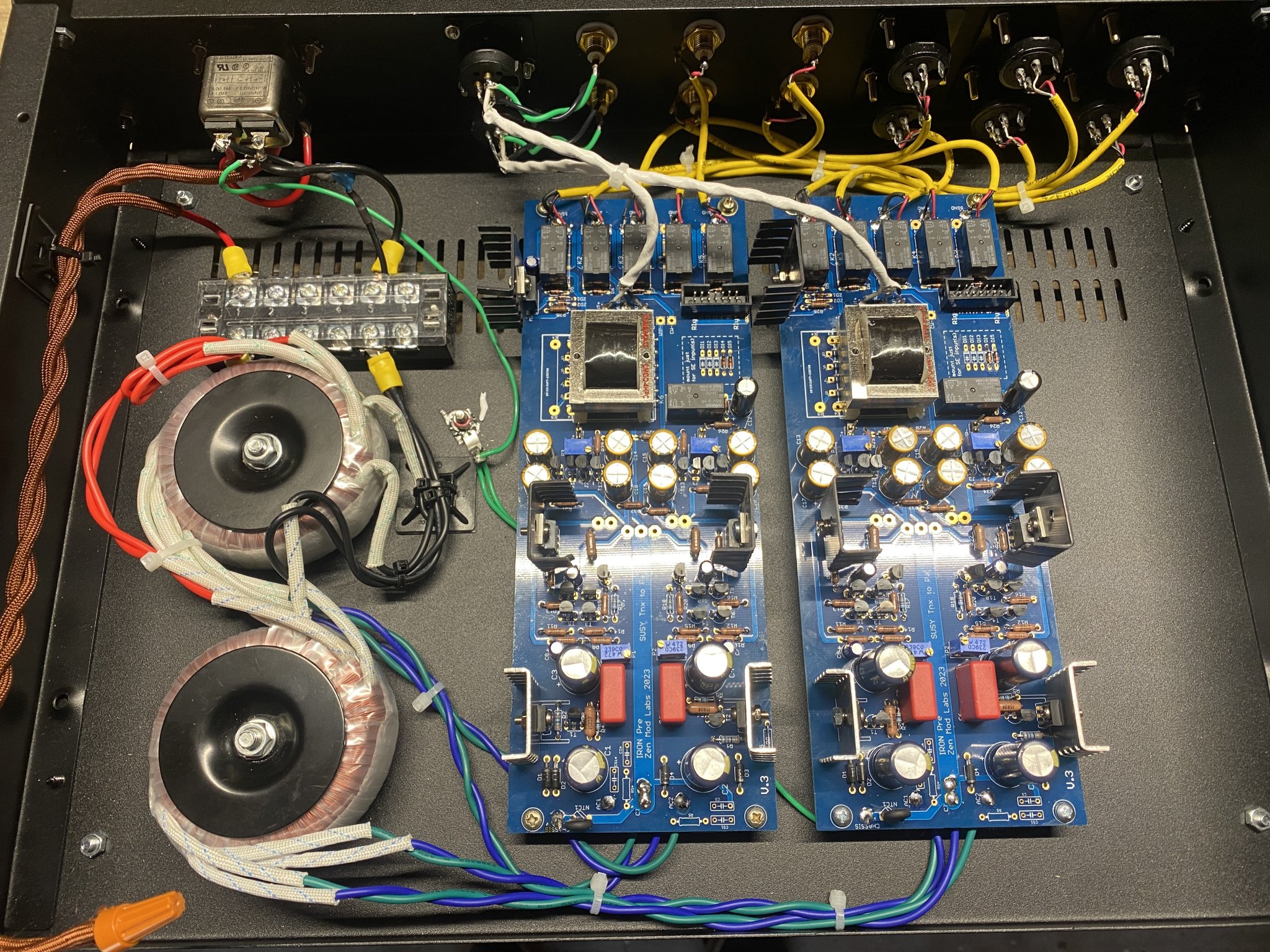

I am close to finishing my balanced Iron preamp but waiting on remaining parts, I had a couple questions to ask.
- I looked everywhere but could not find out what the purpose of JP- and JP+. I see the jumper needs to be removed during dc offset/voltage but scanning the thread everyone's builds include them connected together.
- Is everyone with balanced using 3 total fuses? One master, and one for each toroidal (channel)?

both SE and Balanced - jumpers need to stay open/removed to the moment when DC Offset of buffers is set to 0mV (as close you can get)
then you put them in place for first time
besides that, with SE, you can choose +6db or +12db gain with jumper position
simple as that
now - donut fuses - feel free to use just one, common for both of them ; value of fuse for both is so small that it'll pop whatever happens
so, one IEC, one fuse and one mains switch - no need to complicate when there is no any benefit

you didn't think of maximizing distance between mains wires & Donuts - to channel pcbs?
first most left possible, second most right possible?
it always pays off
it always pays off
Can you elaborate or recommend how I should change the layout? I tried something similar to another build I saw here.you didn't think of maximizing distance between mains wires & Donuts - to channel pcbs?
it always pays off
move Donuts all the way left, keep mains wires also left, tight twisted
move channel pcbs all the way right
I suppose volume pots are at front plate, so no worry about them situated back, with pcbs
In addition to what ZM said, I would suggest stacking the toroids if the case is tall enough, locate them at the left front so that they are far away from the audio signals and signal transformers. Also locate the AC connector block to the left side of the case. Finally, rotate the toroids for minimum noise. My experience with toroids is that they leak EMI at the wire locations, so the best orientation is with the transformer wires lined up facing the front and back of the case. That also keeps them away from the PCBs.
