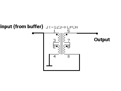

What gain figures are you aiming for?

read linked blog post and what's written here
say that 6db is sweet spot to max 12db of gain , achieved with autoformer are realistic to shoot at , everything above is stretching the concept - nonpractical and more steps back than forward
think of output impedance , square ratio of voltage ratio .......
I'll re read it one more time.
The whole output impedance and ratios is way over my head. 😕
if voltage gain is 2 (6db) then output impedance is buffer's Rout x 4 (2^2)
so , if gain is 2.81 (9db) , Rout is buffer's Rout x 7.94 (2.81^2)
Better suited to power amps with gain I see. I re read the article again and understand now the whole concept a bit better I think.

b) it really depends of several factors , but good xformer when properly fed and properly loaded , is hard to beat in signal energy preservation department.
however , there are electronic solution for that (se to bal) task , but I can vouch only for solutions where two output phases are intrinsically connected , contrary to often used OP based circuits , where existing phase is just flipped with OP and voila ...... you have both legs , but for me they're as from different persons
