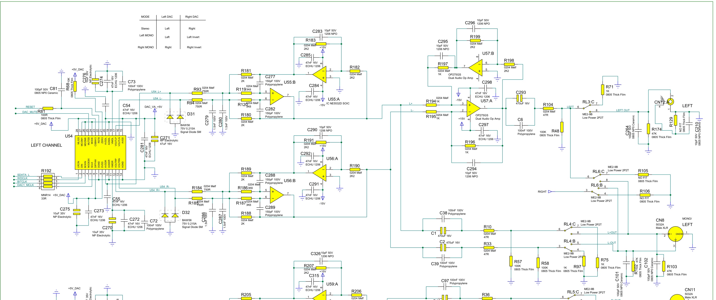

well , if implementation is "by the book" , proper differential gain stage as shown on Fig.26 of datasheet , I would certainly choose balanced operation of following gadgets

aha .... one WM per channel , I just didn't grasped that part
for my untrained eyes - I see it as two bloody SE (starting as bal , but translated to SE)
gain stages forming so called balanced output, but not real differential ...... at least not for my liking and sense
take SE signal ditto from XLR , pin2 hot , pin 1 gnd - it'll sound better than dreky RCA you already have
for me - you don't have worthy balanced source , so stay in SE realm all the way

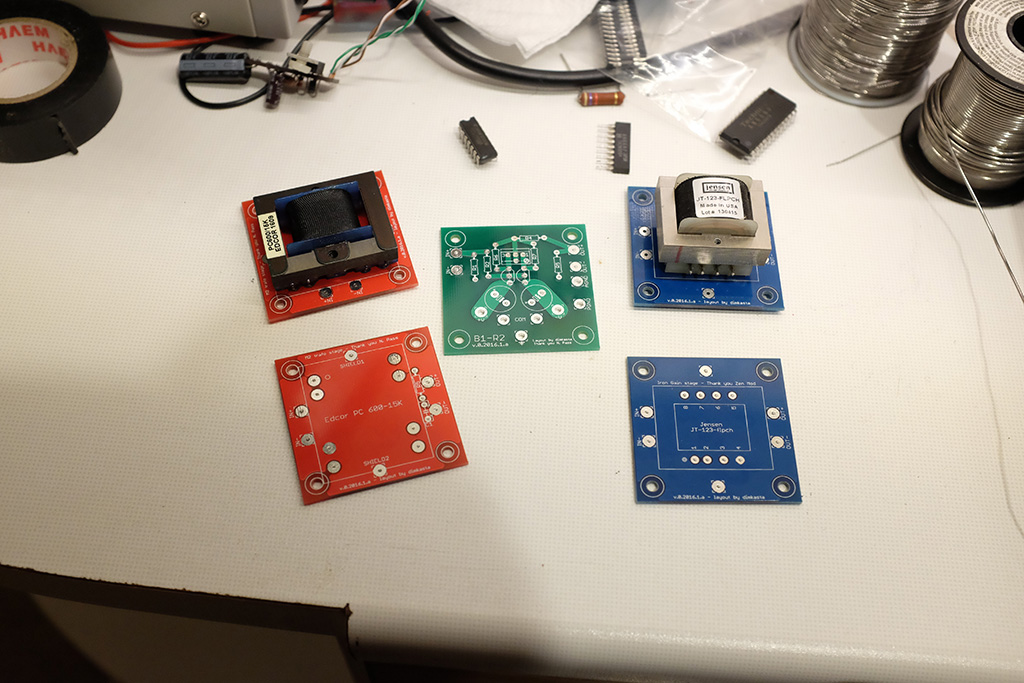

I just received a few new toys to experiment with mighty one's ideas and M2 front end.
If only I did not mess up the hole size for the Edcors... You really need the diameter suggested on the pdf to compensate for deviations from nominal pdf dimensions. Fortunately, a bit of pin bending did solve this.
Now to get some nice PSUs 🙂
