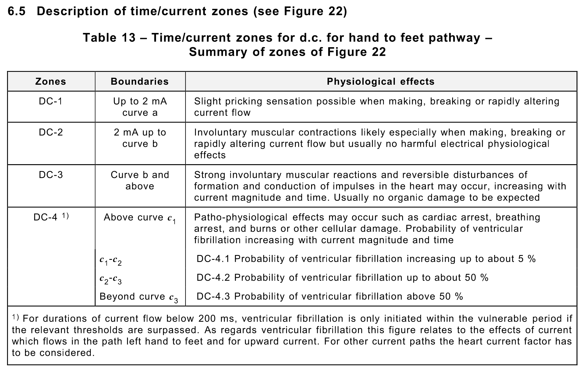

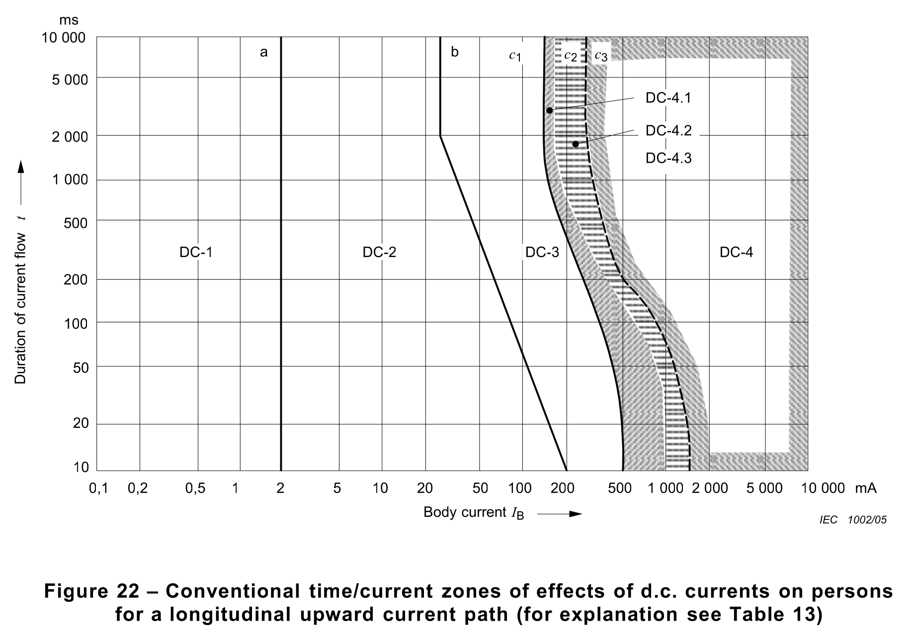

@chrisng Thanks for these links, which point out that current limits for the various physiological effects are higher for DC than for AC. The IOP paper refers to IEC TS 60479-1, which has a lot of useful information (IEC wants a lot of money for the document, but Google found me a free copy). Fig. 22 and Tab. 13 of this document provide a most useful overview of the DC effects on the human body (attached). You'll see that below approx. 130 mA, no irreversible effects or organic damage are expected. A 5.1k "safety resistor" will achieve that limit for DC voltages below 660 V (or higher if the non-zero body resistance is taken into account).

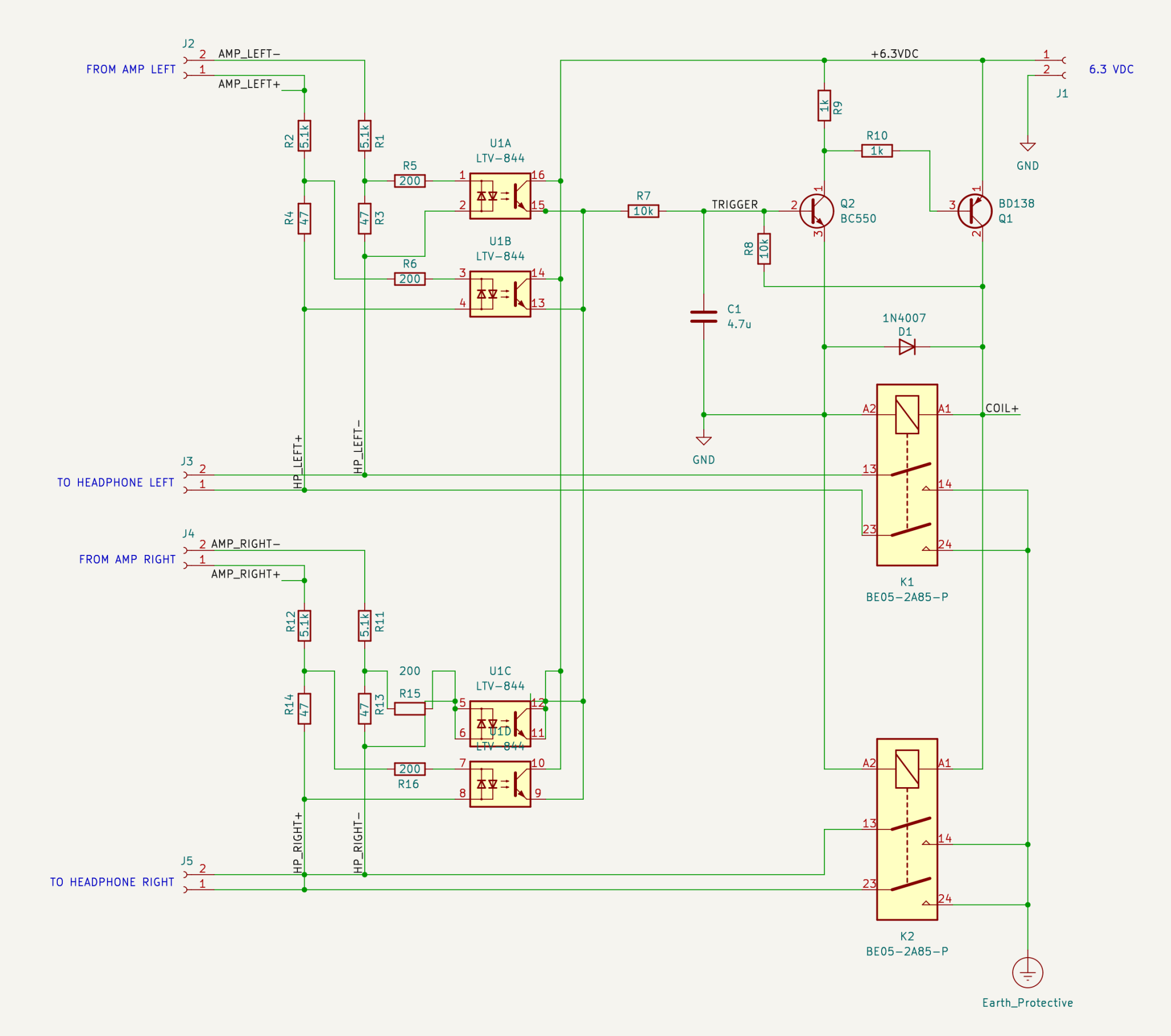

Here's a concept / idea for a possible protection circuit. I have not tested this, so it's really just an idea. Here's how the circuit in the attachment is supposed to work:
During normal operation (no fault), the left amplifier output is fed to the headphones through R1+R3 and R2+R4 (the right output works the same, so I'll just skip it here). The peak audio current into the headphones will be less than 20 mA even with very loud audio playback, so the voltage across R3 and R4 will remain < 1 V, and the LEDs in the optocouplers will remain off.
If there's a fault with the headphone shorting to ground (for example through the user), the current will be limited by the "safety resistors" R1 and R3 (5.1 kOhm each). If the peak voltage from the amp is 500 V, the peak current through R1 and R3 will always be limited to < 100 mA (yes, the power supply of the amplifier may limit the current to a lower value, but let's not rely on this). This current limiting through R1 and R3 works without any delay and provides a useful first step of protection.
Once the current to the headphones exceeds 20 mA, the voltage across R3 or R4 exceeds 1 V, and one of the LEDs of the corresponding optocoupler will turn on (each optocoupler uses two antiparallel LEDs, so the direction of the current does not matter). The optocoupler output will turn on, and C1 will be charged via R7. At the same time, C1 is also discharged to GND via R8 and the relay coils. If the fault current keeps the optocoupler on for longer than about 50 ms (time constant of R7/R8 and C1), the C1 voltage will be large enough to turn on Q2. The resulting voltage drop across R9 will turn on Q1, which activates the relays. The voltage drop across the relay coils is linked to the Base of Q2 via R8. This latches Q2, Q1 and the relay switches to the "on" stage until power is removed. Note that this latching circuit can be triggered both during normal operation of the amplifier, or if there's fault shorting the B+ or B- rails to the amplifier output. The only requirement to activate the relays is that the current to/from the headphones exceeds 20 mA for a couple of milliseconds.
With the relays activated, the headphone output is connected to Earth, which (i) diverts the fault current away from the user/listener and (ii) helps discharging the power supply before a fuse or the "safety resistors" blow up.
It would be interesting what you guys think. Would this work? Would it work well? Did I miss something? Thoughts, ideas, comments?
