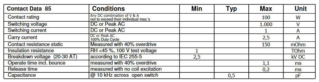

If the voltage remains at <500 V, the 5.1k "safety resistors" will limit the current to <100 mA. Looking at the AC diagram in post 54, this current value is in the AC-2 range for <50 ms, and in the AC-3 range for <500 ms. The relay switching time (1.1 ms) is much faster than this. The time limit needs to be configured to the desired value by adjusting the time constant of the RC low pass (R7/R8 and C1 as described in post 79).
Contacts are on a 2.54mm raster, how many mm actual creepage distance do you expect?
And how much distance is needed to call it safe?
I would look at 230Vac creepage distances that are considered safe, instead of considering an adverticed 1kV MAX! rating as safe.

According to https://cirris.com/high-voltage-arc-gap-calculator
Max. arc distance is 0.05 mm for 500 V, or 0.15 mm for 1000 V
The relay is specified for use at up to 1 kV in the datasheet. The distance of the external relay pins is 3.6 mm. That's more than 50x more than the arc distance at 500 V. I may be on the wrong track, but I don't see why this relay would not be safe to use at this voltage.

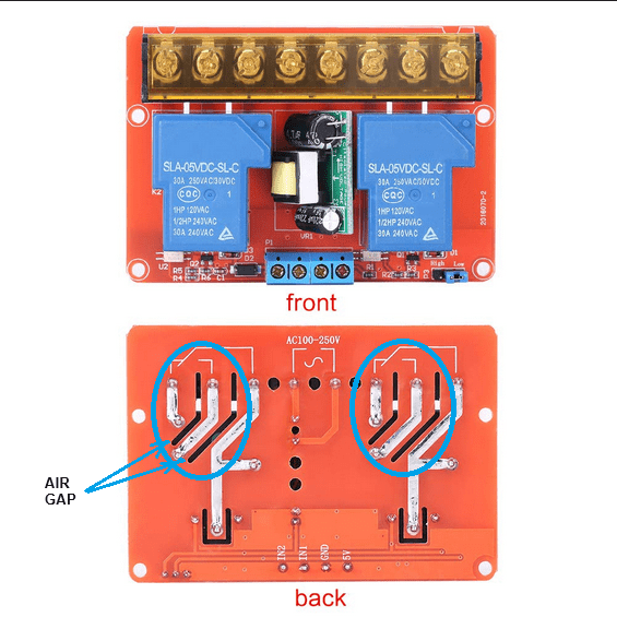

One could distribute the traces to both sides of the PCB to improve insulation.
Yes, pcb traces can be dealt with, but you have still to solder the relay pin to the board.

Sure, slits (airgaps) are a very good idea, if they are easy to implement, as in massproduction.
For a diy-pcb, putting the solderpads off center, and maybe drilling a hole in between, could work to get 3mm creepage between the relay terminations.

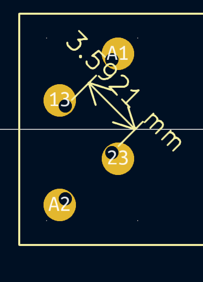

Ok, so you'd recommend 3 mm of space between the solder pads for 500 V. Correct?
According to IPC2221B up to 500V 1.5mm, A6 = uncovered external component lead/terminations
Above 500V 0,0035mm/V, but that would be 3,5mm for 1kV.
So i recommend the max you can practically get with those relays, something around 3mm, yes.
Between uncovered traces IPC2221B up to 500V 2.5mm, B2 = uncovered traces
Above 500V 0,005mm/V, so 5mm for 1kV

How about this (pins 13 and 23 are the relay contacts to the bipolar amplifier outputs, A1 and A2 are the relay coil):
