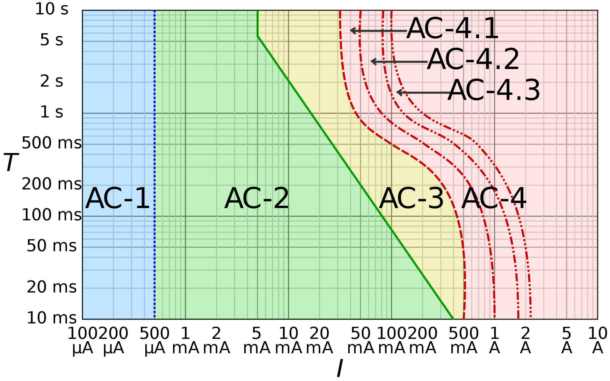

Using a transformer or capacitor in the amplifier output was mentioned as a safe method to isolate the user from a high-voltage fault at the amplifier output. A current flow of 10 ms would correspond to a lower cut-off frequency of 100 Hz for the capacitor or transformer. That can't be right.at least be some 10msec - too long for a secure interrupter.
Is there any data out there related to the (safety-)effects of the duration of current flow?
There will be some kind of inverse correlation between critical pulse amplitude and pulse duration.

In hospital TV series they always set the energy of the defibrillator to some value specified by the doctor when they try to reanimate someone, so chances are that it is something proportional to I2t that matters for short shocks.
There is a graph about shock currents and durations in https://en.m.wikipedia.org/wiki/Residual-current_device

That IEC reference is quite useful! I attached the diagram to this post. Looking up the Wikipedia reference and translating the Chinese description, I got the following:
IEC 60479-1 specifies the four zones of current-time relationships and describes the pathological physiological effects on the human body within each zone, as shown in Figure 1. The horizontal axis represents the current through the human body, and the vertical axis represents the duration of the current. The meaning of each zone is as follows: AC-1 zone indicates no perception; AC-2 zone indicates perception; AC-3 zone indicates reversible muscular contractions; AC-4 zone indicates possible irreversible effects; AC-4-1 zone indicates up to 5% probability of ventricular fibrillation; AC-4-2 zone indicates up to 50% probability of ventricular fibrillation; AC-4-3 zone indicates more than 50% probability of ventricular fibrillation. ... For example, if the current through the human body exceeds 30 mA, the person is likely to be electrocuted unless the current can be cut off within a very short time.
In other words: according to the IEC 60479-1 diagram, anything longer than 5 s should remain below 5 mA to prevent irreversible effects, and below 30 mA to prevent electrocution. For shorter pulses, the current limits are a bit higher according to the diagram.
5 mA or 30 mA does not see like much, but it's actually just within the needs for electrostatic headphones. My own measurements suggest that about 4 mA peak is enough for very loud music playback (see https://www.diyaudio.com/community/threads/open-source-dht-estat-headphone-amp-osdeha.407679 ). Also, due to the capacitive impedance of estats, the current peaks will appear with high-frequency signals, which should be easy to distinguish from DC.
Don't you mean below 5 mA to prevent reversible effects?
