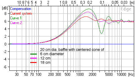

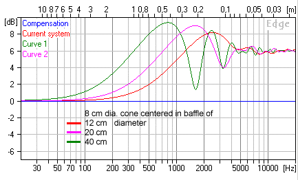

Getting back to those graphs that JIKO posted. Is it just me, or does the chamfer look better than the radius?

Either keep the baffle as narrow as possible or make the driver as large as possible.
bigger baffle does appear to be much worse
but are you forgetting that diffraction problems also moves down in frequency
I guess its only natural it looks smaller at higher frequencies
but could still be worse, no ? 😕
I don't argue for smaller or wider baffles, but for keeping the distance between driver edge and baffle edge small. If you need a wide baffle for some reason - just do it. But don't put a small driver on it.

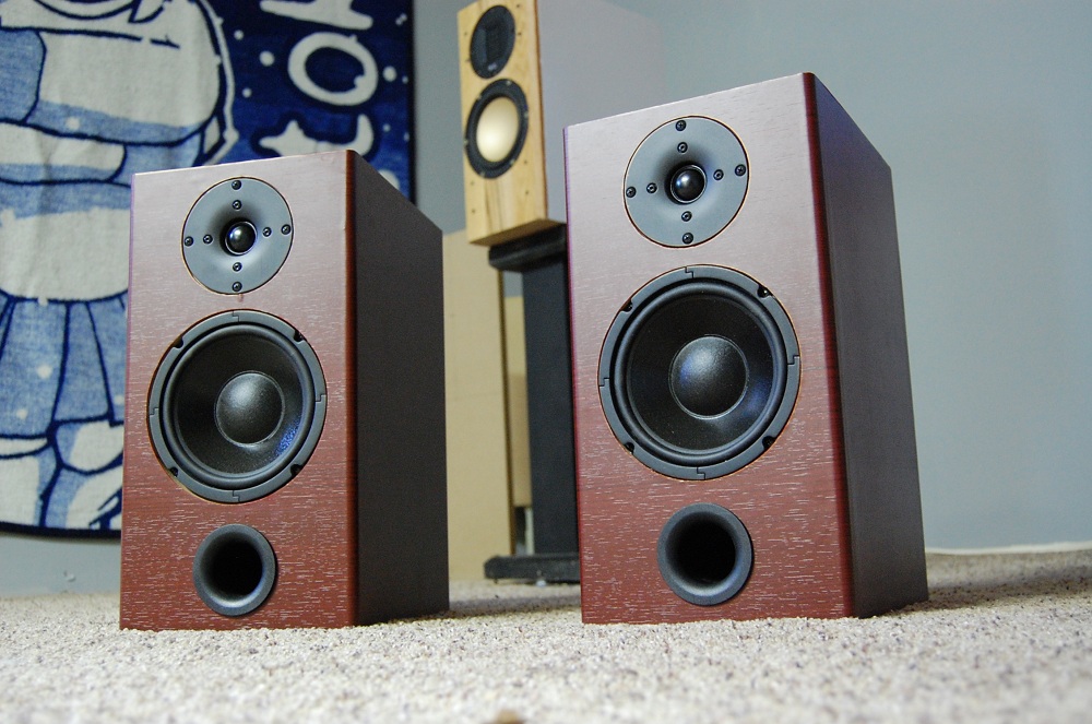

It would actually be easier to veneer. Just wrap it around and put the seam in the back.
That's exactly how I did these ones.
- What's with the sharp edges on speaker boxes these days?
