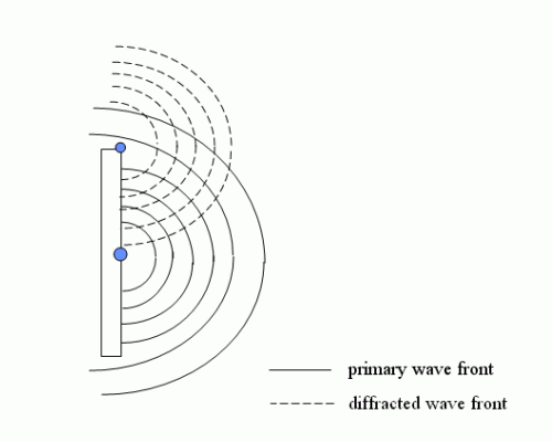

I think there might be 2 distinctly different phenomena occurring - the one Olson studied and this one.
(the faint circular radiation from the edge)
Joined 2009
I don't know what the picture is of exactly, it may not even be sound.
I am just using it to illustrate my point.

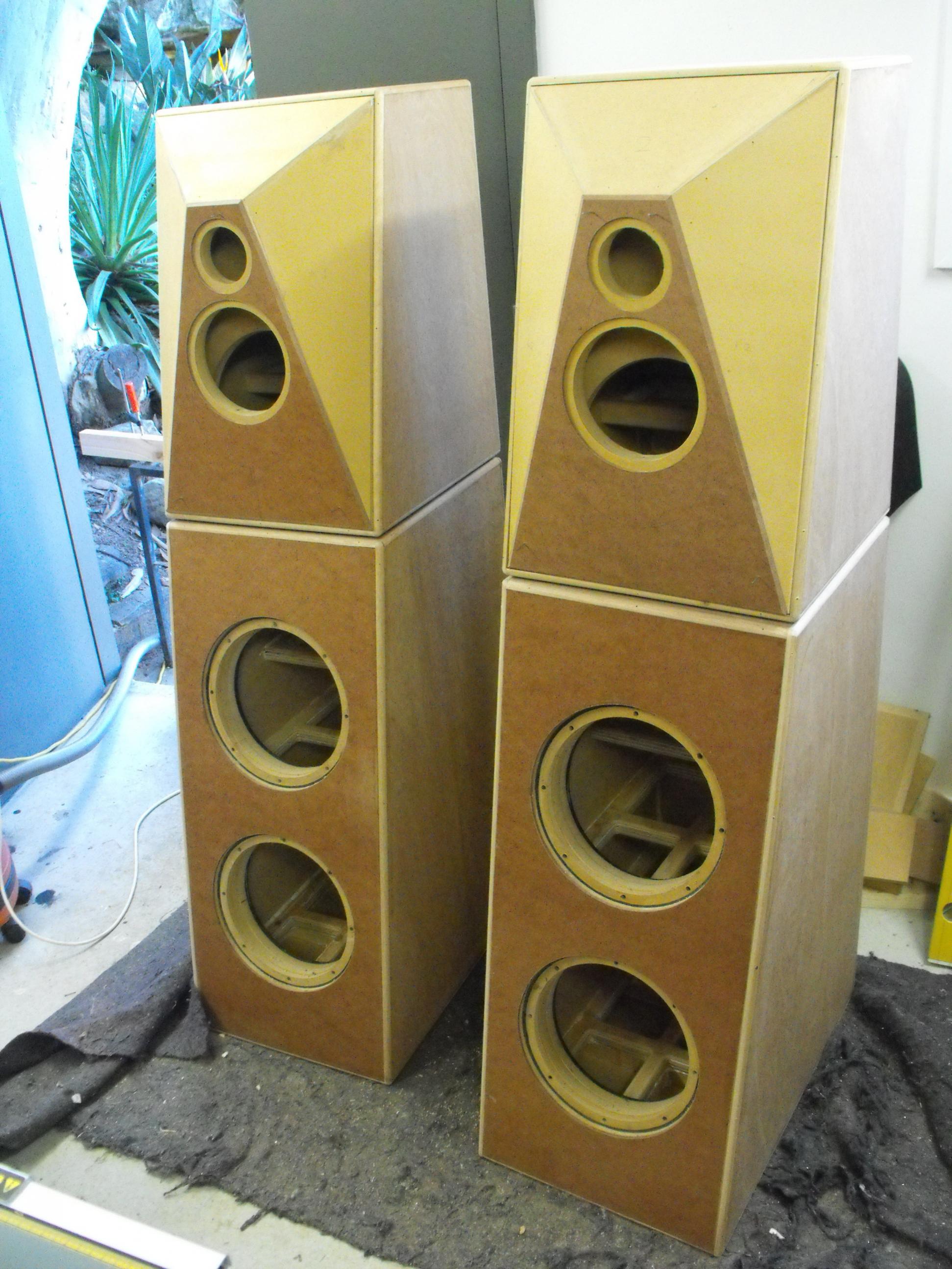

Which gets me to thinking…. Take a typical / popular speaker design where the baffle starts to rolls off at the tweeter and gets shallower as it gets to the mid etc. (only using this picture because I have seen it recently, not picking on this build)
This would be seemingly backwards based on the information above…
