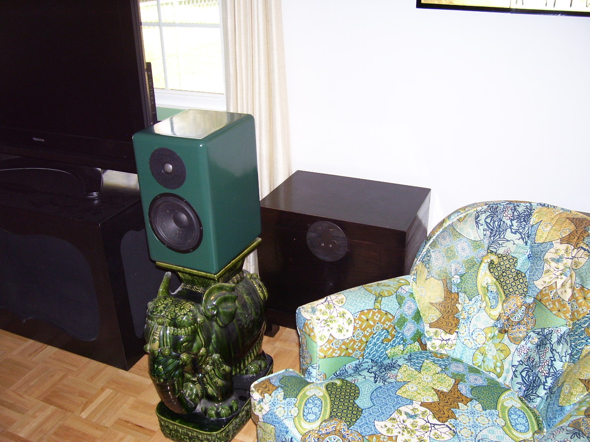

It may be of interest to remember the cabinets from the Good Dr. Earl are a bit larger than the max half cubic foot I build ( which is why I have not tried a pair of his, sure would love to). I found the difference quite dramatic. In case you missed it, a high quality painted finish is very hard and expensive.
I have an idea I may sketch up on how to do a low diffraction cabinet with two simple curved surfaces, so it would be possible to use a veneer finish.
I totally agree with the comments that the simple simulations and even simple measurements don't explain everything. They are only a starting point. They are a place to start "final voicing", which I do by listening. When Join Mitchel sounds natural, you got the mid-range balance right. What I can't explain, is what is making the nylon strings on Julian Bream's guitar sound metallic with some combination of less than perfect speaker and very wide bandwidth amps.
Attached is my best speaker to date sitting in front of one of my very stealthy subs. The speaker stand may be less that optimal, but has very high WAF.
