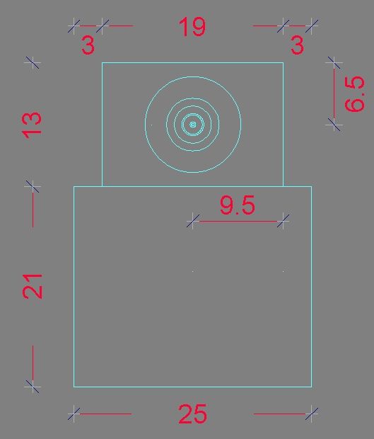

OK ... it is what it is but it would be nice to know what it was before you start chopping the box 😉No I never measure...I know, I did this in a wrong way...I should first measure then build...but then I would not build anything 😀 ... Now I have build, I like the results...think it have potentials 😀
The drivers are 2904/7000 , 18W8545, 21W8555...
The 2904/7000 have some dip in that area, but it's like -1db and I have like -5db...As I don't have experience, I don't know how bad it is...I see some graphs from other loudspeakers and most of them have those dips...
Well I have to put my PC back together as without it's hard to make any progress 😉
This is dinemsions of front buffle, for 2904/7000 and 18W8545...
Maybe after you have your ducks all lined up (individual responses measured) you could start a thread about it and work from there.
will do 😀
thanks

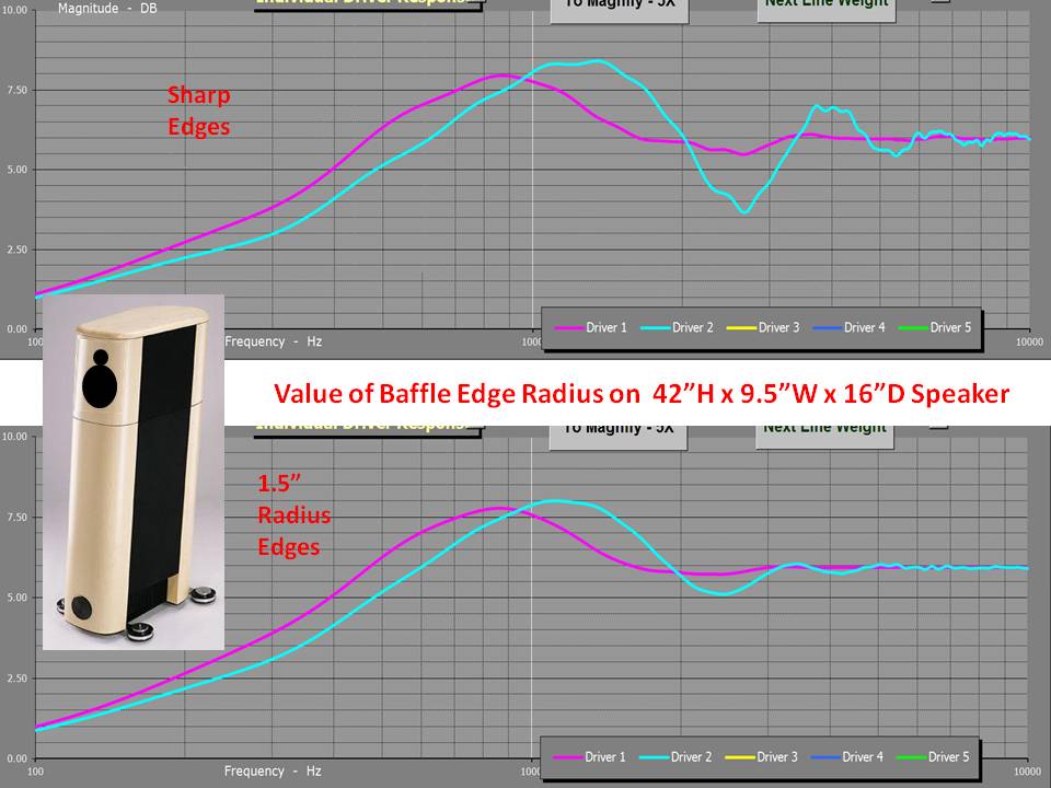

Narrow speakers often accept sharp edges, both for style and for minimal width.
One thread discussed a narrow 3-way speaker using side-side counter-force 8" woofers. A simple simulation was done which illustrated significant SPL smoothing from using a 1.5" edge radius.
Naturally, the box width had to increase to accomodate a 1.5" edge radius. The proposal was to use this width to provide soundstage advantage by mounting a 6.5" midbass like the Satori MW16P which covered a wider bandwidth with a Xover under 100Hz, instead of the 5" midrange used in a popular product.
