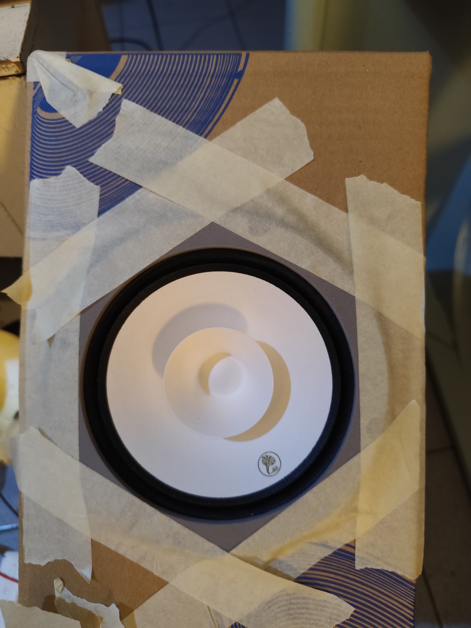

I got the drivers today. Hooked them up for burn in and wasn't disappointed. After two hours the sound already is getting more full and all round better. Did a quick distortion measurement and I couldn't believe how clean this driver is. Will have to repeat at louder volume when fully burnt in but so far I am really impressed.I'll post some impressions here after I get the drivers.
The motor and cone look great....only the stamped steel basket is rather flimsy. If I tap it with my knuckles I can hear it ring. I will epoxy on some reinforcement and stick on a damping layer. But I don't regret buying this driver and for 80$ a pair it is a great value.
After mounting the Lii Audio Chrystal 6 driver in a 30L cardboard box and adding a super tweeter this driver sounds very very good.

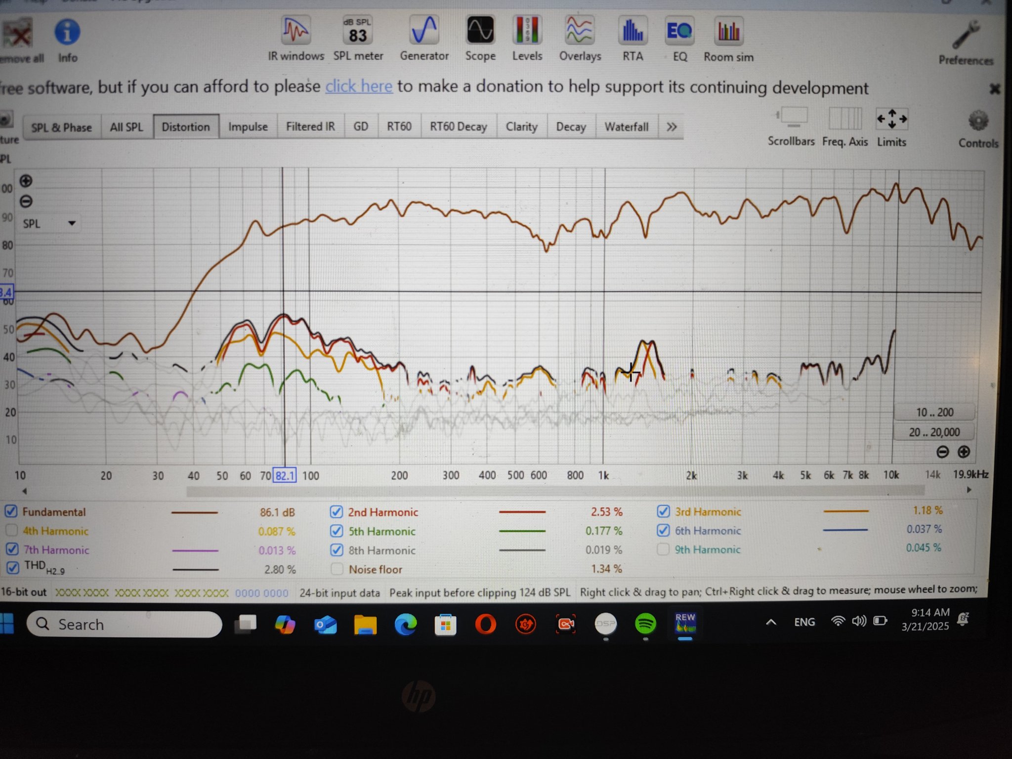

I did a distortion measurement with 100db@1m with a 6db high pass at 200hz and there are only 2 distortion peaks of around 1.5%....almost entirely 2nd order though. Odd number distortion is almost entirely absent. I am impressed.
Above 10k there is very narrowing dispersion so I do recommend a super tweeter to support the top octave.

Are you suggesting modifying the driver? I would be terrified of butchering the driver with such an invasive procedure...I have yet to hear a wizzer cone driver that did not benefit from a phase plug. Especially helping in the top end.

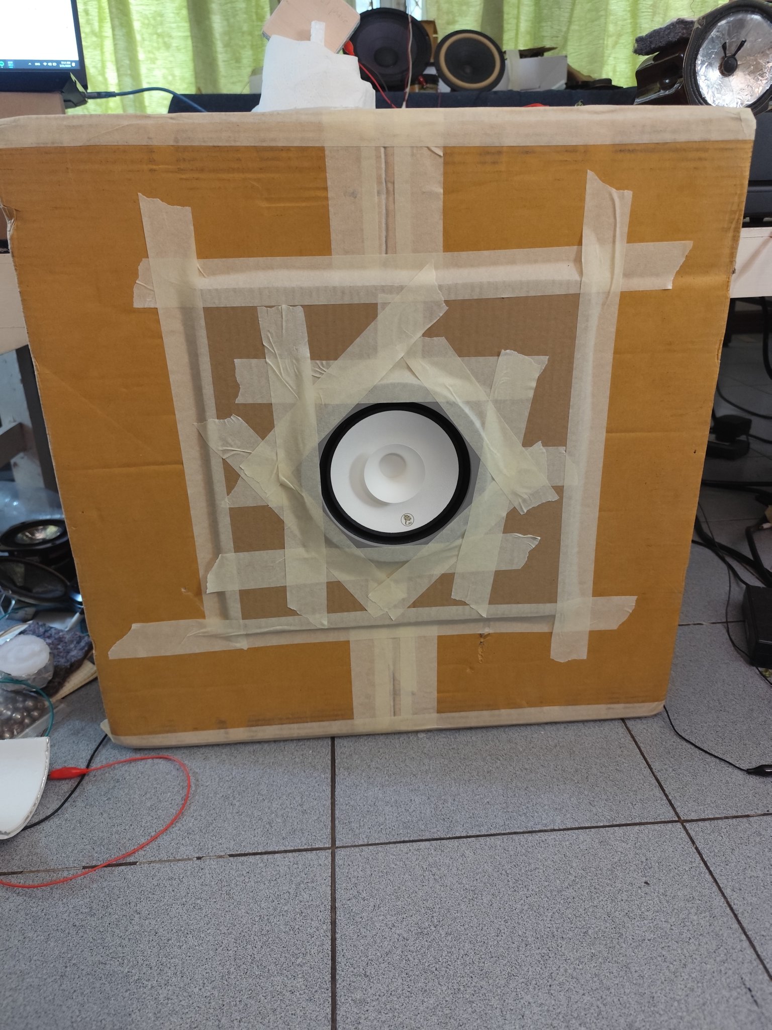

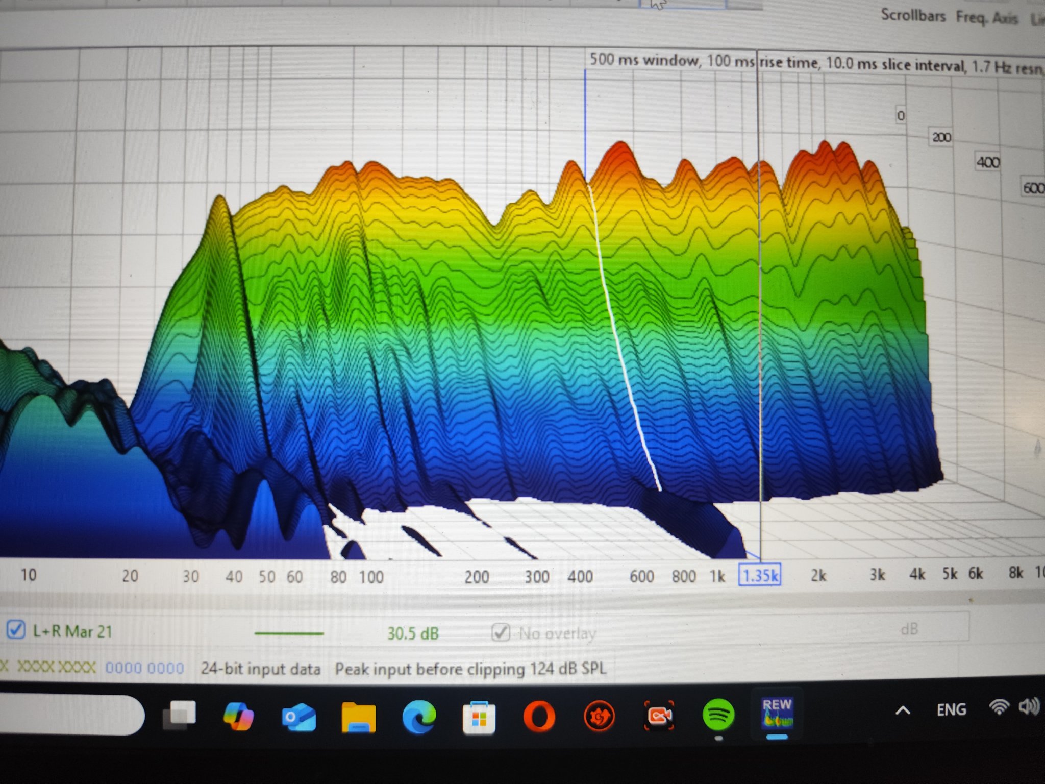

I slapped a Lii audio crystal 6 in a 65L cardboard box with a 8.5cm diameter reflex hole. Here is a quick measurement that is doublessly polluted by vibrations and leaks so it should look better when in a proper enclosure.
I guess I measured from a meter away about 15deg off axis. On axis the HF dropoff is less.

Way back when, manufacturers, DIYers used piano wire to suspend phase plugs, tweeters in front of them.Are you suggesting modifying the driver? I would be terrified of butchering the driver with such an invasive procedure...
It crossed my mind to do something like that with maybe a golf ball..... Interesting idea.Way back when, manufacturers, DIYers used piano wire to suspend phase plugs, tweeters in front of them.
Based on what we now know about golf ball aerodynamics, might well be a better choice than smooth, though some form of tapered is currently best AFAIK.
After a few days I think the crystal 6 drivers are 90% broken in. I must say I am very impressed. They are very detailed, balanced, low distortion and non fatiguing.
As I mentioned before they do need super tweeters. I intend to put these drivers in a Hartley Boffle. I am now.working on a home made super tweeter >12khz and a large 175L experimental DML bass box vibrated by bass shakers. The experimental bass box is meant to support the lowest octaves.
Lots of experimentation prototyping ahead. If it results in something good I'll make a build thread.
