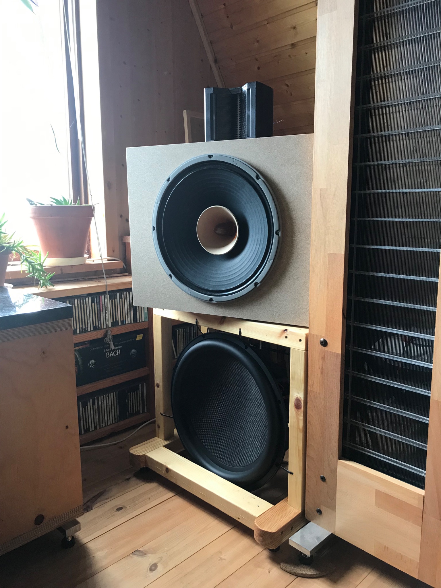

Yes. I ran them for about 8 months in a small test baffle, first without wings, then with 6" added wings in the back. Without any filtering other than the treble and bass controls on the Node streamer I was using. Sounded good enough off axis that I was in no hurry to finish up the more permanent baffles that I am building. I did find with the temporary baffles that in my room, the usual barrel baffle that you see used with most of these, would of placed the sound field too low.Hi @johnvb

At one time I thought the drivers were malfunctioning, the coils would rub every now and again (even with no filtering). Had me worried in that I knew these weren't going to be shipped back to China (I live on the East coast of the USA), too much trouble. Once I took the subsonics out of the signal to them, that went away. I feel the top end is lacking also, so the finished product I am building will be a FAST setup, with the Fast -15 as a mid bass, one or two Eminence Beta 15s for the bass, and a Heil AMT on top. The crossover point from the Lii to the Heils are yet to be determined. Using a MiniDSP SHD Studio and separate DACs / amps to control. These speakers are in a 12' x 15' room, for a single seated listening spot, with lots of QRDs and poly diffusion on the front wall.
Speakers I had in this room before, were highly modified Magnepan MMGs, and then KEF LS50s (the latter which are now in another system).
Nice... I orginally was going for a taller baffle with a built in Heil:
https://imagizer.imageshack.com/img923/2843/C4biqs.jpg
Now chopped it down so that the Heil can sit on top of the baffle like yours:
https://imagizer.imageshack.com/img922/8924/W1QSkS.jpg

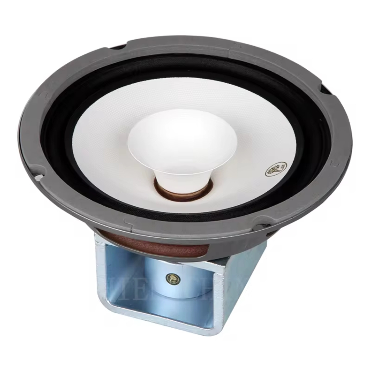

I’ve just purchased a pair of the most recent Fast-15 without the whizzer cone. They are from Taobao. I bought them locally for an excellent price so I figured I’ll see what Lii Audio is all about.
I just ordered a pair of Chrystal 6 alnico drivers from AliExpress. Been eyeing them for months and had a weak moment yesterday.Lii Song that is sold outside is an other guy, who once tried to set up an export for the original (but that guy was not really interested) so he started to copy the original for outside china. That is what you buy here. The few i had in my hands a few years ago where far of spec and not very usable. But they have a cult following it seems. I would never use them. If you want the originals, you will have to go to china and find that original Lii guy.
These are not Lii Song but Lii Audio, the ones with the flower logo on the cone. I guess that is the original then? That wasn't the reason I bought them though. I really like the t/s parameters. They even claim to use silver VC wire....and the impedance graph looks amazing (if real 😆) planning to cross them around 400 or 500hz first order to a woofer.

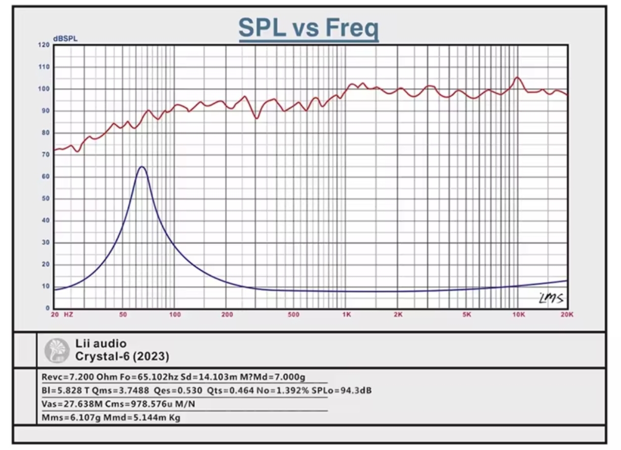

Revc=7.200 Ohm
Fo=65.102hz
Sd=14.103m
BI=5.828T
Qms=3.7488
Qes=0.530
Qts=0.464
No=1.392%
SPLo=94.3dB
Vas=27.638M
Cms=978.576u M/N
Mms=6.107g
Mmd=5.144g

Near enough...........Do they appear to add up correctly?
Revc=7.200 Ohm
Fo=65.102hz
Sd=14.103m
BI=5.828T
Qms=3.7488
Qes=0.530
Qts=0.464
No=1.392%
SPLo=94.3dB
Vas=27.638M
Cms=978.576u M/N
Mms=6.107g
Mmd=5.144g
n0 = (9.7822 * 10^-10 * 27.638 * 65.102^3) / 0.53 = 0.01394 = 1.394%
SPL @ 1W/1m = 112.2 + 10 * log(0.01394) = 93.64 dB
