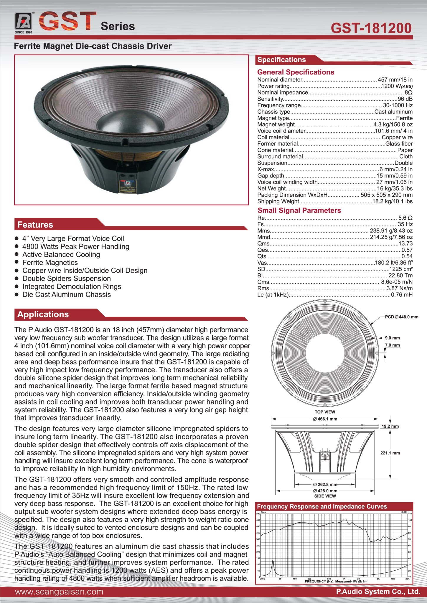

I keep finding better options locally. The GIP GPA driver I found earlier has a very high voice coil inductance. P Audio is also Thai but has a reasonable reputation abroad. I found this driver (GST-181200) that seems a bit more refined and am considering using 4 of them per side in Ripole configuration. That should be enough bass for a large room I guess.
X max is only 6mm but with a total of eight 18 inchers that still is significant displacement. Moving the speakers will be a b*tch though.

Found a 9mm xmax version of the same driver. I guess two per side in Ripole configuration should suffice.X max is only 6mm but with a total of eight 18 inchers that still is significant displacement. Moving the speakers will be a b*tch though.
http://p-audio.co.uk/products/P-Aud...ch_1500W_Low_Frequency_Loudspeaker_Driver.php

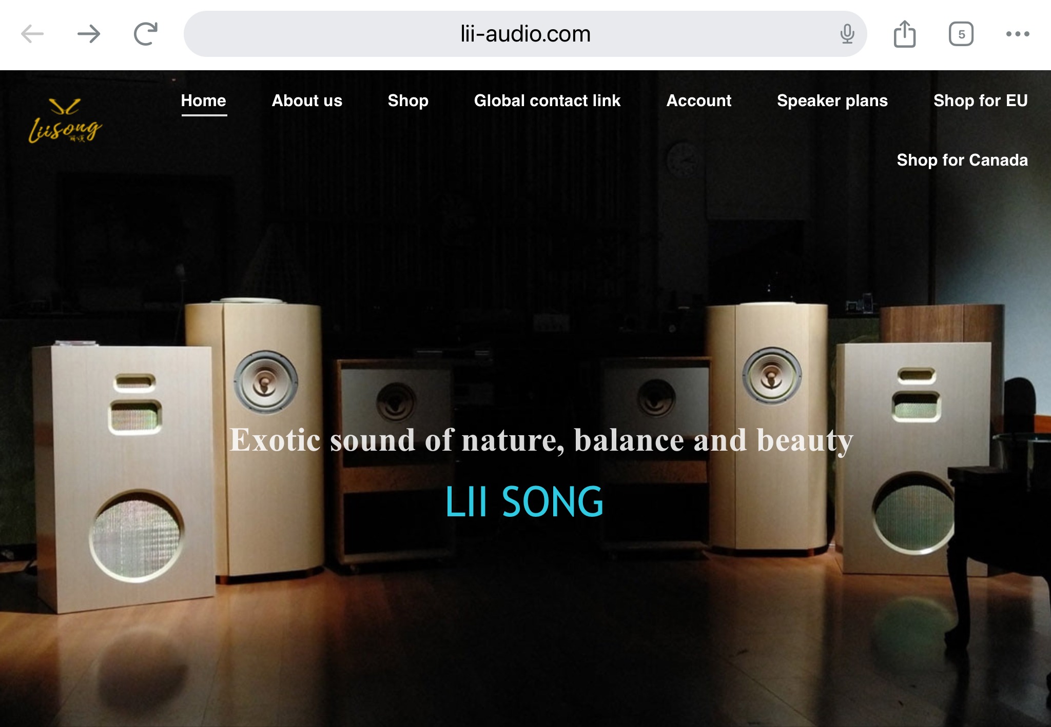

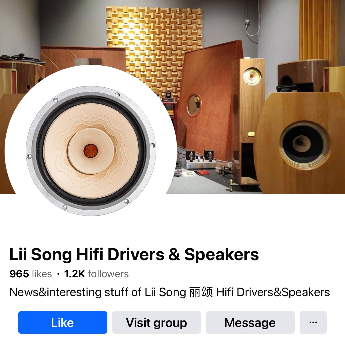

So I take it then that this is the real Lii
Web page & FB page with the link to their web page.
https://www.lii-audio.com
As opposed to anything else.
Isn't that just saying that Liii Song, the company, and its associated website (lii-audio.com) were both founded concurrently in 2016?

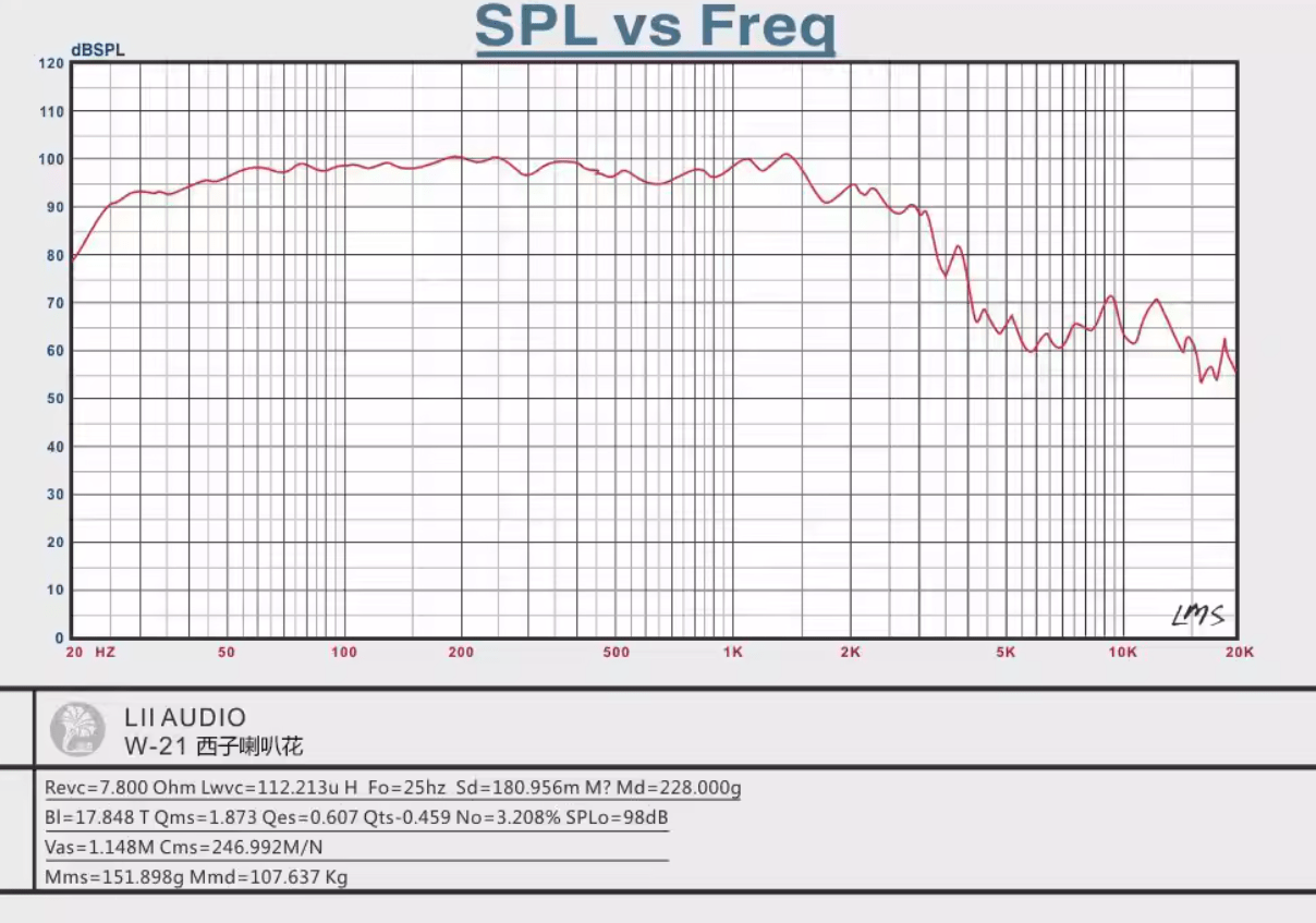

I am not saying 100% sure but seems Lii Audio use decimeter instead of cm for the unites means 1800 cm square for the woofer. I use the chinese website.Well, I for one would be interested to know how it's possible to have a 21in woofer with an Sd of 384cm2.😉
As usual with Lii units (whatever nominal company or otherwise), the spec., on the occasions it is consistent with itself, doesn't actually make any sense whatsoever.
Lii Audio Xizi Trumpet Glory W-21(21"HIFI WOOFER Speaker)
Technical Parameters
Resonate Frequency fs:25hz
Frequency Range:25-3khz
Sensitivity (1w/1m) :98dB
Nominal lmpedance:8Ω
Rated Power:200w
Shortterm Maximum Power:800w
Total Quality Factor ,Qts:0.46
Voice Coil Diameter: 100mm
Magnet Diameter: 220mm
Magneric:Ceramic Y38
Equivalen Air Volume to Cms,Vas:1148L
Mechanical Quality Factor,Qms:1.873
Nominal Diameter:542mm
Net Weight:25kg
Grade: 2
A 6.5 inch driver is rated sd13.260 so would make sense to be 132 cm square.
If that were the case, then a/ not for the first time, it seems like they're putting out different data sets for the same driver, b/ in the first instance it would be an Sd of 3,840cm2, which is ridiculous for a 21in woofer (their data sheet, nobody else's), and c/ 1,800cm2 is itself a bit of a stretch for a driver of that category these days, with most falling < 1,700cm2. Nobody else is Peter Perfection either, and I'm not suggesting they are, but there does seem to be some significant issues with the published data on these units.I am not saying 100% sure but seems Lii Audio use decimeter instead of cm for the unites means 1800 cm square for the woofer. I use the chinese website.
