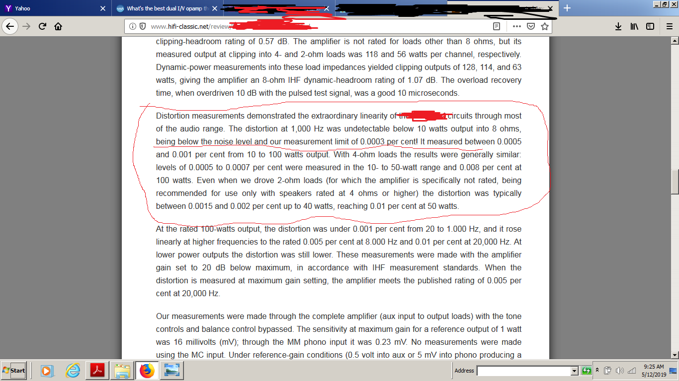

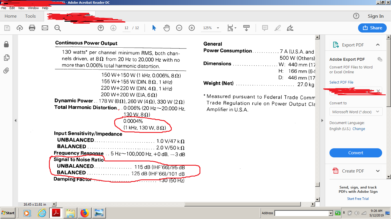

I highly doubt that your ears can make a difference btw 0.0001thd and 0.005% thd at 1khz , not 20khz, yet 30...40 years ago some amps would beat the -120db thd under 10 w/8ohm.You have only 2 examples measured before system 2 was available:
They can't even 0.1% , did you guys measure your whole system THD at 2meters? at 100 db? it is probably very high in high order THD of all kinds....
and it doesn't stops there, phase delay, IMD, and of course resonances and standing waves + room modes, floor bounce, nuls, etc.
