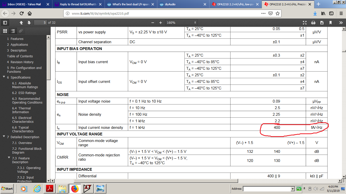

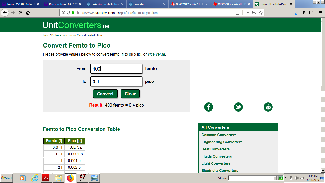

I thought that my "vastly" improved math knowledge was at peril so I used an online calculator to see if 400FA is the same with 04PA...still i can't see why the "vastly improved" super beta transistors can't offer more than the current noise offered by ne5534 in Jurassic era.OPA211The super beta BJTs have been VASTLY improved, which is why we released the OPA2210 recently
You could aim at the same offset figure with any transistor at that slew rate with just current bias cancellation techniques.

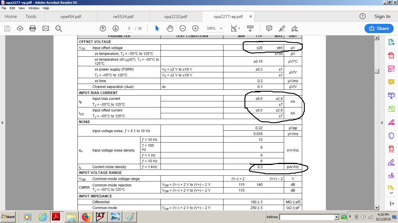

For some reason i can't see any advantage over the opa2277 in the audio range and i can't see any "super beta " being mentioned in the opa2277 datasheet although it has half the current noise and not too far offset and bias specs...

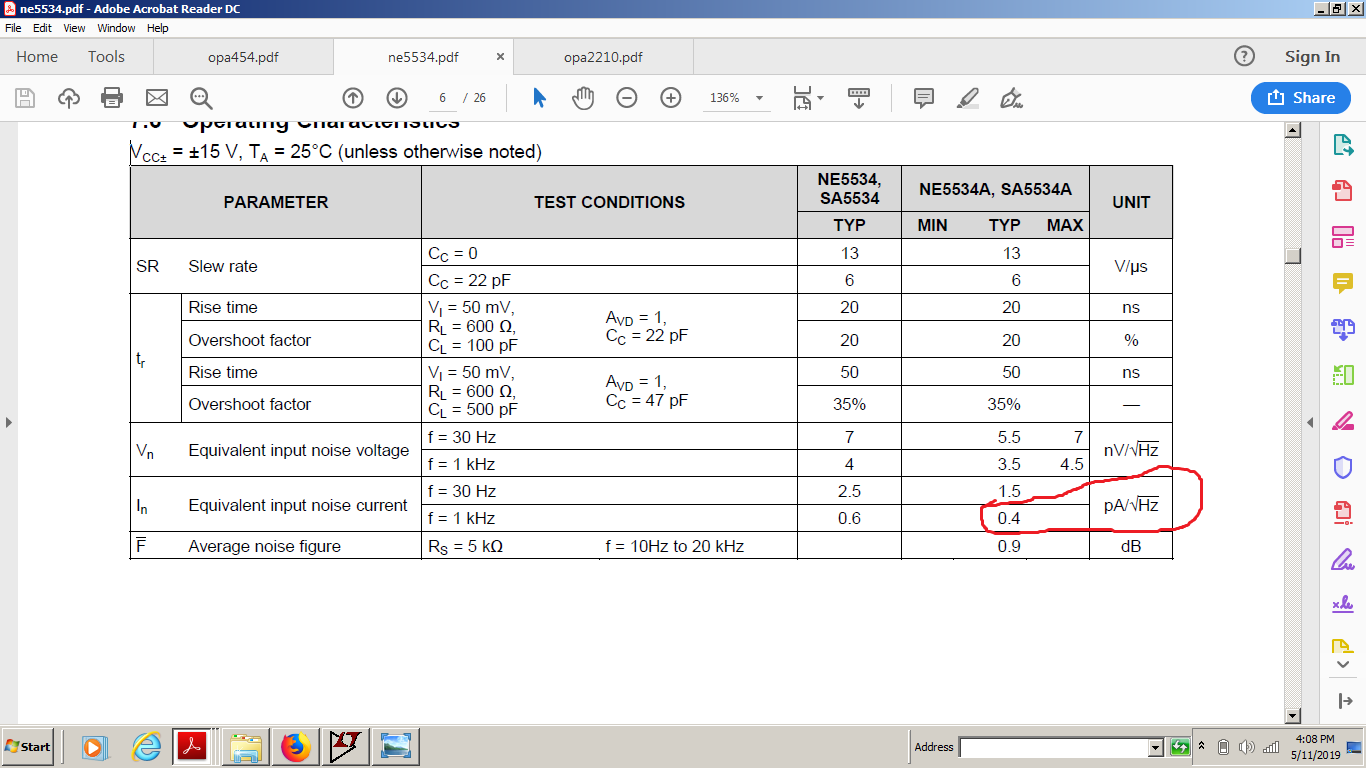

It's a funny story, but for almost 50 years, the NE5532 has been the best op amp for audio. Only the LM4562 has set new standards (after 50 years!). When it comes to noise, the NE5534 is still the best. TI and others can throw so many new developments on the market. That does not change the situation. Sure, there are op amp (by TI & Linear), which have better values in some points, but those are not suitable for audio.
A couple of points here, when comparing the OPA2210 to the OPA2209, the vastly improved portion comes from the offset voltage drift spec. 0.6 uV/C vs 3.0 uV/C max drift. For a precision op amp like the 2209 or 2210, the max column is really where you show your value. The definition of "typical" is pretty liberal. Usually a typical value is the mean +/- 1 standard deviation with max being +/-4 to 6 standard deviations from mean depending on whether the parameter is screened in production and what yield is acceptable on the product. Not all companies follow the same definition though, and there are some pretty awesome examples out there of what is "typical".
Comparing the OPA2210 to the NE5534, you're indeed correct they have the same input current noise. However, the broadband voltage noise of the OPA2210 is 2.2nV/rtHz compared to the 3.5nV/rtHz of the NE5534, meaning the input BJT pair is running at high currents. But wait, the OPA2210 only consumes 2.5mA per channel (max) compared to 8mA (max) for the NE5534? Now let's look at the input bias currents: 2nA max for the OPA2210, compared to 300nA max for the NE5534.
Comparing to the OPA2277, notice that the broadband voltage noise of the OPA2277 is 4 times higher than the OPA2210, or to put it another way, the OPA2210's input transistors have 16 times higher collector currents than the input transistors of the OPA2277. A better comparison with the OPA2210 would be the OPA2227 which may be what you intended.
Comparing op amps on a single parameter is not really telling the whole story, that would be like comparing your cell phone to the raw computing power of an older super computer and saying the technology hasn't advanced at all because both devices can perform the same number of operations per second. However comparing holistically: AC performance, DC performance, power consumption, and even including things like price is much more revealing. Then there are other aspects of the amplifier that are totally transparent to the user like die size, production yields, and cost. Older devices typically achieved high performance by high grade / low grade binning in production which drove up price. Newer devices are often able to achieve the same level of performance without production binning, something that is often revealed in the histograms of a datasheet.
