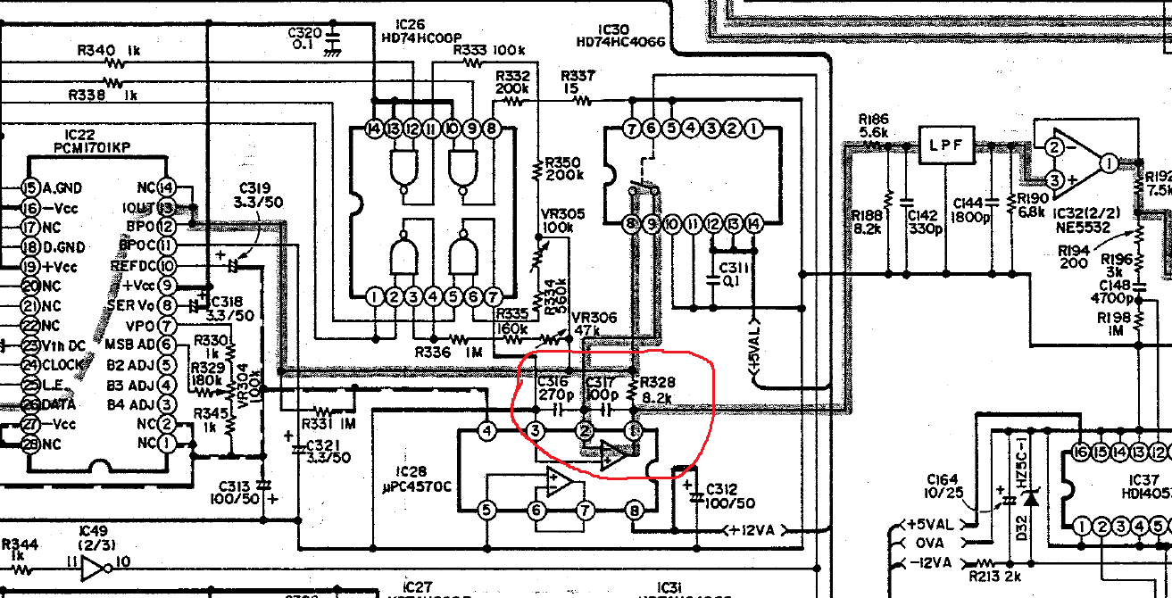

Rs can be also in series with both RC which is a tiny bit better.You should go with opa1612 all the way, in both i/v and filters once you're upsampling .Adding those capacitors at the input like in Denon 1560 (you need to find the perfect values yourself) can be done with any op-amp.That circuit will work very well with any dac that outputs 1ma .In the AD797, the Rs is inside the feedback loop which I could do with the AD8066.

And by the way...i tell this to anyone: before trying any fancy op-amp for i/v section, try first the old LM833 and UPC4570!!!

There's only one other circuit that rivals Technics class AA approach and that is described in great detail in the Art of electronics, third edition page 550...552, fig 8.87, fig 8.88.I am using both variations and they work best with any iout dac .Unfortunately i'm not sure i can post a pic from the book due to intellectual rights.

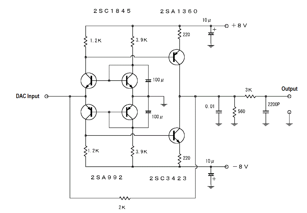

Why not try a discrete opamp IV from Toshiyuki Beppu ?
(The 2k is the IV resistor.)
Very simple and low cost.
Most likely good sounding as well.
Transistors can still be found (KSC/KSA at Digikey, rest at Kessler).
But any low noise equivalent will also do.

You can get dual transistors from Toshiba in SMD which are quite well matched.
Mostly within 1%, but you can always hand select.

Hi Patrick,
I have your CEN or SEN, don't remember the one, think it's the bjt, I remember components were sorted out !
It seems for a technical reason I'm not able to understand, discrete designs are more suited than oaps for I/V of a dac... though perhaps needing a current mirror to work best. Have you please any idea about the reason please ?
Pedja Rogic published both a shematic with opa861 and a discrete diamond and said they will be very close if implemented properly...
What could be the bjt advantage of your Pass improvment design (iirc) over a discrete diamond or also a modern oap please ?

Again, they are not matched, because they are in different cases.
They are NN & PP match in SOT23-5.
I have measured thousands, so I know, for certain.
N-P hfe match you can easily do by a DMM and a test socket.
The only reason for proposing BJT is that most of you simply cannot get decent JFETs without paying a premium.
