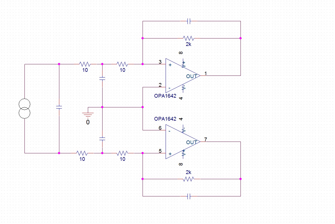

IMO, such CFB circuits make more sense on an IC with very careful design like AD844 or AD846-(RIP) or very interresting:
The LT6275, which shares the advantages of CFB (Virtually no slew limiting) and VFB (high input impedances)
Careful design of the surrounding circuitry is even more important.
In case you add a PI-Filter (with large PP or C0G caps up to 100nF) to the input node, you can easily come away with a good, but cheap audio OPA like OPA1642 or the like, because this filter unloads the I/V Converter from the speedy current transients, overloading the input stage, which can cause momentary slew limiting in traditional VFB designs.
The added noise gain (leading to a rise of noise outside the audio band), the succeeding aliasing filter stage can cope with. A second order filter may be enough, since you (overall) get a 5th order response.
I successfully adopted this trick as an upgrade for the SONY SCD-1 SACD-player, whose "bitstream" current DACs are very demanding regarding the I/V-Converter. The original LM6172 was even not fast enough in the original design, but after the PI filter change a LME49720 was more than sufficient regarding speed and provided a nice boost in sonic transparency.
You can easily monitor your success of this trick by measuring the inverting input at 0dB fs D/A-converted 20kHz sine wave with a scope. If the voltage spikes remain below lets say 20mV, you are likely safe.

The trick may work with Hi-Z output dacs, but not with ESS Sabre or AK4499 where dac output impedance is very low. In the latter case the dac outputs need to be held at a precisely fixed output voltage by the I/V opamp or distortion rises unacceptably. Passive filtering before the I/V opamp allows the dac output voltage to be less tightly regulated and or causes frequency peaking issues in the I/V opamp. The differential summing opamp is a different matter of course. Passive filtering before it can be useful.
I see your point with the AK4499 etc. It seems to me the passive filter idea might be useful with a PCM1792A where the output Z is much higher. This may be a pretty good tradeoff given the fast edges.
