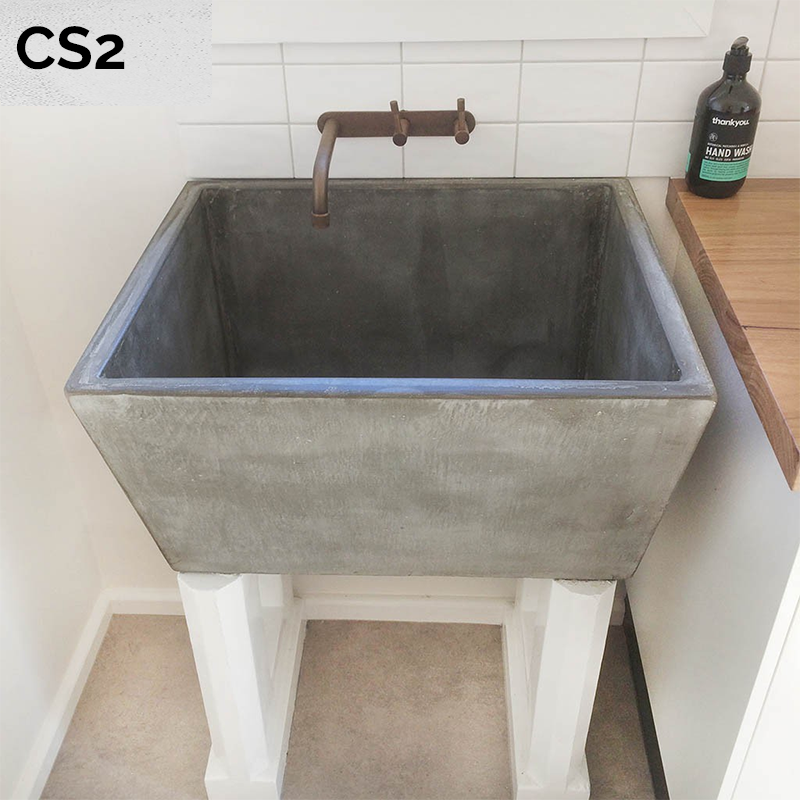

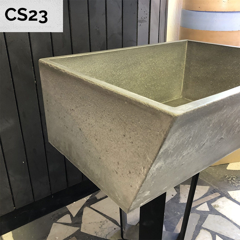

When I started this project, I was planning on buying two concrete sinks to use as cabinets but a friend gave me his wood cabinets which he built 35 years ago.
Kelp88
2007-06-26 5:00 am
I am currently building a pair of concrete floor-standing speakers (3 way). Concrete is much stiffer than wood, for a given thickness. With the panel sizes of the concrete sink I would probably still cross brace it. Also I will be adding damping to the interior of the concrete to tame the ringing of the high-performance GFRC I am using. This may not be as important in a sub-woofer application.
Ben
Ben
Subs need stiffness, mids need damping. A decent sub enclosure should have the main resonances so far above the passband that they will be largely irrelevant.
