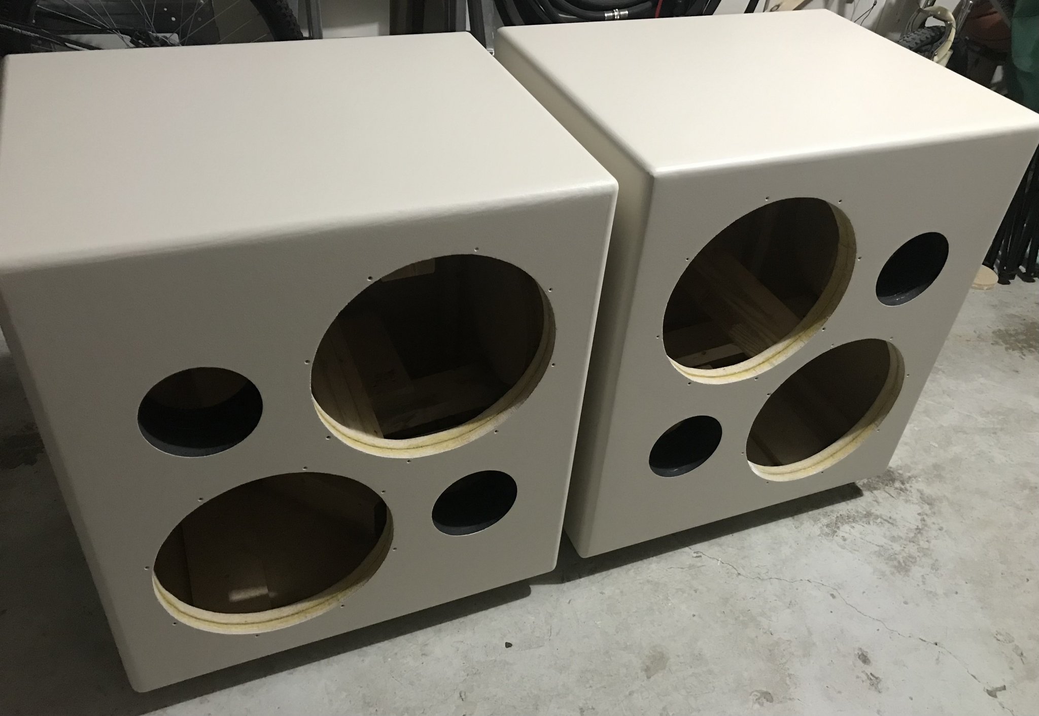

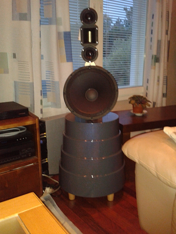

JBL 2035 HPL drivers sat in boxes, unused, for too long. And so I had to build something for them...
4508 enclosure was a logical solution, but for practical and aesthetic reasons I decided to build a 4745 lookalike (different volume and port size).
Totally happy with the result. And what I feared the most - boominess - is n o t there...
32"H x 29"W x 23"D
