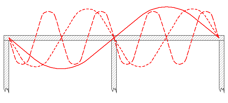

I see that my conclusion from my last post was probably calculated with a modle wich was too simple, i just did the quick maths for a simple one and two span beam. So today i used a program for very simple 2D stress resultants calculations. A 3D calculation would of course be more accurate but i'd assume we would get similar results). I modeled a 500 x 500 mm wooden square ( about 19.5") of 18mm (~3/4") and 36 mm thickness. The Square has perfectly stiff edges, which actualy makes a big difference in deflection. I also ran the Program with pivoting joints and derived at similar numbers as in my first simple calculation with double wall thickness being 8 times and bracing being 30 times stiffer than the normal unbraced box (before i calculated 40 times). That deviation from 40 to 30 times is due to the elasticity of the brace itself which i didn't take into acount before.
That was quite surprising for me, that the stiff edges make such a big difference, so much that the double wall thickness becomes stiffer than double brace. Also i would stay away of just one single brace, even if thats way easier to build. As you can see the deflection on the "free"panel is larger than with the unbraced box.
With that in mind i would conlude: The stiffness of a box depends on the execution of the box edges as hifijim stated before. I would consider a well fitting and glued Box joint as a pritty stiff edge joint and a screwed or even nailed butt joint as quite an elastic edge. The actual deflection lays somewhere between these numbers, depending on the stiffnes of the edge, as every connection between two parts is a spring.
I hope that helps.
Very nice analysis. I am also a bit surprised that a constrained edge makes enough difference that the double thickness panel benefits so much. But thinking about it, it makes sense.

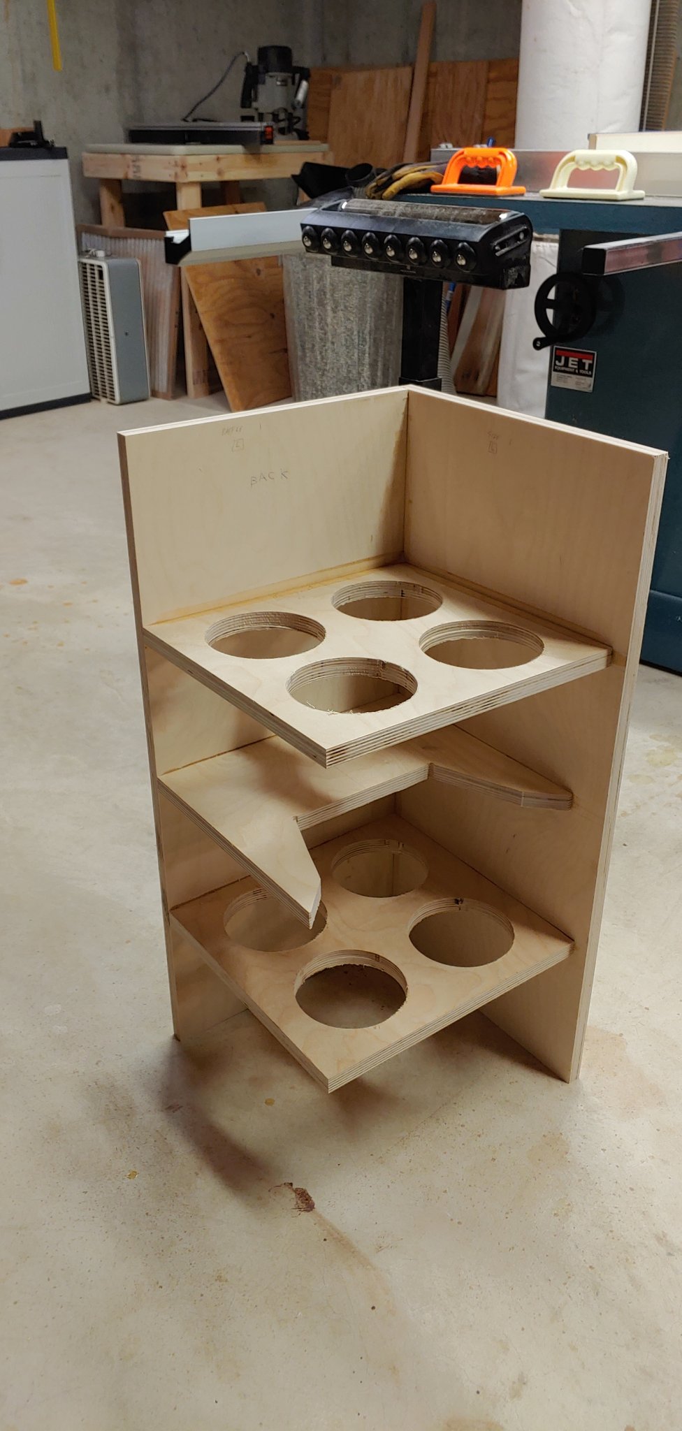

The single and double stick brace that you modelled is what I would consider a barely effective bracing. The photo below is more what I have in mind when I talk about well-designed bracing. The upper and lower bulkheads react the primary bending of the front baffle and shear the load out to the side panels. The middle bulkhead constrain the sides and back. This is a woofer cabinet
Planet10's graphic in post 29 shows a highly effective bracing strategy. I employ a similar approach to midrange cabinets

That graphic reminded me of my first serious sub enclosure, 160 liters, side and back wall only 19mm mdf, baffle 36. Well braced every 20cm in every direction. Quite solid, at high levels everything in the room contributed but the enclosure itself. That was back in the late eighties 😊.

If you brace the cabinet, your panel length halves in the calculation and you'll effectively have a two span beam with better stiffness than single span beam. If you run the numbers you'll get a deflection which is 40 times lower than in the non braced case.
Conclusion: bracing is about five times stiffer than doubling the wall thickness.
(I'm a german structural engineer, so excuse me if the wording is wrong, i used google translator for the technical terms)
The assumption being made that the bracing is done in the MIDDLE of the panel being braced and broken into two equal halves.
IMHO, you'd be much better off putting the brace at an offset from the middle, ie: splitting the panel into a 60/40 or 55/45 ratio. That way you spread out the resonant frequencies of the panel and introduce a lower amplitude, but broader frequency, resonance from the cabinet.

Yes, shifting the brace from the middle will change the harmonic frequency of the panel but as I said I'm a structural engineer and thus only really know how to deal with static forces on structures. Correct me if I'm wrong but i would imagine a golden ratio or division by the square root of two would be optimal as these numbers are irrational and won't create harmonics like in Planet 10's post #47.
You would definately get an even stiffer box by employing three braces or more like Planet10 and Hifijim's boxes. In a simplified model you can say by halving the length between two fixed points, the deflection will be 16 times smaller, as the length goes into the equation with a power of 4.

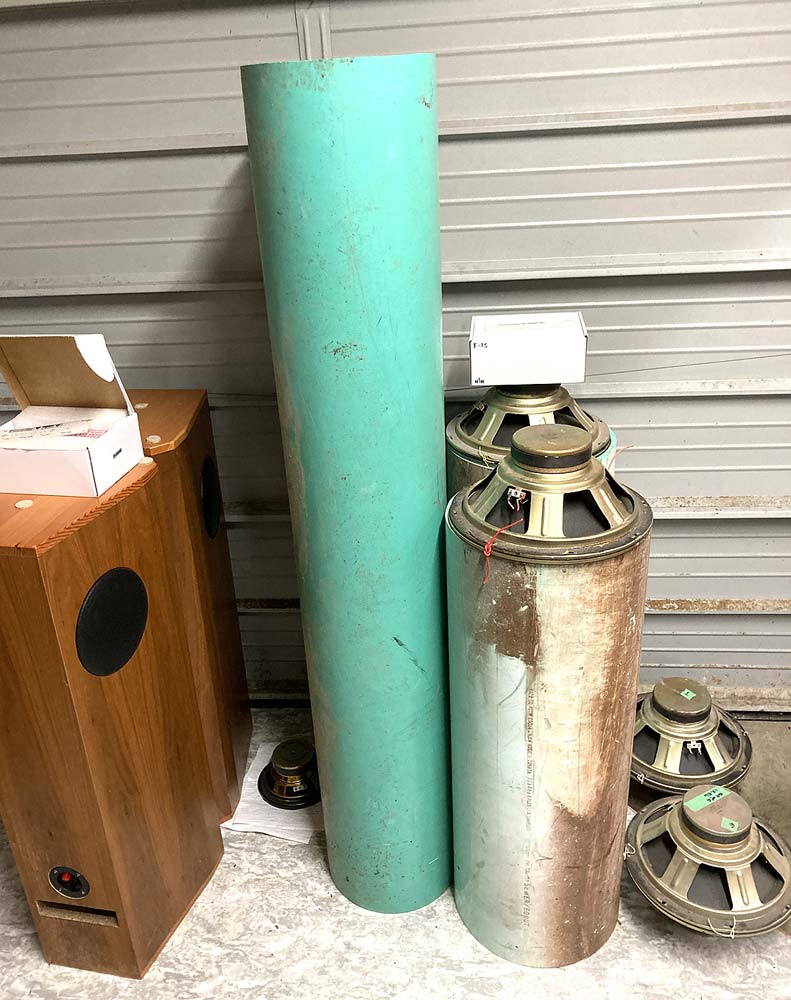

I am in Victoria BC (the Highlands).
These are 8” pipes, about 7 foot tall with 7” Easttech woofers. 2 EnABLed and a spare since one of the treated drivers might be pooched. And somehwere the terminus vent needed to make it into a proper ML-TL.
The pipe in the middle. On the sides 2 of the other 3 woofers for giveaway if you can pick-up. 2 of them veered, just add woofers and XO. The little white boxes are basic 4th order active XOs (free, the could use a bit of work)/ 3 are available to go out with the woofers. 2 ML-TLs, one vented shaped to fit a corner (2 each of the same woofer as the tall pipes), and an isobarik pair tht use a total of 8 12” drivers (i have 9 more woofers but i want modest money for them)

A cyclinder is naturally very stiff
Why? If the walls are thin it will not be stiff, just like a rectangular tube. Only a sphere has inherent stiffness due to its curvature (mathematically a cylinder has zero curvature, which is why you can roll one up from a flat sheet). With a sphere any flexing of the thin wall has to also stretch or compress in the plane of the sheet somewhere else, which involves much more energy than flexing a sheet.
Or put another way a cylindrical wheel needs spokes, a spherical one doesn't.

The stiffness is along the horizontal plane. The cross section is a circle and, as you have guessed correctly, is very stiff and resists stress and strain.
The vertical plane is linear so, on first thought, it will be subject to in and out displacement... BUT, and here's the trick, as the pressure waveform moves along the vertical plane it attempts to expand and contract the horizontal plane... but... but... guess what? It can not because the cross sectional circle resists both stress and strain forces.
So, the cylinder is the strongest.
The sphere, btw, is not desirable at all because it resonantes terribly... think about it.
The wheel example is not applicable. The reason a wheel needs spokes is to support the hub. A hula hoop has no spokes, huh?
Reactions: MrKlinky
Because of the shape. The walls on the PVC pipes above is something like 5mm and will be much more resonance immune than the same in a rectangualr pipe.
