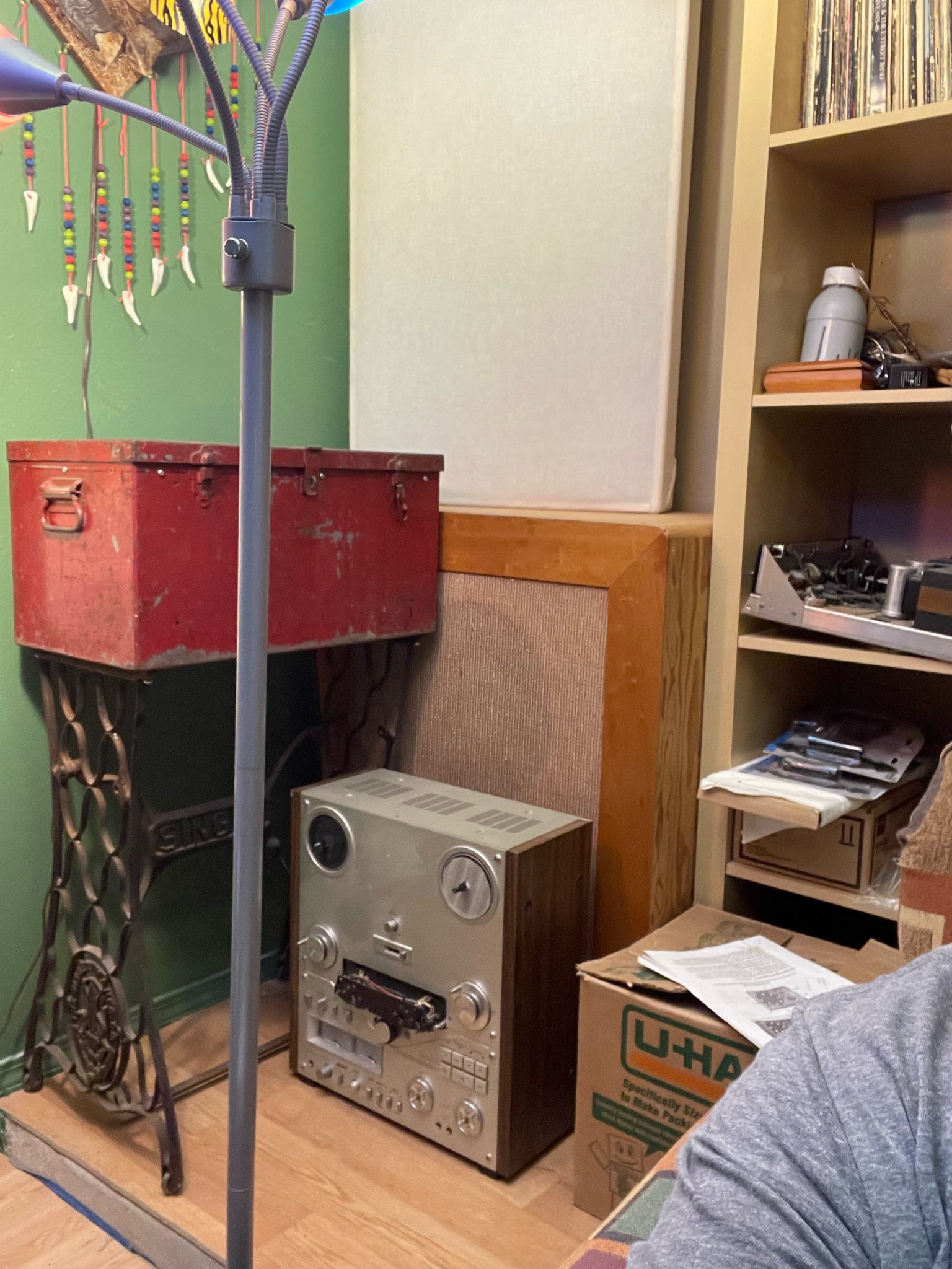

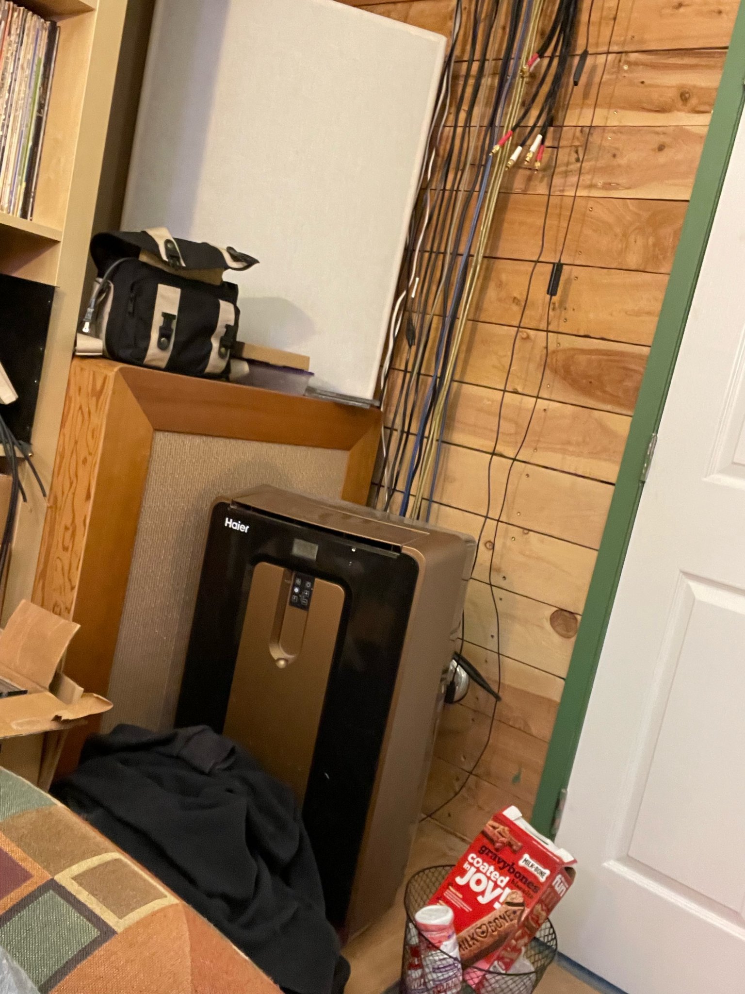

These will be my rear subs. The cabs are very large as you can see. Each one will house a 15" sub and both will be driven by a Behringer NU3000 iNUKE High-Density 3000W Power Amplifier with DSP.
https://www.parts-express.com/Dayton-Audio-RSS390HF-4-15-Reference-Series-HF-Subwoofer-4-Ohm-295-468
