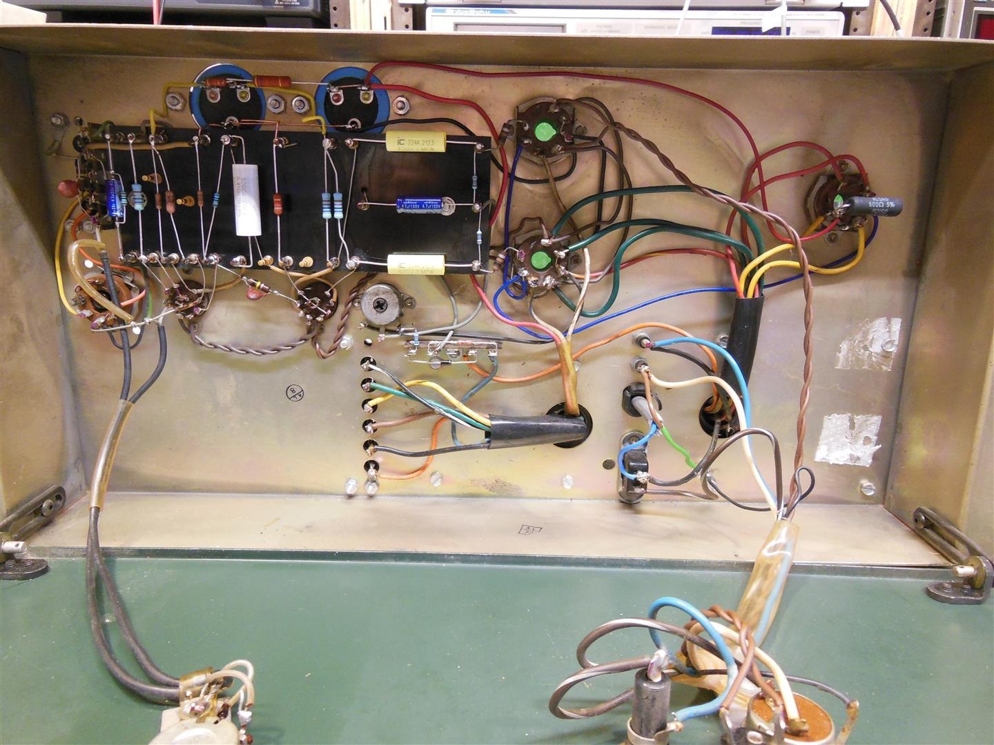

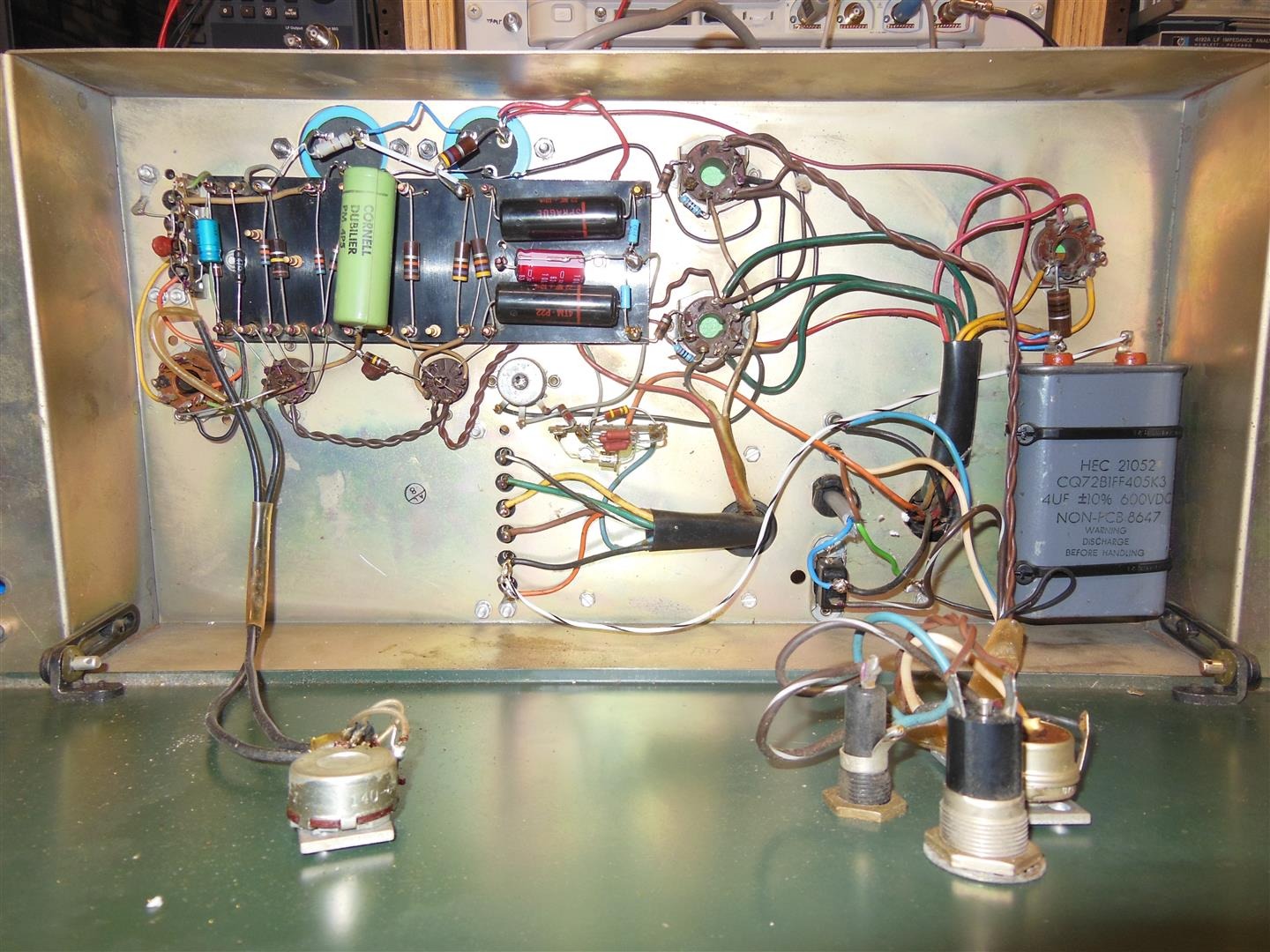

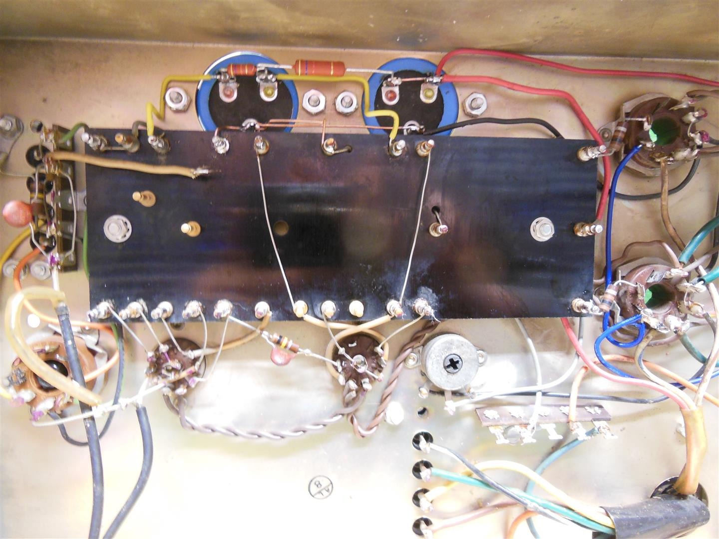

Caps inside a can can't dissipate heat effectively. I always use the CE manufacturing caps, and duties and clearing fees cost me huge! I find the axial caps just fit and work better.
Back in early days we used axial caps everywhere because radial caps were not readily available. I laugh when I see an early unit done that way, but we had no choice at all. I just completed this amplifier. I do as I say I do. I used the main filter capacitors the previous guy installed. They work fine but are a pain to connect to.
Nice work... as with so many things it depends on what you are trying to accomplish. Beyond basic neatness I think that with what you do there is significant importance put on the "look" of the internals as that is of importance to your customers and end users. With me, they want a box that is dependable, stable and can be sent out for an accredited cal with no worries. IMO, a lot more expense and artistry required for you than me - thankfully! I can do form but it doesn't come naturally or easily for me - and you certainly have my admiration for having the patience and skill to do so.

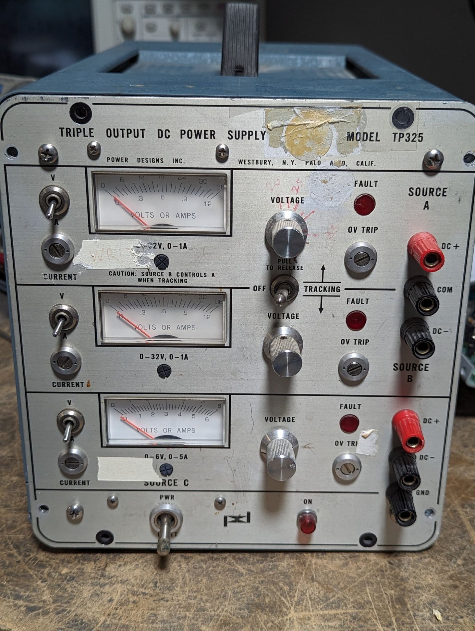

As for new on the bench, this just came in. I have always had a lot of admiration for Power Designs supplies as they are pretty much bullet proof and not only "just work" but they do it well and will outlast all of us. With one of these I like to modify them by replacing the front current limit trimers with actual pots with knobs - and with a integrated push/pull switch to short the output to make it easy to set the current limit.
Thanks Hal,
I love those supplies. Perfect for working on smaller power amps! Nice. If we were closer I'd try to buy one from you. Your mods make sense.
I use HP 6186 B & C current sources for some work. Valuable things to have.
