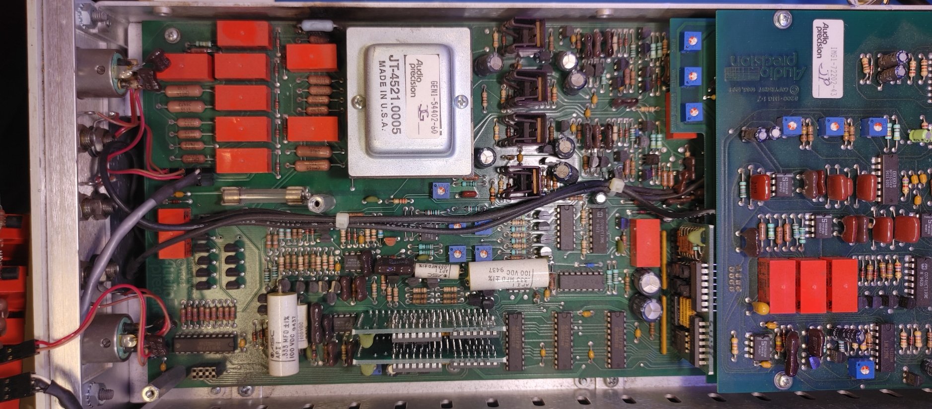

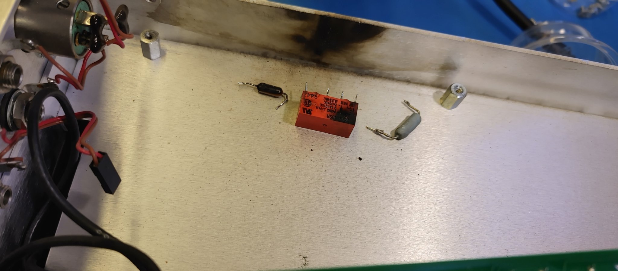

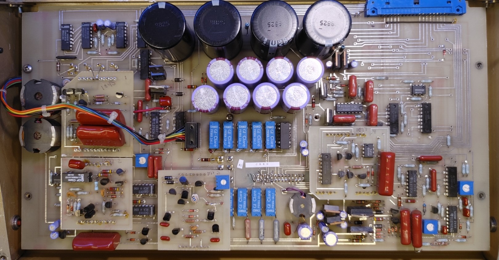

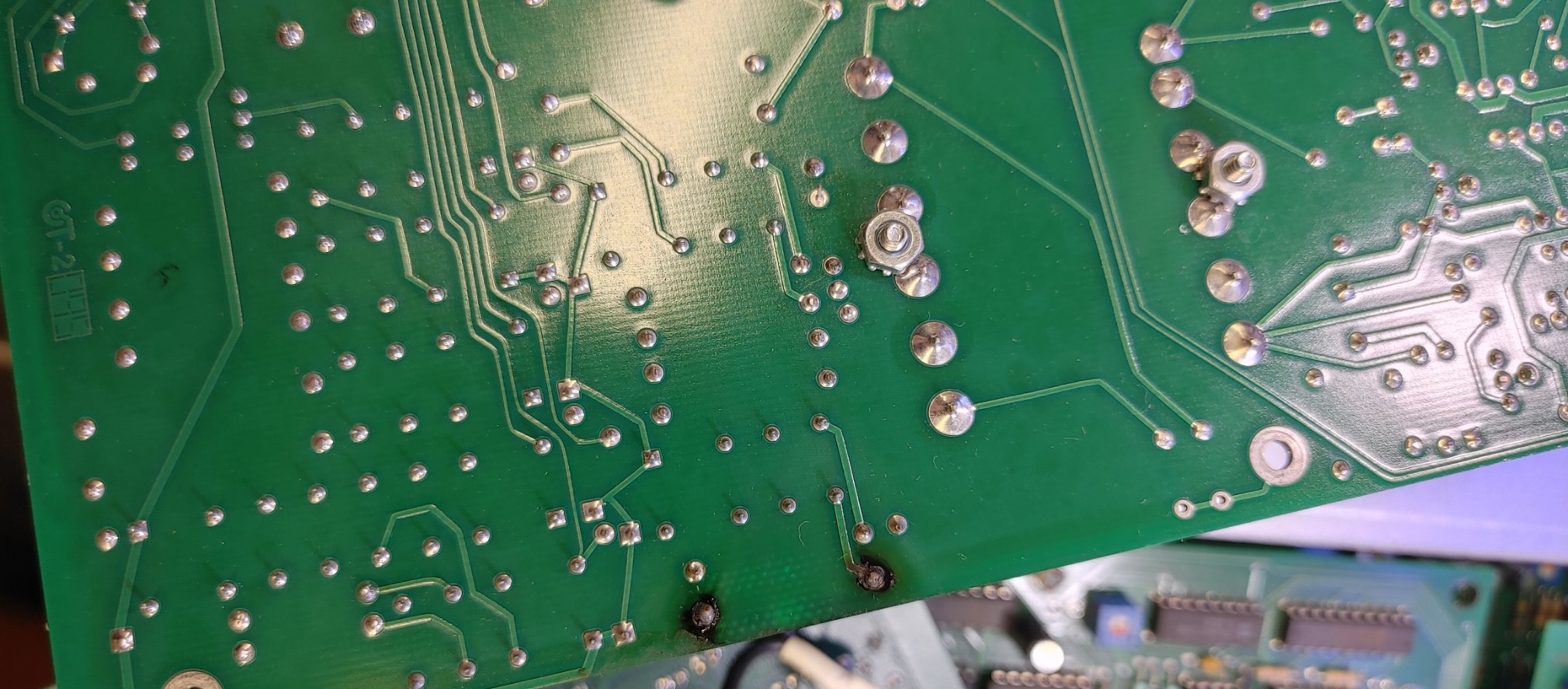

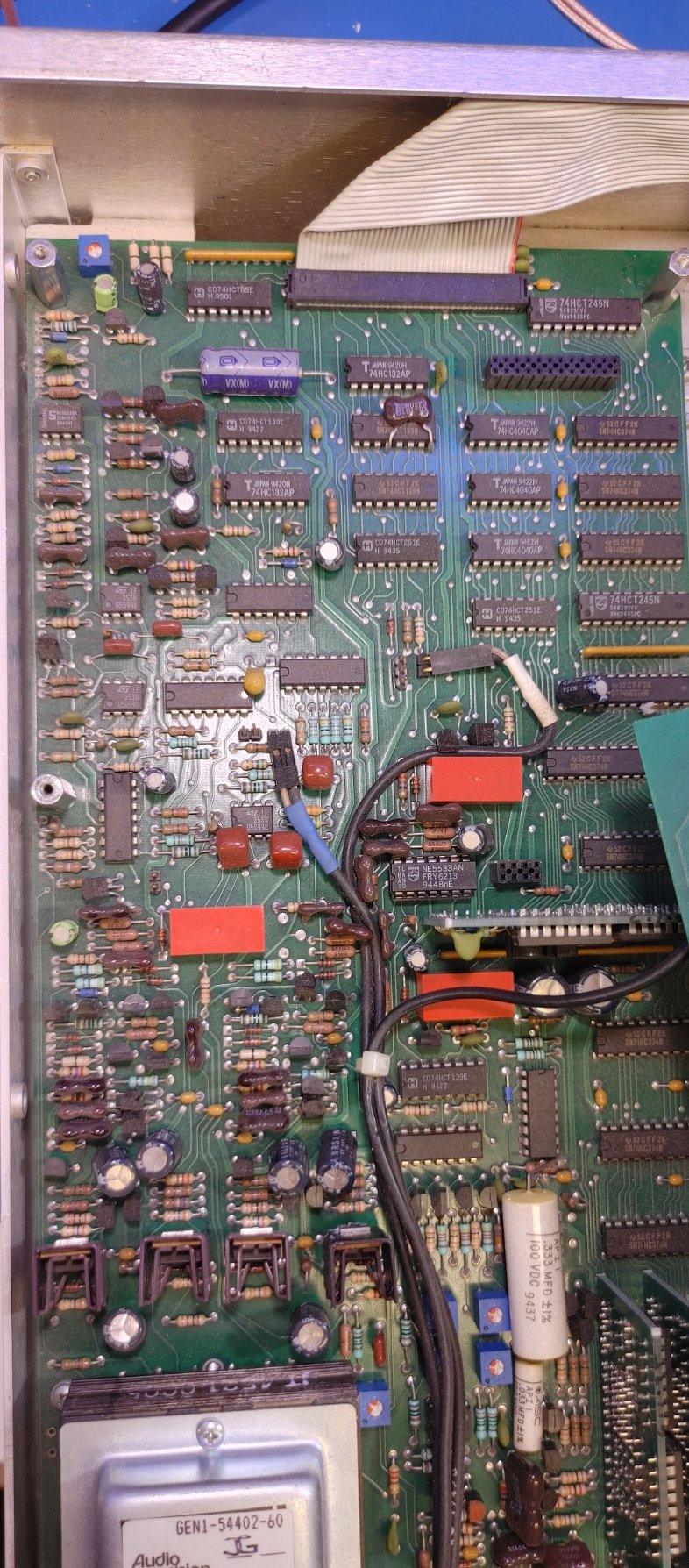

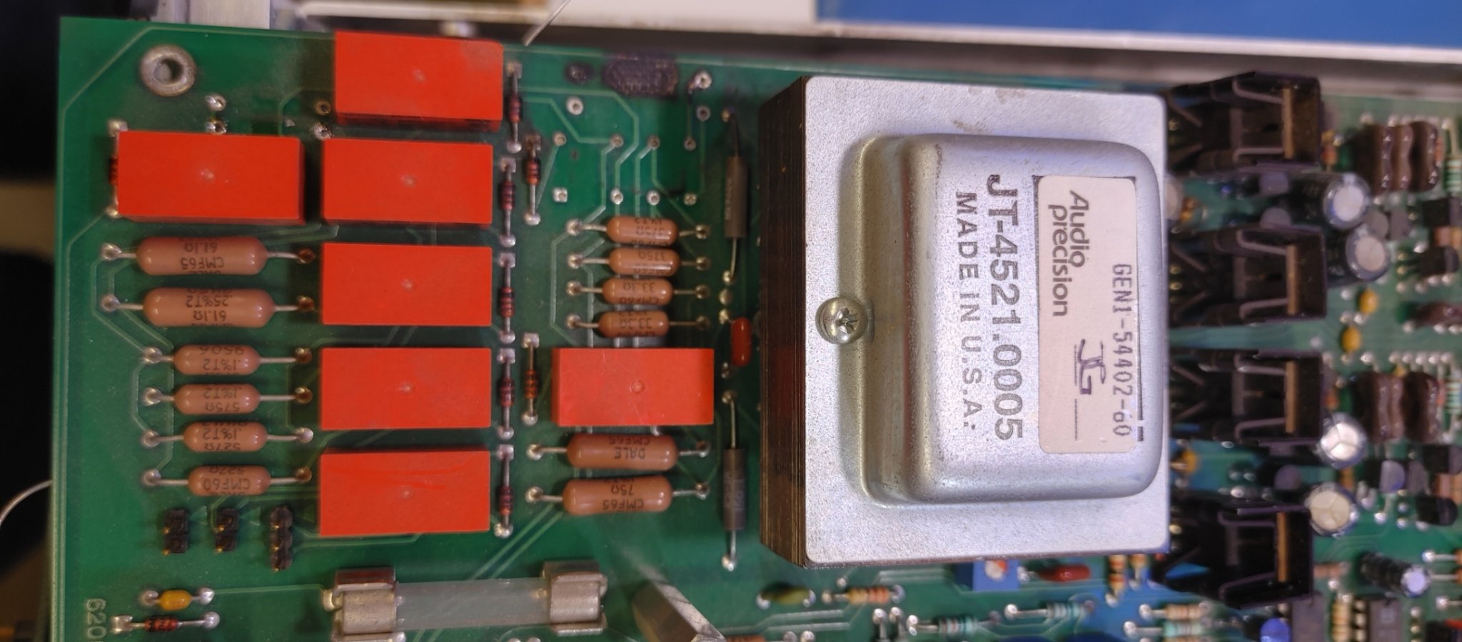

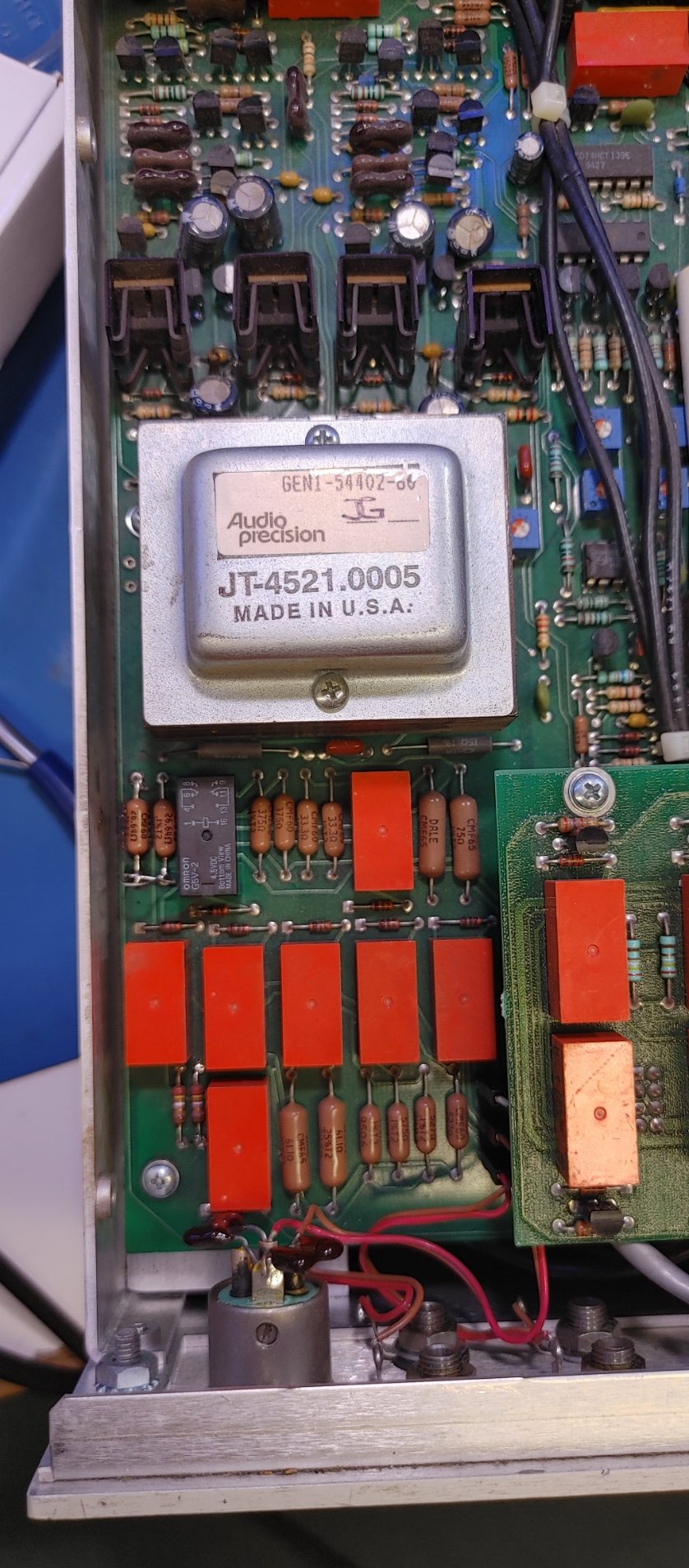

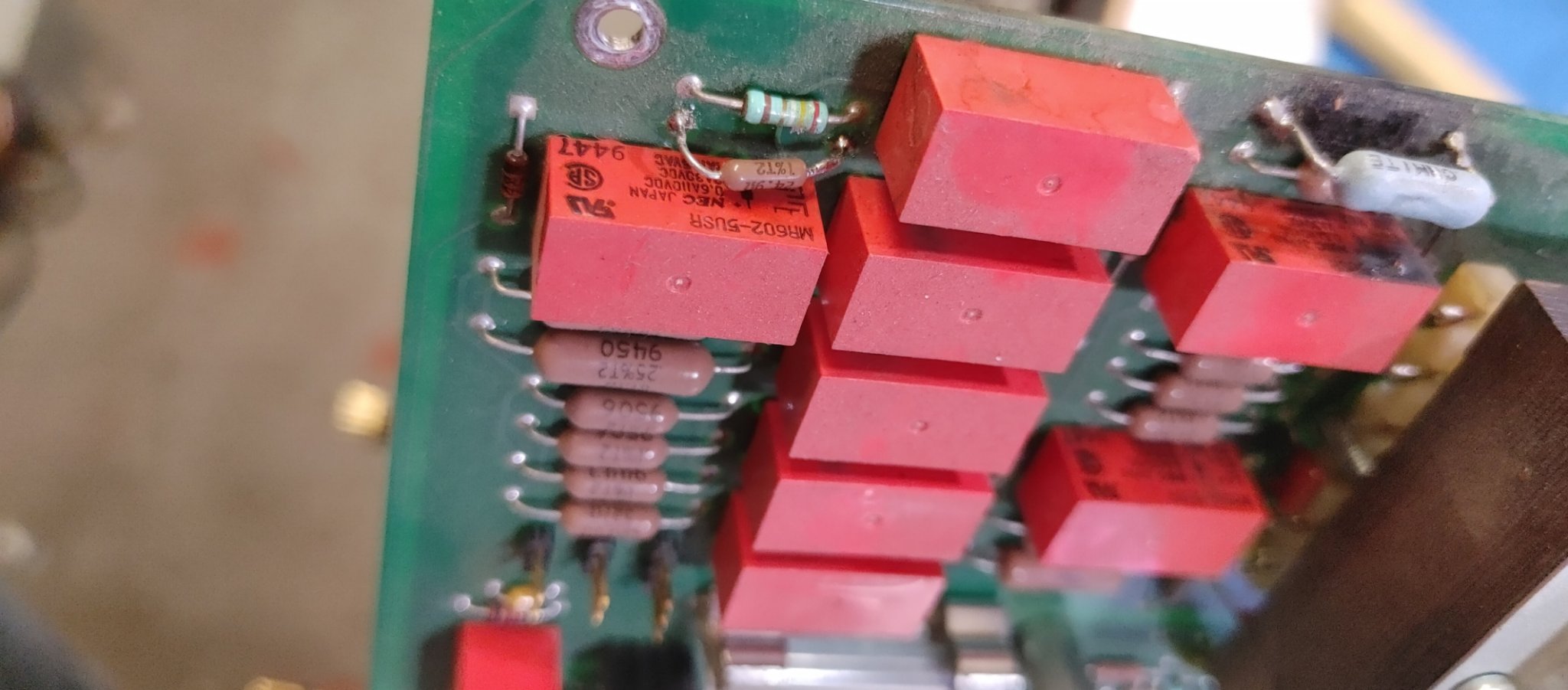

Audio Precision S1 repair- A common problem is plugging an amp into the output of the AP and frying some components. The initial symptom is incorrect levels below 500 mV. Duke has a test to validate the attenuator accuracy. On this unit it identified the problem an which resistor was most likely bad. Repairing it is pretty involved because you need to access the bottom of the source board. To get there you need to disconnect a lot of stuff and keep track of the connections. Photos help. Someone had tried unsuccessfuly to repair it. In my checking it seemed some relay contacts were cooked. Photos of the parts and damage are below. Next the repair- Fortunately suitable (identical to original) resistors are still available from Mouser. Relays not so available. I found a suitable relay at Mouser, however it draws 4X the current. I have found and ordered some correct relays from China but the one from Mouser arrived much sooner.
After installing the new parts and cleaning everything it still had an issue. Traced it down to a damaged trace from the botched repair. Now it all works to spec.
Attached are before an after repair photos.

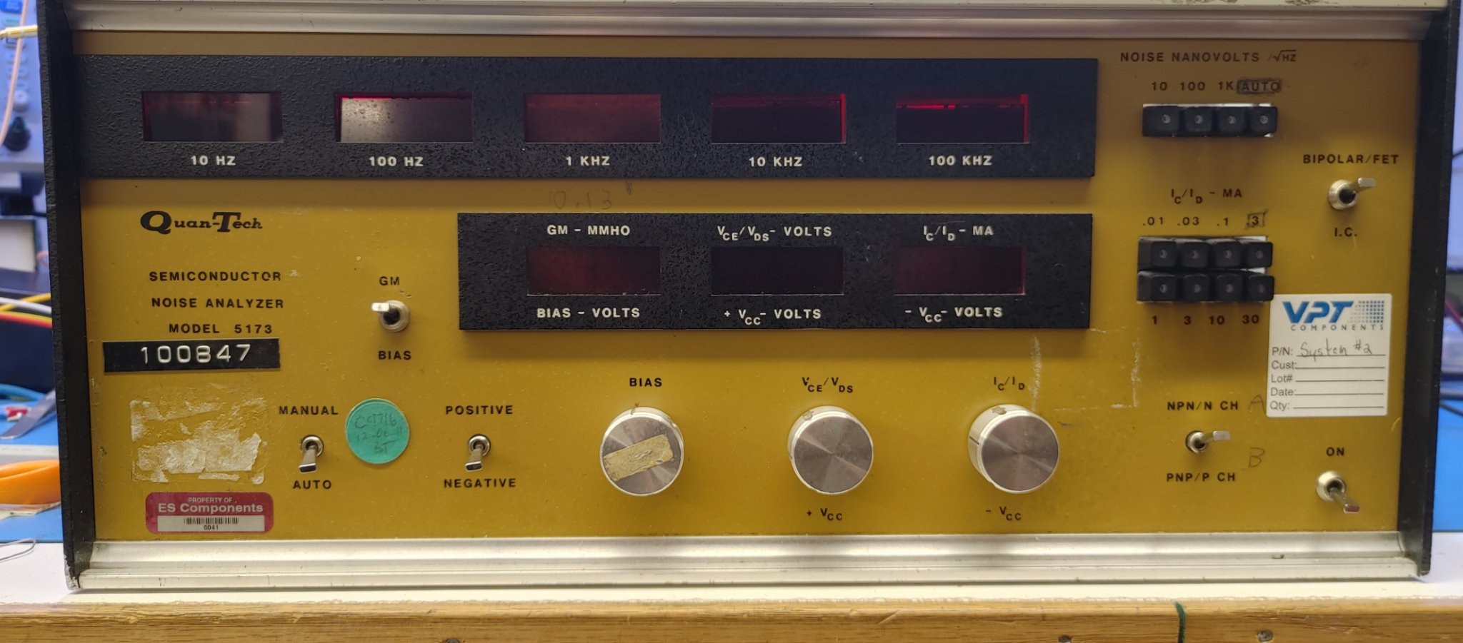

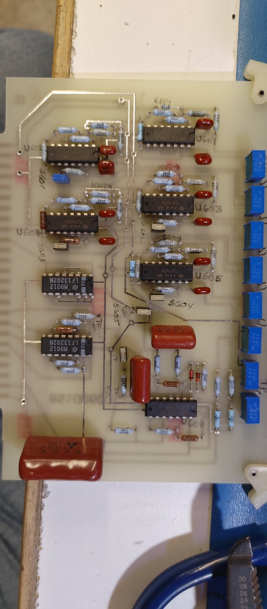

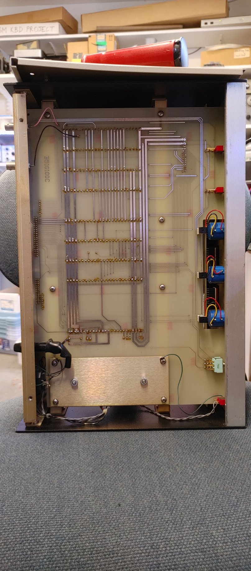

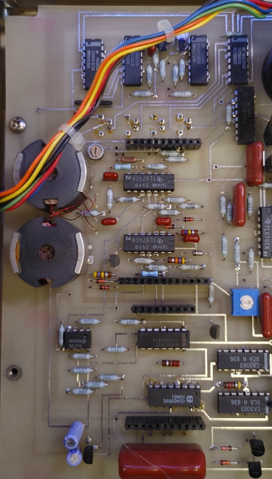

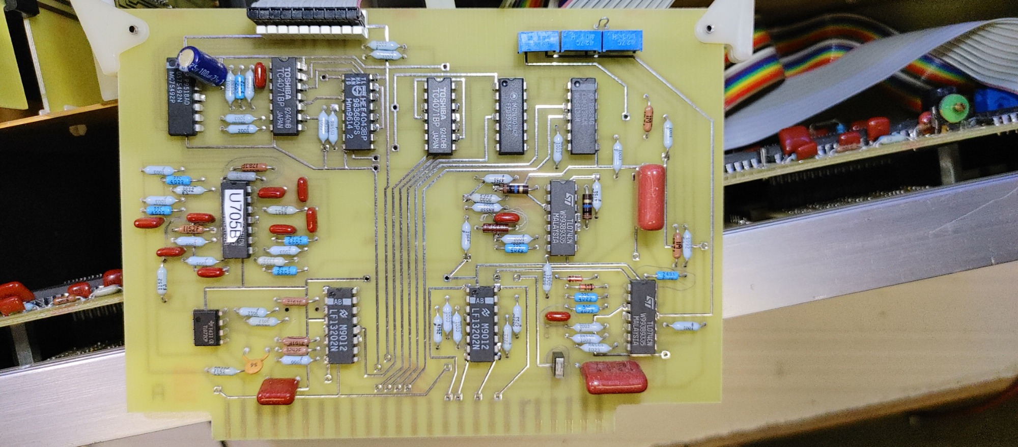

I have spent the last few months repairing Quan-Tech 5173 semiconductor analyzers. It seems no one wants to work on these. The company no longer exists and there are no real modern replacements. And they are essential to meeting some Mil-Spec requirements. They are hard to work on and the docs are not complete and in come cases just incorrect. And the units have been poorly repaired (butchered) in some cases. Here are a few pictures of one.

Hi Demian,
I'm afraid that butchery is the norm these days. I saw some with really good test equipment in 1999 - 2000, before that with "repair grade" (B&K, Leader) test equipment. In audio, service has scraped new lows. I am having to do down to chassis rebuilds just to get the things back to factory. It's really sad.
I am curious about the AP-1. Doesn't it attenuators on it's inputs? I haven't used one so I don't know. The relay banks would suggest they did. Also, what kind of overload does it take to damage signal relay contacts???? Not unless it is designed for signal line levels only.
It was the output attenuator that was cooked. Power amp connected to the wrong connections. The AP has its output on the left side. Every other audio analyzer I have used (a lot) has its inputs on the inputs on the left side. Don't think, just plug and poof the magic smoke appears. The source Z is 50 Ohms so many amps could cook it.
Oh wow! Yep, that would certainly do it.
Yes, most inputs are on the left. I can see someone who uses more than one instrument making that mistake. No reading? Easy, crank it up! lol!

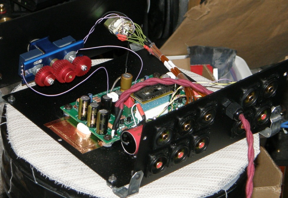

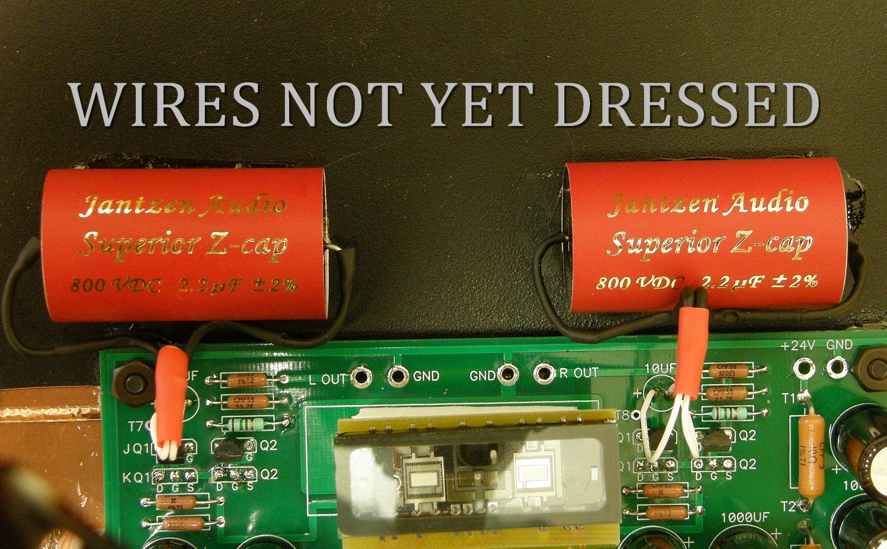

I'm not a fan of parts that don't fit. I just yanked and discarded some new Jantzen capacitors someone rammed into a pair of MC60 McIntosh amps. That and a whole bunch of "audiophile approved" parts. Now everything fits, it's neat and will actually last. They even replaced wire for Teflon type. I replaced it, ran it properly so the amps are also stable.
I have measured and listened to all kinds of capacitors. Audiophile type caps are no better than good industrial capacitors (that are smaller), and very often are not as good. I don't know why you have 800V caps in that location either.

Yah well, this is the first time that I have tried this and am very happy with the results.

Cool, you could have got to the same place a lot cheaper, with smaller parts. That's all I'm saying. Mechanically speaking, you would be wayyyy further ahead with proper sized parts.

I always explain reality, then if they insist I will either pass on the job, or do it. I would never have installed those capacitors in that unit. I'd rather walk on the job (and I have). #1 rule, the parts must fit. If they don't, I won't install them. There is enough work out there that I don't have to perform jobs that aren't right.
It is likely you had to enlarge the component holes for the leads on those caps. Big no-no.
"To each his own" but replacing 10 uF caps with 2 uF caps on long leads will both reduce the low frequency extension and add inductance, along with the inductance intrinsic to a large axial component. I would have recmended bypassing the 10 uF cap with a .1 uF film or NPO ceramic. No brand cachet but better electrical performance.

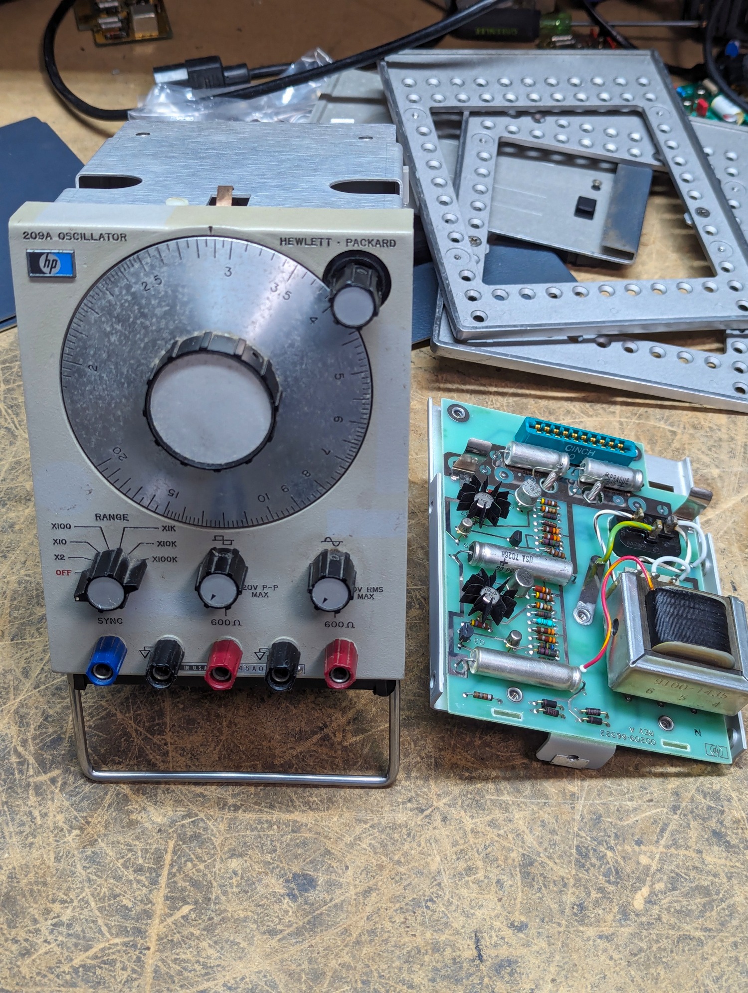

Just started on a nice little HP 209A. Other than a general cleaning, the main gears were very gummed up and hard to turn but that was fixed easy enough. As expected, the caps on the PS board are all pretty much toast - included what was needed on the current Mouser order. No major drama or war stories with it - just a nice addition to my collection; I didn't have one of these and had been looking for one so I'm quite happy with how it seems to be turning out.
