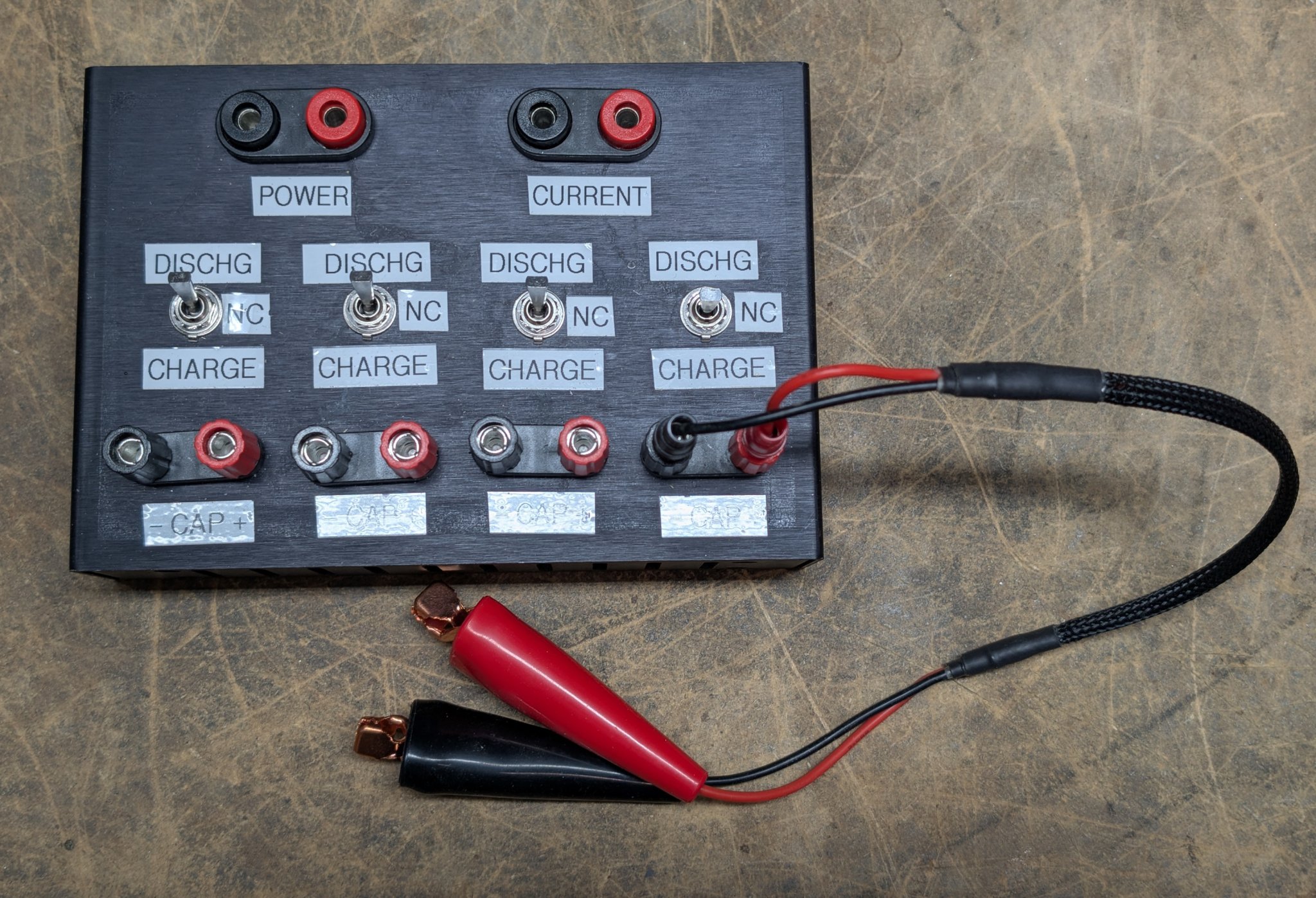

As nice as the Fluke is, I almost hate to admit that I use it the most for testing capacitor leakage. It handles any voltage that I want, set the current control at halfway and you have around 10-15 mA current limit. I made a little box (below) that I use for charging up to four at a time and easily test & discharge individually. The TE that I work on tends to have a lot of the large screw terminal capacitors and, for them, the leakage current going high is one of the most reliable signs of failure or about-to-fail. The Fluke lets me always be able to test them at their rated voltage which is a requirement for leakage testing.
lol!
Well Hal, I use an HP 6186C for that task. I'll put the 34465A or 34461A in series to measure leakage current if it is critical. So you aren't crazy at all.
I could use the Data Precision 6200 but the 6186C has a current limit that is adjustable and the meter will read it. The 34465A reads very low currents, so I can check film with it. I guess I could drag out the Fluke 5100B if I really needed to do that for higher voltages.
Isn't the discharge hard on the switches? You would need resistance in series for sure.

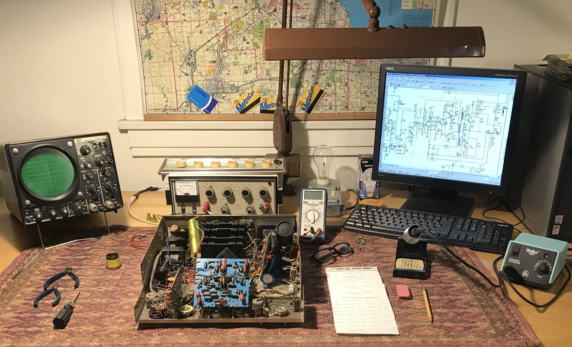

I have restored a total of four 1960's era amps & preamps, this will be number five. A 1966 Sherwood integrated amplifier that someone attempted to get up and running but apparently gave up. It will keep me busy for the next few weeks while I take one bite at a time. I'm going through the schematic and putting together a list of components, verifying against the amp as I go.
You have a good start.
Those small capacitors across the terminals of the multisection caps. Don't ever do that (like someone has). You have to remove the old capacitor completely and either replace it with the same style, or figure out a solid way to mount separate capacitors. You can use terminal strips, or a PCB. Don't allow them to just hang there.
When one section of a multisection cap fails, the others will follow. They may short, so completely remove the old part. The issue is that the lugs are used as tie points very often, so you need terminal strips for any other components that were attached to the lugs.
-Chris

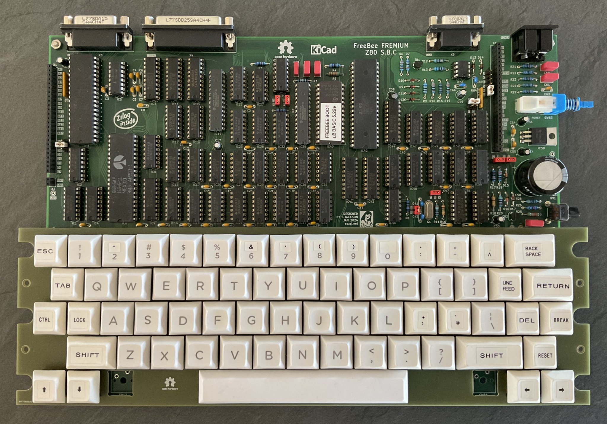

How many layers Suzy? I am guessing 6? Two power planes and 4 routing layers.
I see it’s a new design by your date stamp. Wondering why use old z80 tech in today’s world? Need to re-create a legacy design for code preservation reasons or support, just curious since I enjoy looking at your skills 🙂
Amazing, a Z80, a 6545 for video, some hitachi sram 62256 ?, maybe a 8255 and a BASIC Rom… so much memories.
One question, why so many TTL glue logic ? There are more than the few ones required to operate the chip listed above.
Are they more chips under the keyboard ?
Could you tell us more about this very neat board ?
