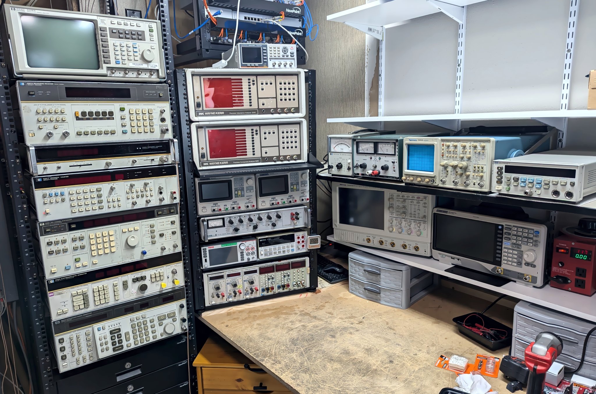

Not exactly on the bench, but the bench itself finally rearranged to start on the next project(s) Still some work left organizing the fiddly bits though...
No, we are certainly not alone in the addiction and I can see that you've fallen in the RF money pit as well - it's not the equipment, it's the fiddly bits to make it work that will endanger your bank balance.
Believe me Hal, it's the RF equipment! The little bits don't help on bit for sure.

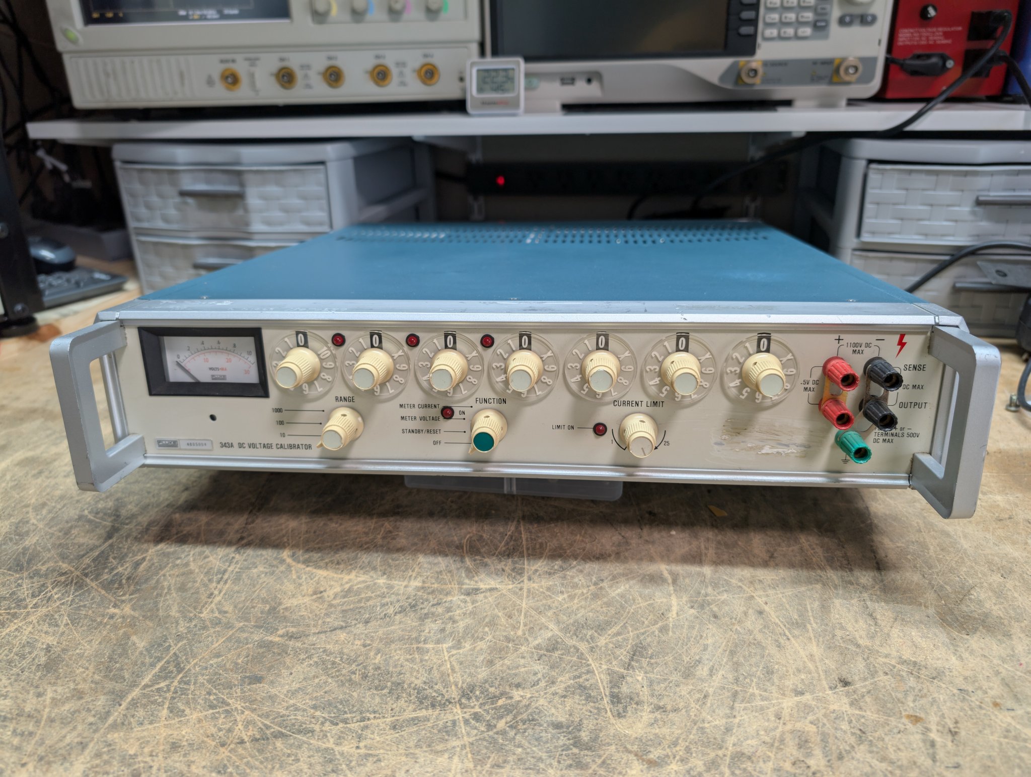

Another 343A - no electrocutions this time around 😏
This one needed the chopper amplifier adjusted and "finicky" doesn't even begin to describe it. The manual makes it sound like a very easy process - and maybe on some units it is - but on this one the balancing act adjusting R160 and R162 took most of the morning. The unit wouldn't let you get the Zero Adjust better than -8 uV at the end of the adjustment range and it should be able to get better than +- 2uV somewhere in the middle. Anyway, it's done and it adjusted fully within factory specifications in the end. And, most importantly, did I mention no electrocutions?

You probably have part drift putting it outside the adjustment range - but you got it done. Excellent!
