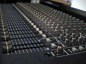

I hated working on mixers, back in 1990 I was working part time at a guitar shop where I did repairs. Someone brought in a 24 ch Roland mixer (like attached) it had some mashed volume sliders.To take it apart you have to remove the top first. All of the knobs and nuts and washers on all of the rotating controls. Well over 100 closer to 200.

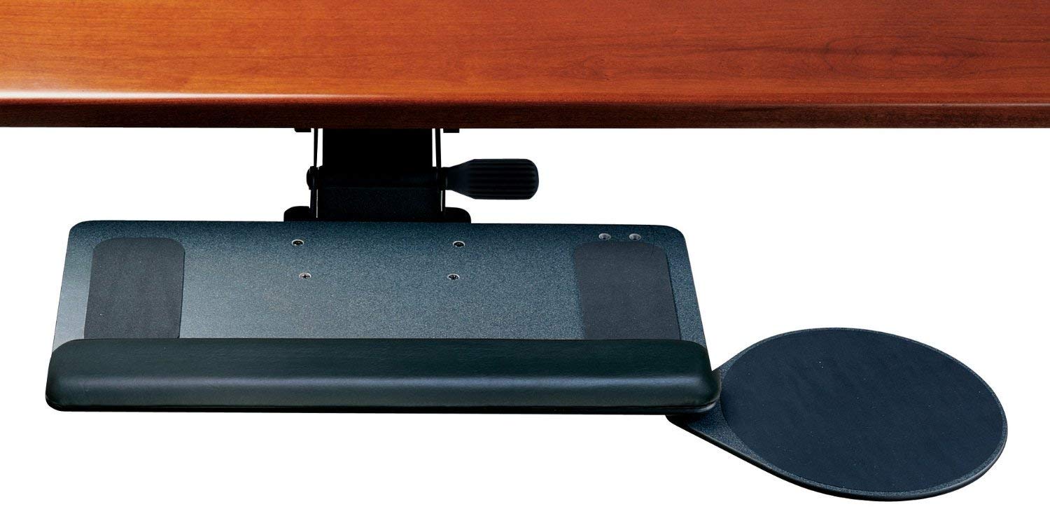

Take a look.
This mounts under my bench to hold the computer keyboard and mouse. Easily accessible, easy to slide out of the way.
I got mine new surplus on ebay.
Thanks DT
Humanscale

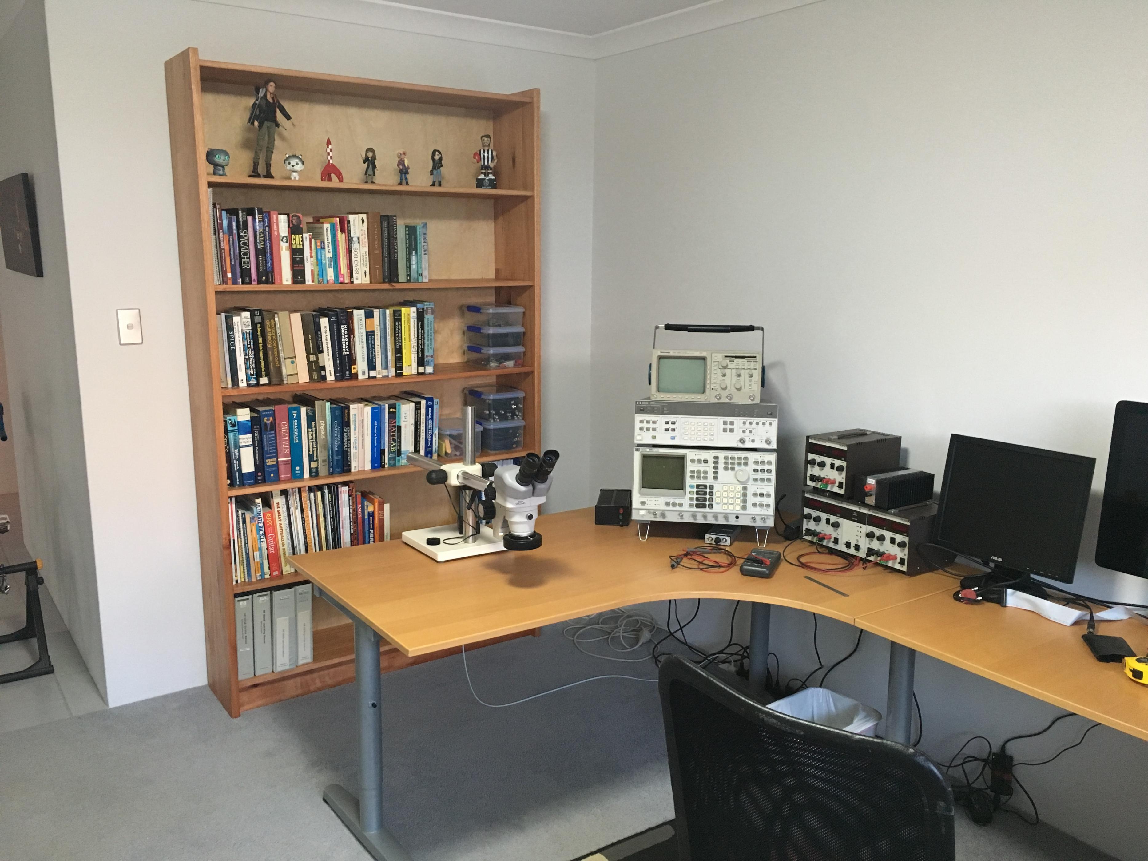

I've moved with my hubby to new digs. The new place has a home theatre room, plus study, four bedrooms and activity room. It's frankly ridiculously big for just the two of us.
So I've taken the home theatre room (4m x 6m) as my study and test equipment area. The room is open plan onto the entry-way and living areas, so I'll have to keep it tidy.
As well as that I've commandeered the study room (3m x 4m) as a sewing/soldering room, as it's just across from my actual study so it's convenient. Perry's grabbed one of the bedrooms as his man cave (somewhere he can display his thunderbirds toys). We've also got a guest bedroom, a gym room, and (I kid not) we're using the activity room as a library.
So all our bad scifi and fantasy novels and DVDs come out of their hidey places in various boxes and get displayed in bookshelves. It's rather nice.
Hi Suzy,
That sounds amazing! What a nice space to work in. I'm hidden away in our basement. Of course, it's cool in the summer (cold if the air is on) and warm in the winter. It must be really nice to be able to look out of a window while you're working on a tough problem. Congratulations!
As for the house size ... you two earned it. It sounds like a sweetheart of a house.
-Chris
New house, new workbench. I just finished making the huge solid Karri bookcase in the background, so figured it was time for a photo. I’ve evicted construction activities to my “sewing and soldering” room, which is still a schemozzle, but it means my main study is reasonably uncluttered. I’ve got my HP3585B spec an and HP3325B sig-gen, plus a Tek TDS340A. I’m partial to Thurlby lab power supplies - I’ve got a dual PL320 and a PL154. I’m using a Fluke 87 DMM as well. I’ve got a Frex AN67 high purity source under the spec an for when I need a good 1KHz tone. The microscope is a Nikon 645 stereo one, and will be evicted to the soldering and sewing room once the bench in there is adequate. Out of shot to the right is my iMac. Behind me is my main stereo (NAD) which I listen to while I work.
I’ve gotten on top of the test lead problem by using many clip-close plastic bins - one for BNC leads, one for RCA leads, one for adapters, one for cro probes, etc.
