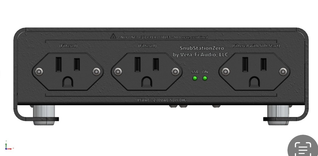

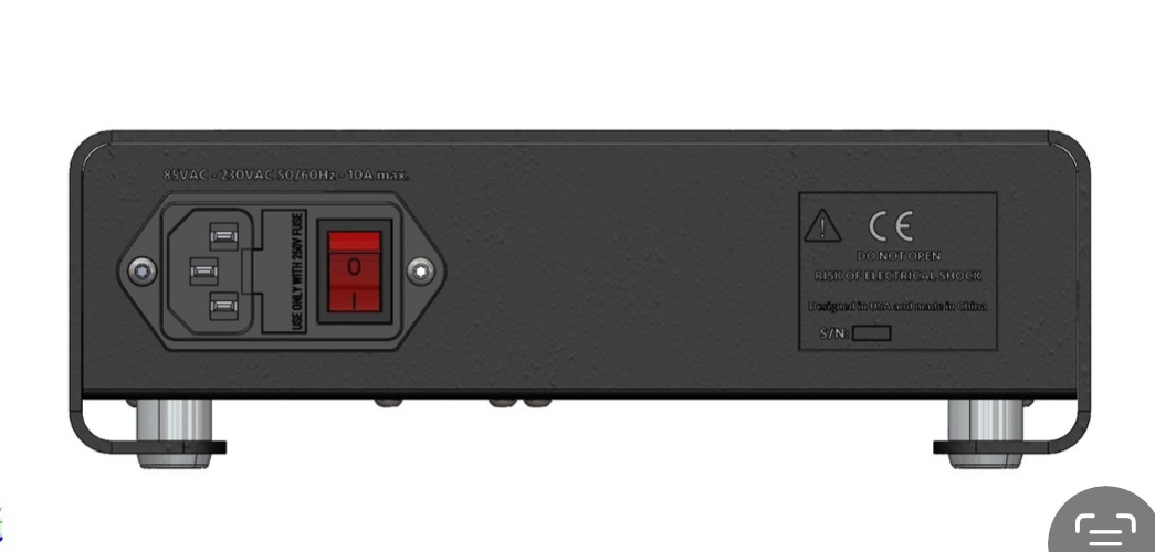

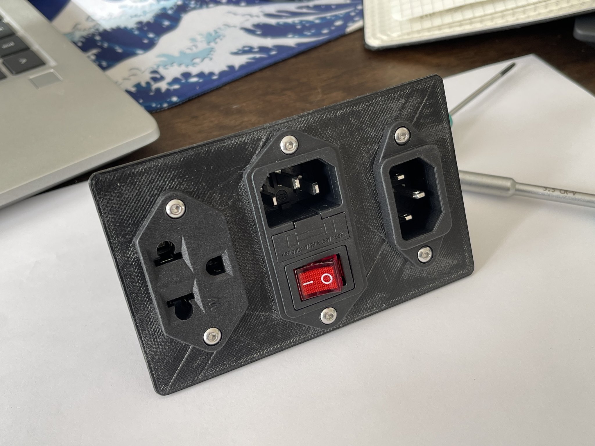

On the bench is a 3D printed test panel to check fitment of IEC inlet shells and NEMA outlet plugs for a couple of new products: SnubStation Zero and InfinityFuse.
We initially had snap in receptacles but they felt iffy. I much prefer screw mounted sockets for secure hold.

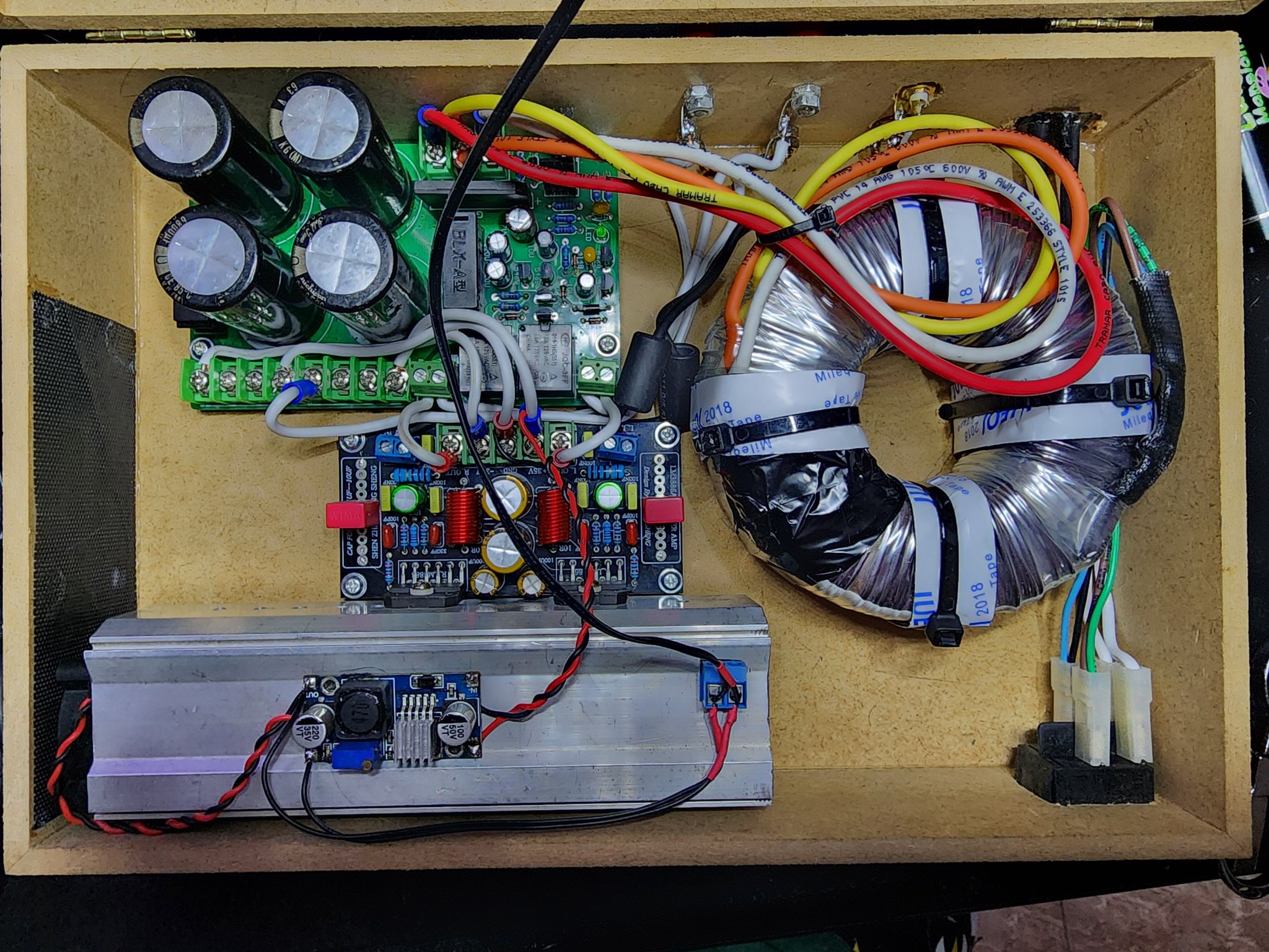

I've always wanted a LM3886 based amplifier. So I got some cheap boards from China, possibly fake ICs, cheap wooden box and made mine.
The only thing that's great in this box is the transformer, a original 15-0-15 toroid.
It still sounds pretty decent!

@xrk971 Overall, the LM3886 is my third project that I "finished" per say... do we ever actually finish those?
I started it all with a PAM board, it was pretty bad overall, then I got a TPA3116 and delved deep into it, I still have my dual 3116 with your Snubber mod (been some years!)
There was also a TDA7377 which my FIL is currently using, and lastly this 3886. It took me a while to find a housing that would fit everything inside, aluminum chassis are pretty expensive where I live!
I ended up going with that board because it was the only one that somewhat resembled the boards made by Neurochrome. It really doesn't sound bad and it packs quite a bit of power considering I only feed it with 21-0-21v (that's the V output of that PSU).

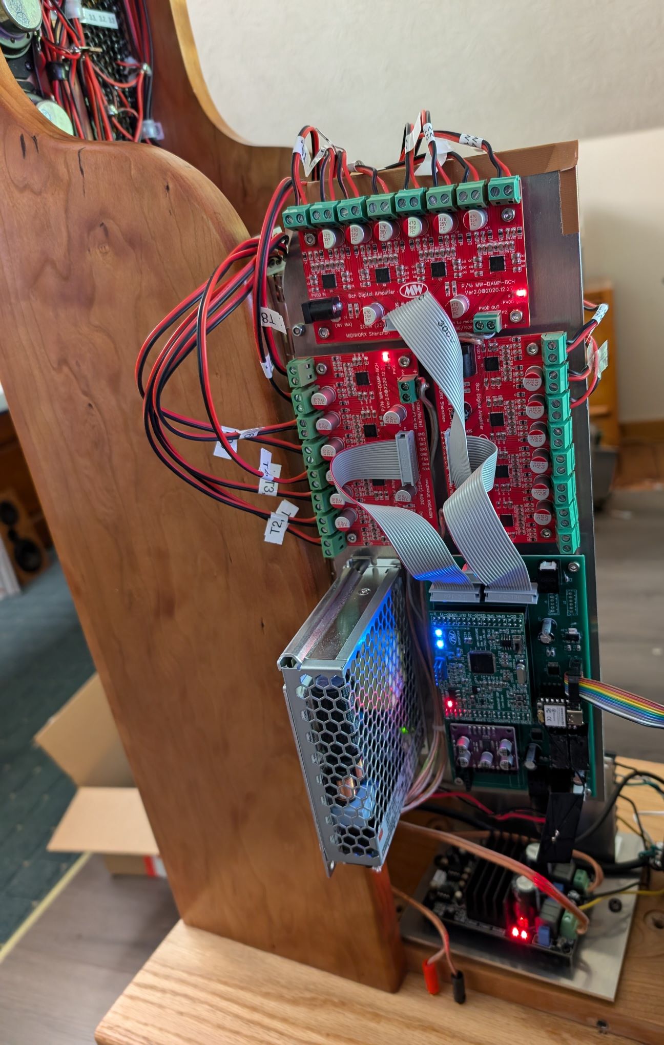

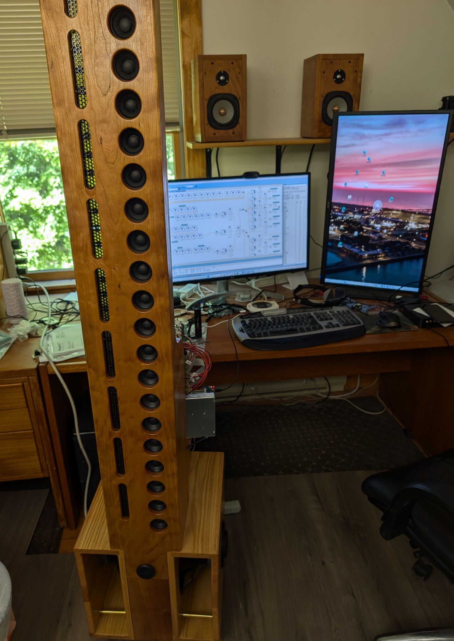

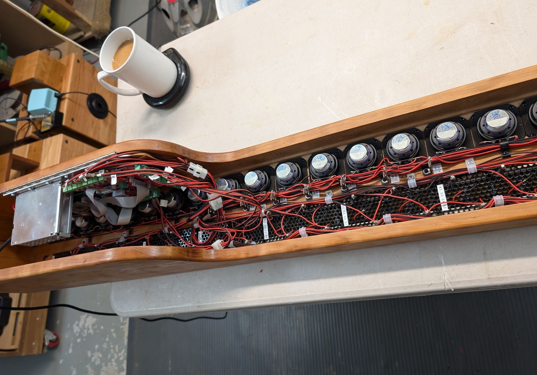

Lots of very tedious wiring. Total of 48 tweeters connected to 12 amplifiers and 28 woofers connected to 7 amplifiers.
It's alive!. It's now on the software development bench, where it is working as a 3-way without the shading or curvature. I should be able to reuse most of the code from the previous line array design to implement the electronic curvature and shading. It also needs dipole compensation since this is open baffle. The second one for stereo is still on the hardware bench. Putting the electronics on a hinged plate is working out well for development.
That’s a way cool project, Neil. Congrats on first sound!

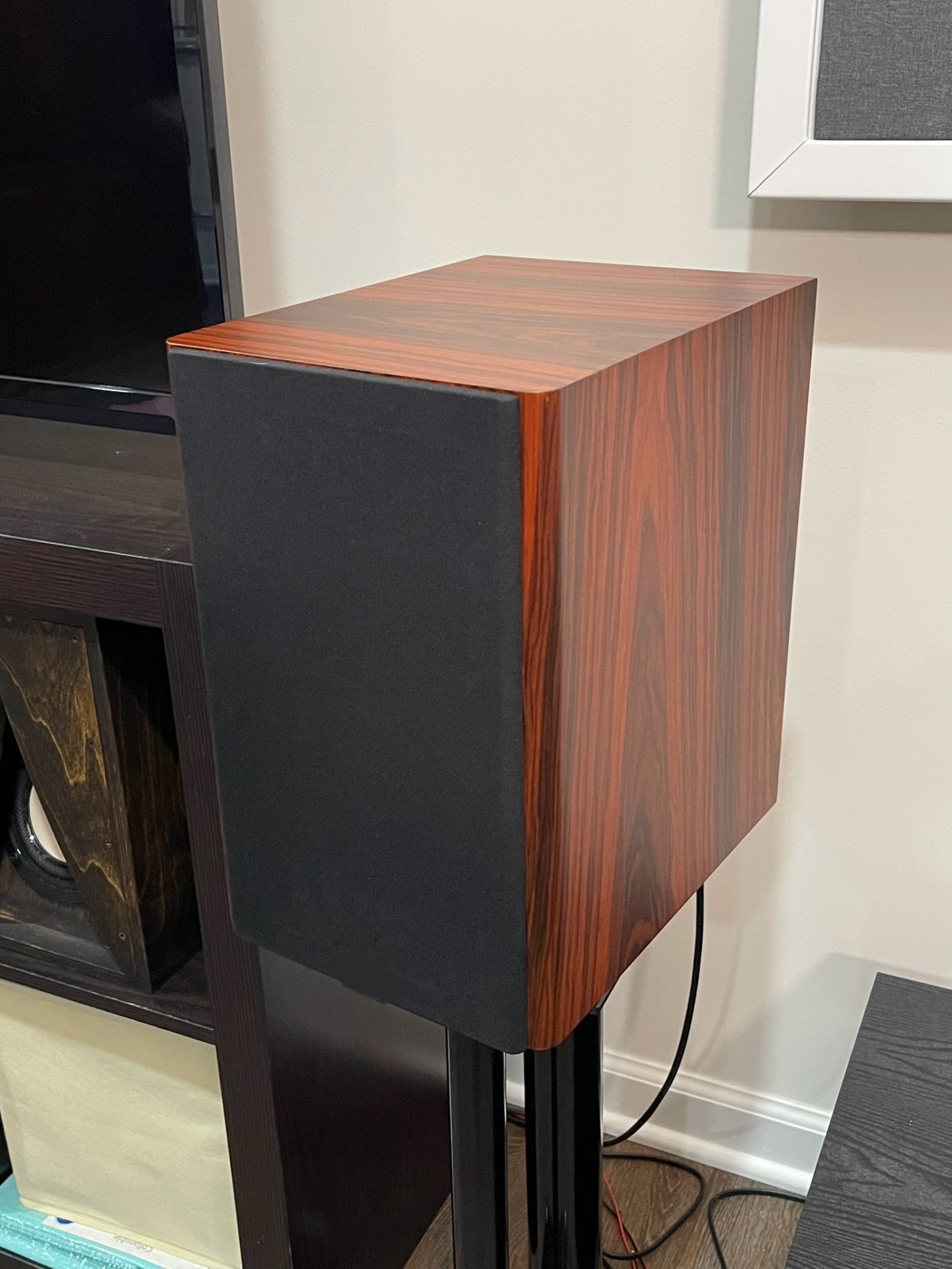

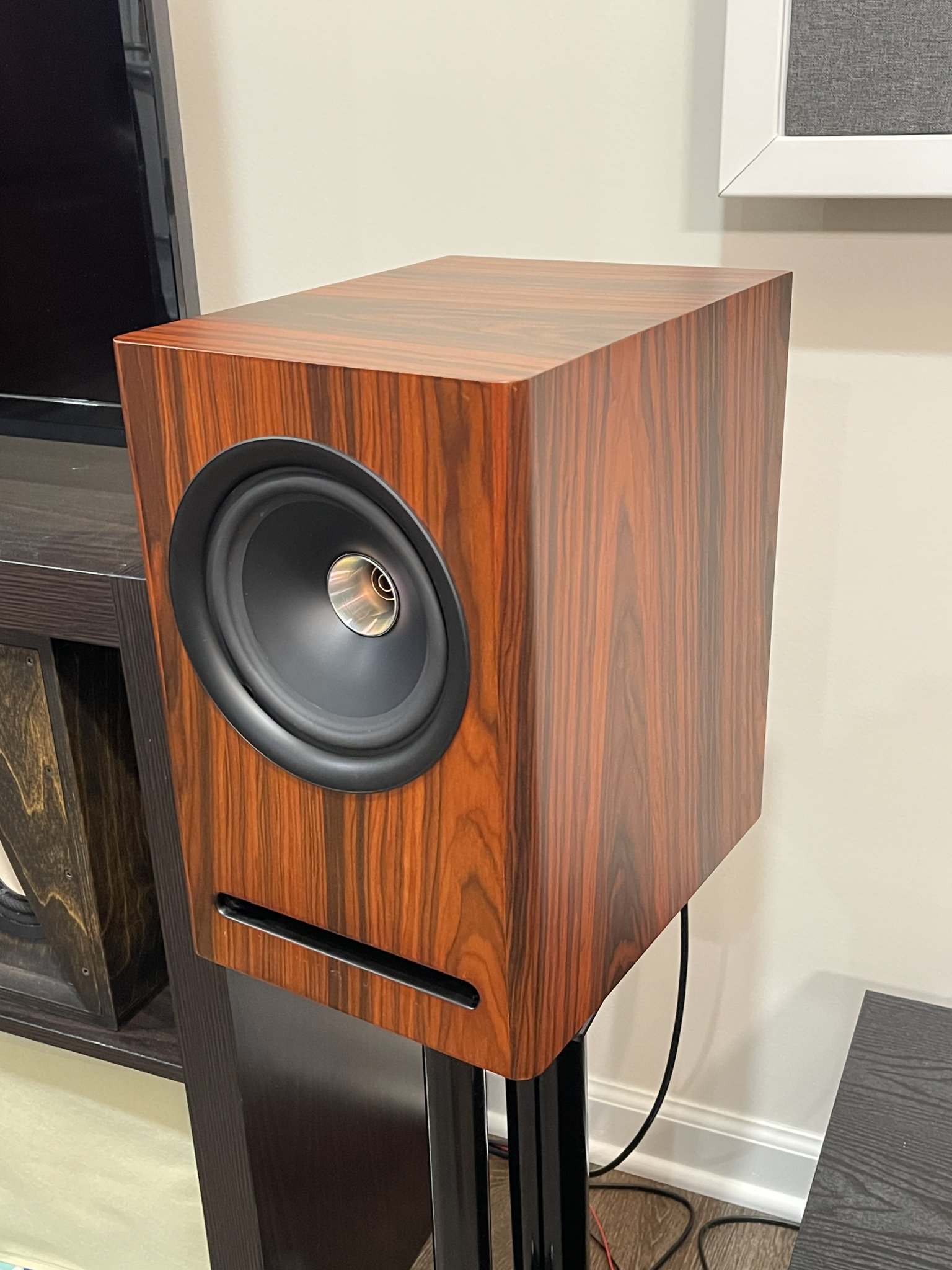

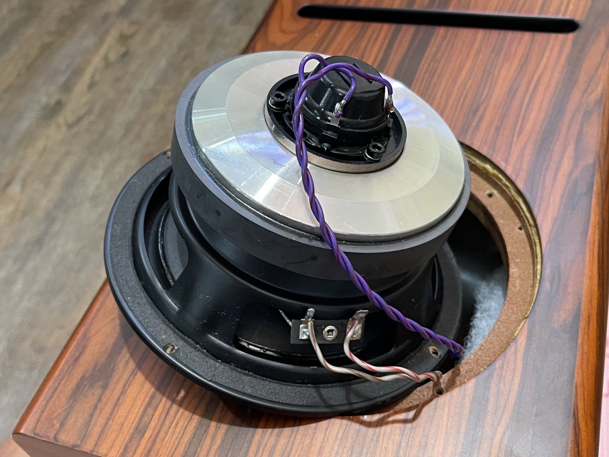

On the bench tonight is a new coaxial speaker development I am starting. It’s an OEM design with a polycone woofer and a small compression driver with a small horn. The woofer has a nice magnet and sounds very smooth. Tweeter has nice upper end reach. Cabinet has usual perfect rosewood veneer and a slot vent reflex. I’ll be making measurements and developing a new crossover soon. This will be fun to see if I can make a time aligned single point source.
There’s a magnetically attached grill.
