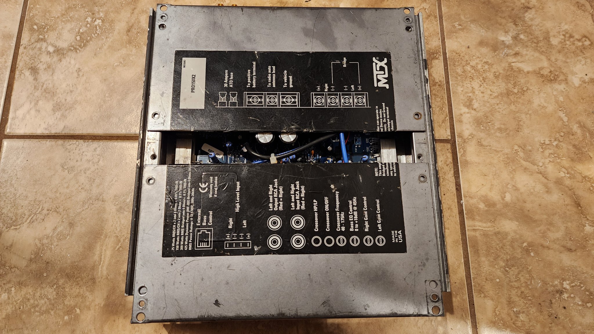

Friend of mine dropped this car amplifier. According to him one channel sounds muffled. I have not got very far, only hooking up 12Vdc regulated supply to it. Without any speakers i measure similar dc on both channels. One thing i noticed that there is discrepancy between legend on the cover and actual speaker wiring.
Please see pic. According to cover, grounds are in the middle, live wires flanking.

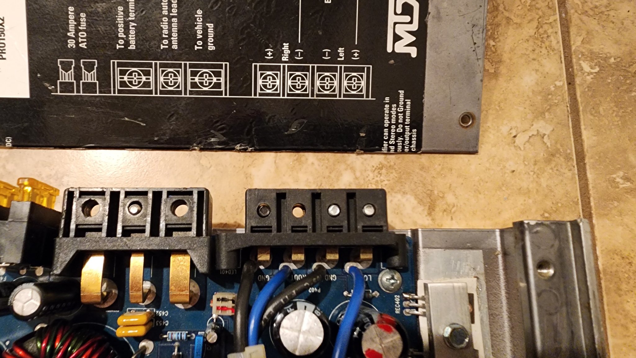

But inside the amp has alternative live/ground arrangement.
I measured (with amp turned off) connectivity, those two black wires for speaker ground are connected.
It seems to me that amp may be ok, just when he plugs it into crossover which shares ground between channels, it will not work properly.
When separate wires goes to speakers, it may work, but one will be out of phase. But in the car with multiway speakers with common ground for crossover, this will not work.

It looks like they wanted to make it straightforward to use the amp in bridge mode, so inverted one channel. Stuck with that decision then they stipulated that the stereo outputs are "floating" and need wiring without any "common" element. By flipping the +.- designation on the inverted output, the independently stereo wired speakers end up in phase.How is this possible?
Your friend is stuck until he fully isolates his L/R crossover elements. No wonder he gave it to you to figure out! Tricky-tricky...
Yup, just like in many classD amps, avoid connecting grounds together.
This is not classD though.
You are right, that's whats going on. Amp works fine as long as speakers do not share ground.

I got more details from friend. This amp is for his boat, small fishing vessel. I gues this, and crossover goes under dash. He has short wires from amp to crossover, then separate wires to tweeters and woofers. The crossover inside must have common ground. That's an issue. It would not be, if this amp would not have this inverted channel.
Anyway, i offered to rebuild the crossover.

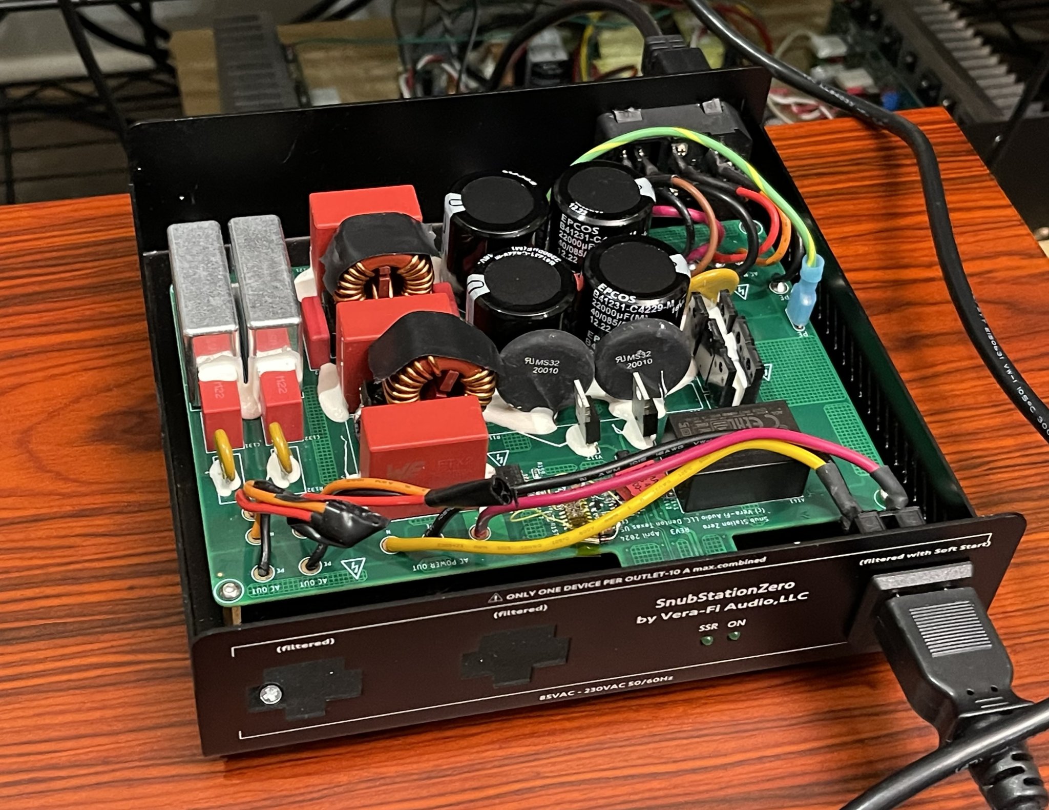

I haven’t been on the bench much lately. But finally getting to test the Vera-Fi Audio Snub Station Zero (SSZ). SSZ is a unique power conditioning product that provides DC blocker for the mains, an automatic solid state relay Soft Start circuit, and a high performance EMI filter.
I am very excited about the automatic soft start because it allows one to install this product upstream of an amp that uses large linear transformers. If you have ever heard a transient mechanical buzz or “burp” coming from your amp when you first switch it on, that’s the mechanical sound of the copper windings getting mechanically stretched when the 20x higher than nominal current rushes in to magnetically charge the large ferrite core. This stress stretches the copper windings and with enough cycles, can break the copper trafo winding wires and fail.
SSZ uses a precision Hall effect current sensor to monitor current flow real time. The current flows through two NTCs to limit the in-rush. When the current demand is sensed, the NTCs are bypassed about 6 seconds later - allowing the trafo to slowly charge up.
Here is the pre-production proto under test. There were some minor issues which we caught and fixed for the final product. But it’s working very well.
I connected this to a large commercial Class AB amp that has dual 400VA toroidal trafos. This amp makes a large burp sound when switched on and triggers a brownout warning on the power distribution panel. With the SSZ in place, turn on is absolutely quiet and smooth.
There are two outlets (not shown connected) that do not have soft start feature for smaller components like preamps and DACs. However, the DC blocker and EMI filter are still provided and for the smaller outlets, premium German made Schaffner EMI filter modules are used. Quality premium name brand parts are used throughout, including 22,000uF EPCOS electrolytic caps and Wima film caps.
