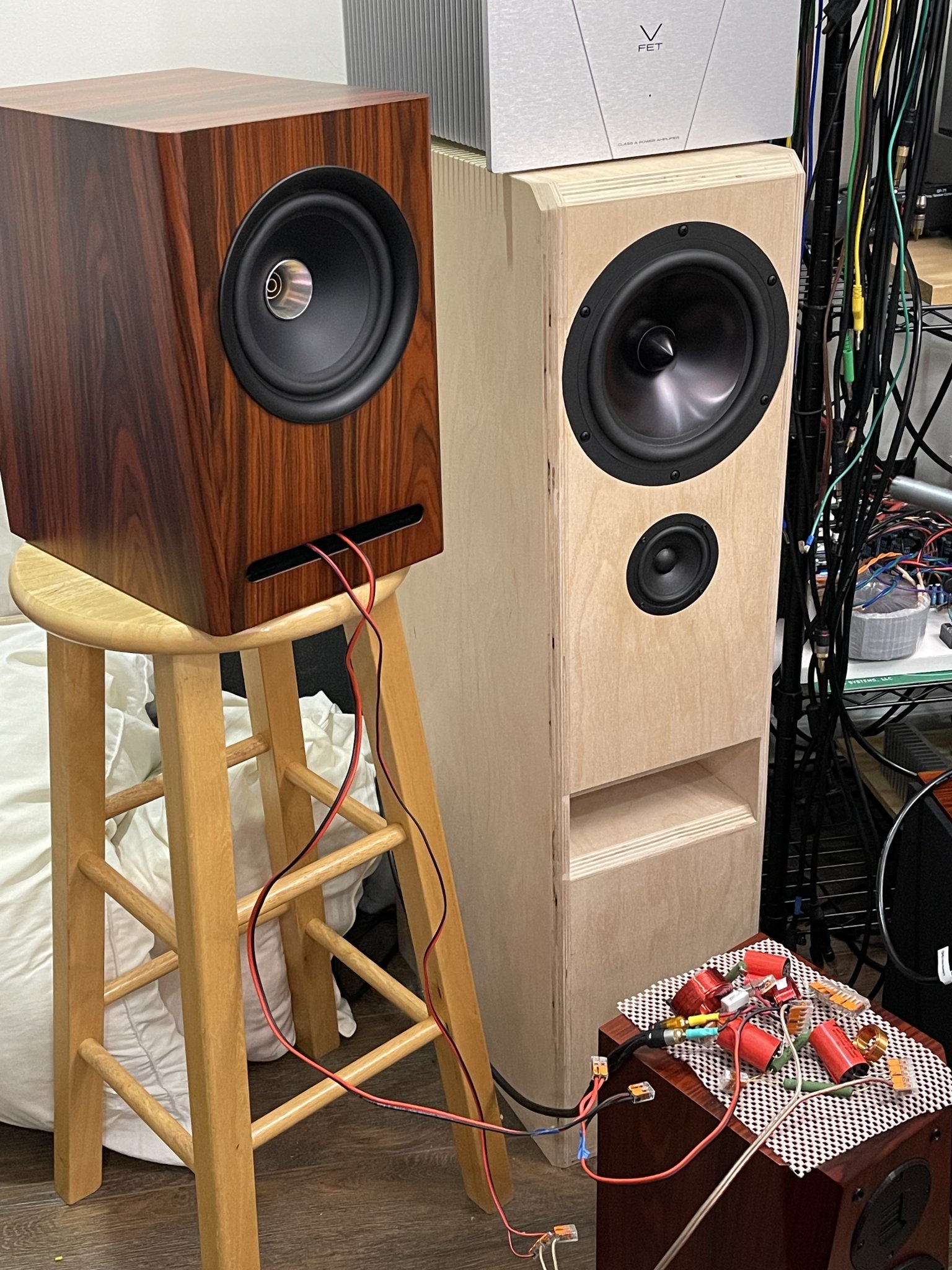

I slapped together two crossovers for some speakers I built a while ago (previous post).
Had them playing background music for most of the afternoon today. They are a little boomy compared to my OB main speakers, but sound great for haphazard futzing. Working title for the design is Beveldere. :clown:
Nice work! Those cabinets look familiar! 🙂
What woofers did you end up using?
How did you adjust the lu vds?
I didn't. :deerman: I just left it where you set it. Nice looking speakers you have there!
SB16PFCR25-8 are installed now. I also have some Sliver Flute W17RC38-08 to try. Probably in a second pair of those cabinets with a different tweeter, and ported instead of passive radiator... :smash:

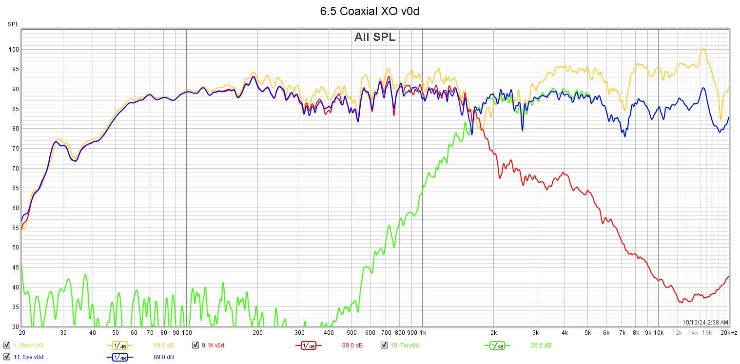

On the bench last night was a new 6.5in coax speaker crossover development.
The new crossover is sounding pretty great. The transients are crisp as the step response is a right triangle. This, coupled with coax point source means the imaging will be fantastic.

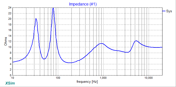

Easy to drive impedance.
Step response:
Pretty nice bass too. The highs are from a small horn loaded compression driver (with a phase plug).
