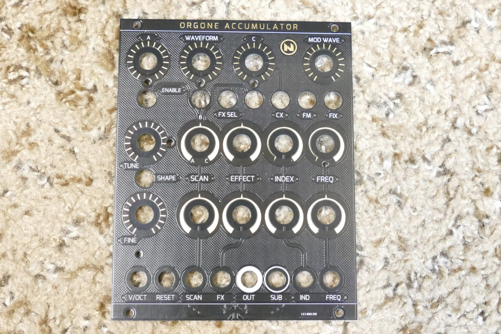

Here is a picture of the faceplate for one of the modules. It is a PCB with gold runners, and white silkscreen. I plan to try this on some of my own module designs. Blue, white and gold looks nice too, but some blue solder mask fades pretty quickly under UV or sunlight.

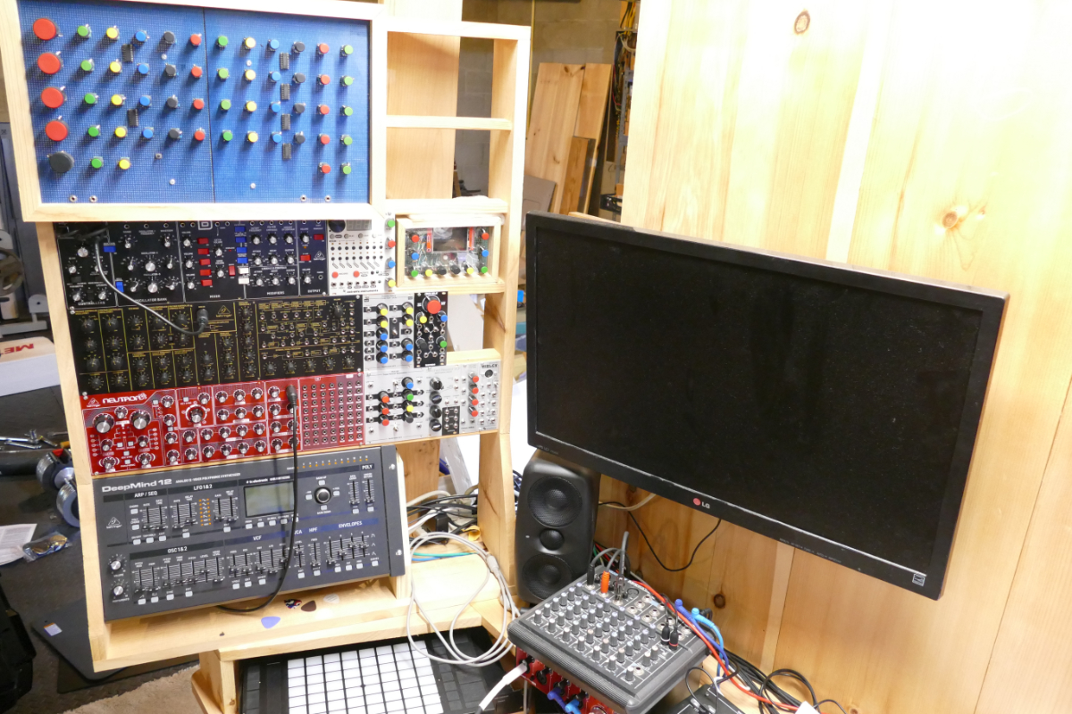

Now I'm building a mix and match collection of analog, digital, and mixed mode synthesizers. Some even have vacuum tubes. Here is a picture of the incomplete modular. Some of the "modules" are Behringer clone synths, and the two with wood frames are DIY digital synths of my own design. Both are Teensy powered. "Blue" is a digital mono synth, and the tiny synth to Blue's lower right is three synths in one small battery powered box, each with 6 voice polyphony.
On yet another bench is a pile of Eurorack modules, each in some stage of partial assembly.

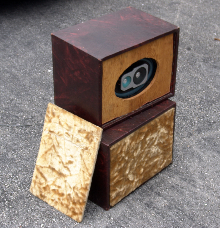

Did I make speakers in the mid 70s? Again, trash was involved. The materials used were from the dumpster behind a bean bag chair and waterbed factory. The drivers came from the going out of business sale at a local K-mart. After finding them in the warehouse cleanout, they met their fate at the hands of my guitar playing. That old blue foam surround didn't last long.

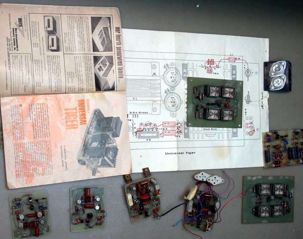

Working at Motorola got us free silicon just by filling out a sample request form. In the 70's we cloned every SWTPC "Tiger" amp that existed. We cloned the SWTPC computer too. The date codes on those MJ802's and MJ4502's reveal that they are from 1973.

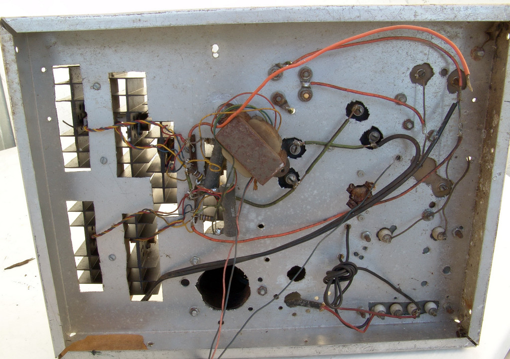

Realize that I built this at age 16 with only a hand drill and a nibbling tool. My construction practices have improved slightly in the 50+ years since then. You are looking at the better side in the previous post. The underneath is a bit uglier. This amp probably last saw power in the mid 70's. It had been stashed in a non climate controlled warehouse in south Florida since the early 80's.
This is far from a class A amp. It used the transformer driven totem pole output topology that was commonly seen in 1960's solid state amps. I wound the driver transformer myself on the core of an old filament transformer. The amp ran close to class B, but saw duty as a guitar amp, and as the PA for a rock band, hence the cooling requirements. For guitar amp duty I drove this "booster amp" directly from the speaker output of a 5 watt DIY vacuum tube guitar amp. For PA duty the driver was an old vacuum tube Bogen PA amp, or a Fender solid state PA amp.
The enclosed schematic from an old RCA transistor manual (I think) shows the basic topology I used. I did not have a split supply, so I used the two black caps to feed the speakers. The transistors were NPN silicon parts so the polarity is reversed from the schematic. Depending on intended use, sometimes I slowed the blower down by running it from the power transformer secondary which was 75 volts.
