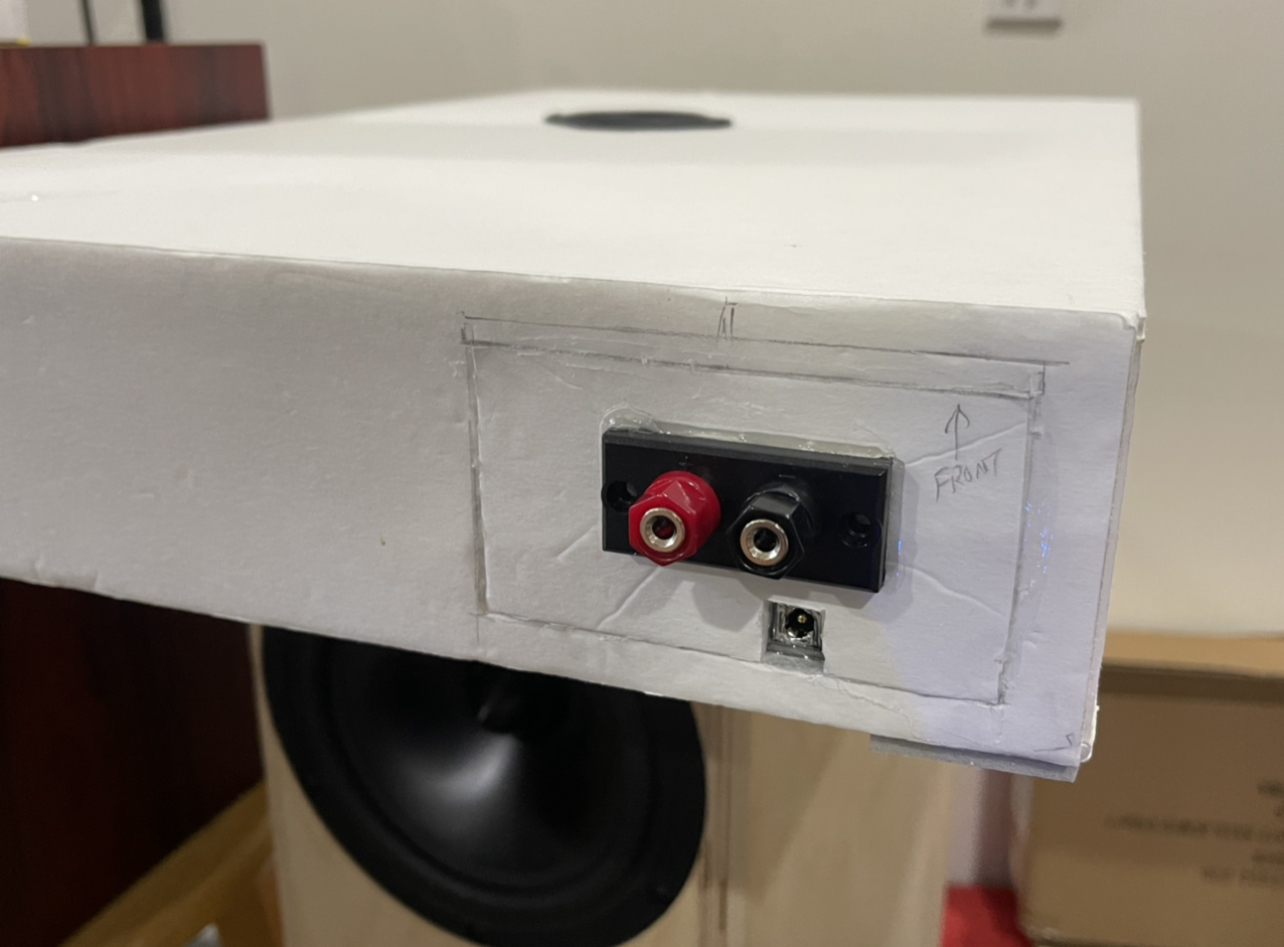

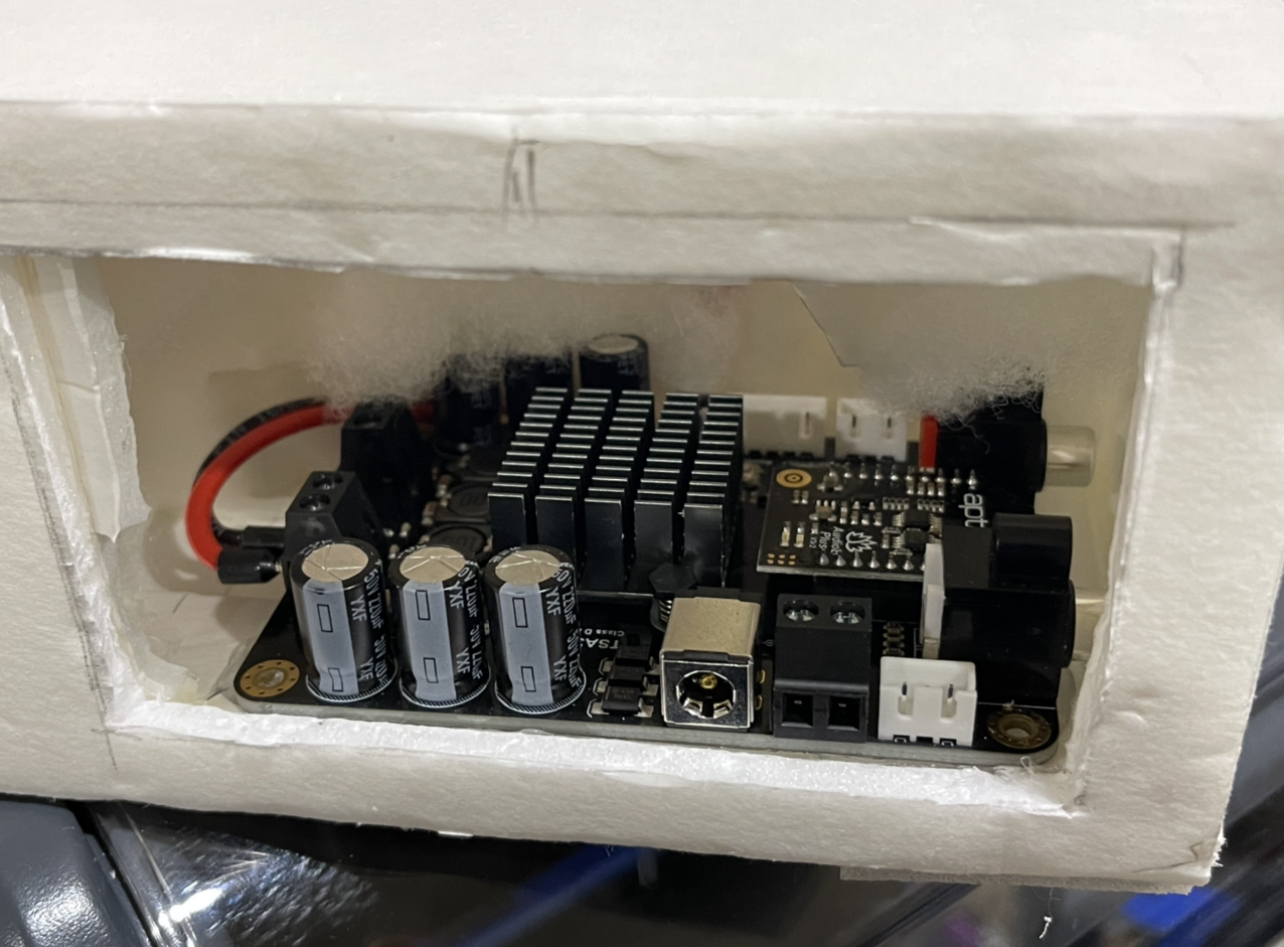

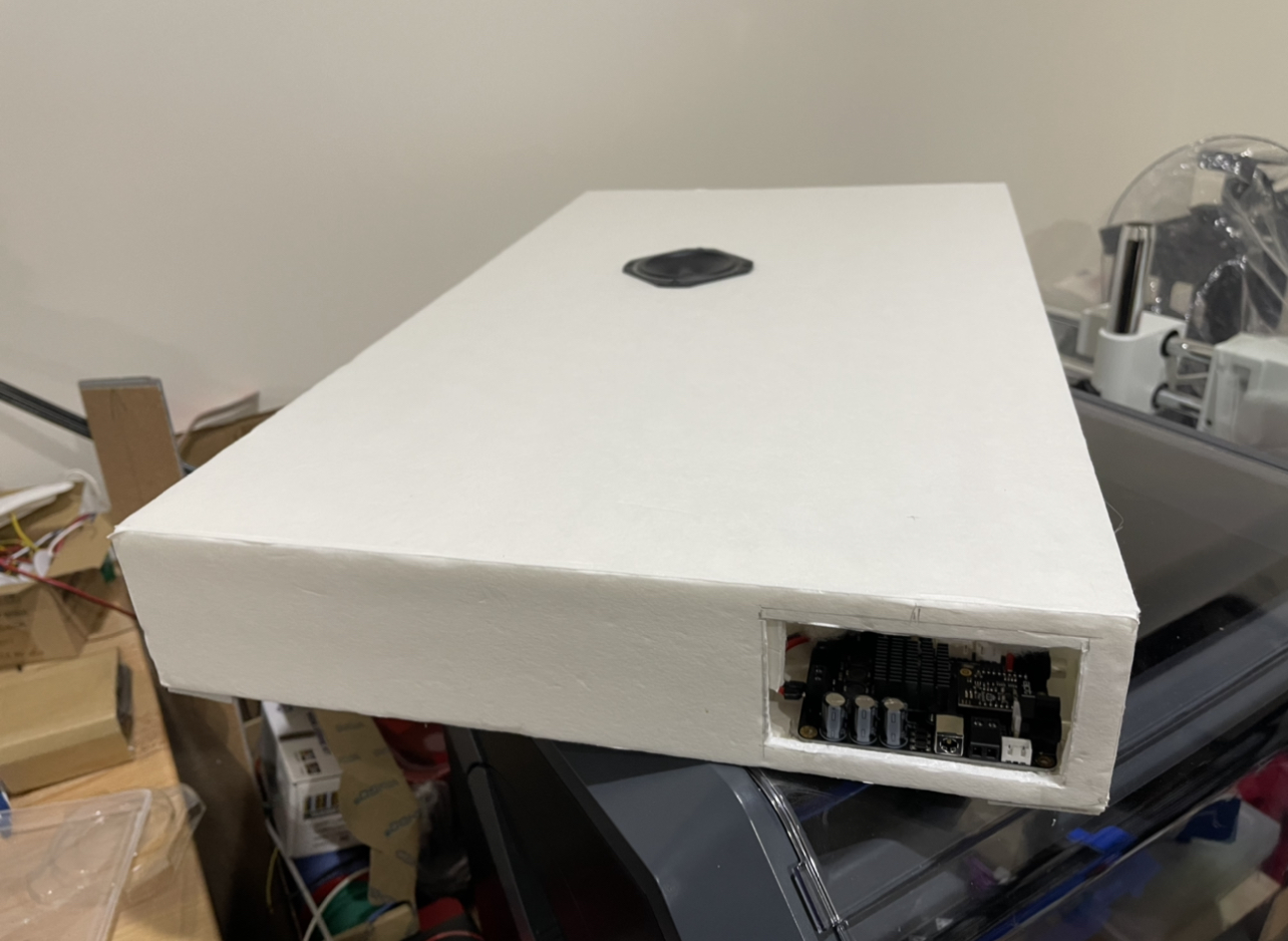

On my bench was some foam core surgery to install a TWS Bluetooth amplifier in foam core speakers I made nearly 8 years ago. They still sound great.

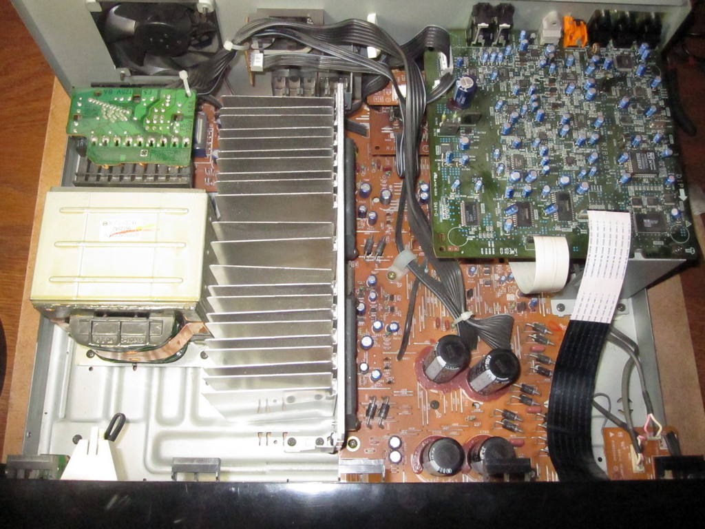

Had this on another 'bench' - actually the dinner table doubling as office desk - with a pesky 'overload' condition. That happened right after several blocks in my area lost one phase of AC mains completely.
We heard the relays clicking incessantly and then that fault developed.
Cleaned it up a little. Attempted a reflow this morning, but no go: slight burning smell and an orange spark near one MOSFET module, near instantaneous 'overload' condition, so that's it for this beauty.
Too bad the modules are expensive. I'd rather not continue to work on this and instead recuperate anything worth salvaging. It's quite an old design, a receiver but with no HDMI, but the sound was rather good - MOSFETs, Class H+ modules.
The transformer has +/- 48V and +/- 24V if I'm not mistaken. It's heavy.

Is that a Yamaha? I have an older Yamaha receiver and the trafo and heatsink look very familiar.
It's a Panasonic, as second-hand I bought cheap, without remote and an issue with the main volume pot. A lot of those older receivers are built similarly, and not just the Technics ones which belonged to the same manufacturer. Some of them have the transformer in the middle and two rows of large transistors on large heatsinks on the side. It's always interesting to have a look inside of them. The older Yamahas have a very good reputation.
I had found another one left on the sidewalk here, so I salvaged from that but didn't think of keeping the MOSFET modules or else I might have been able to fix it. I did have a look inside the modules. Some people call this an IC, but it's a small PCB with several components in them and encased.
I like the transformer. I have two of them so I could make an isolation transformer out of them, or else just use the two of them individually for two audio builds. The speaker terminals are really nice as well. There are a few large diodes I can re-use for power experiments, probably a few other components to salvage.
That’s too bad about the mains causing your equipment to fail. Would an AC protection circuit like a Furman or APC prevented this?
Probably, although I am not sure since no other gear has been affected: computers, game console, 4K Blu-ray Player, etc...
I will still get one as the local mains distribution is notoriously unreliable, especially during big winter storms, and a new modern receiver with Atmos is being eyed and that's quite a big investment.

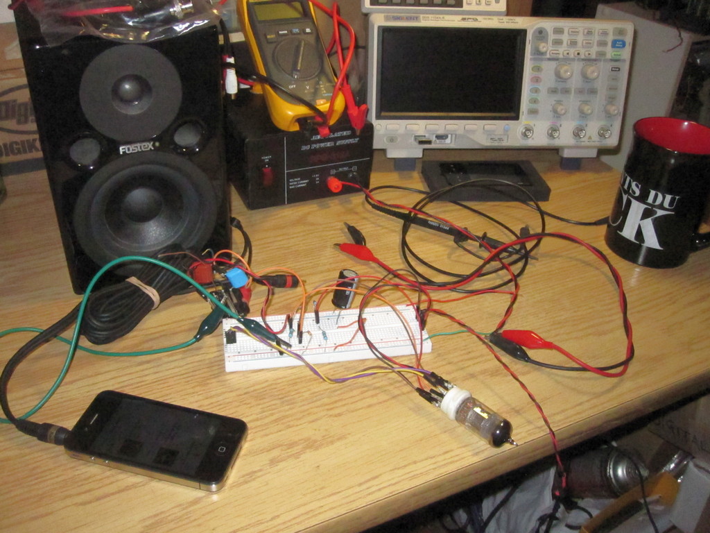

On the bench tonight was my small tube at low voltage experimental platform, to which I added a MOSFET buffer. Many of the configurations just distorted too much at around 70% of the iPhone volume, but after some more tweaking of resistor values here and there, I managed to get something interesting on the earphones. These are cheap and slightly 'shouty' earphones for testing. I tried on the Fostex bi-amp monitor at low volume too and it sounded good. Couldn't do higher volume testing as my gf is sound asleep
Rummaged through parts bucket and set aside transformers for higher voltage tests. Also found some high-power resistors to go with these HV builds, If not, I'll do some parallel or series-parallel or what not to get what I need and as last recourse, some orders could be sent.
Some common tubes are out-of-stock in some places. Supply issues don't affect only Solid-State.
Also salvaged some good RCA connectors from old gear, some caps and more.
Satisfied with the progress tonight.
