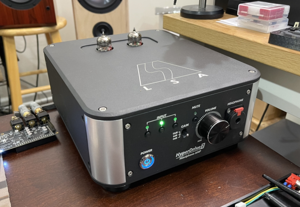

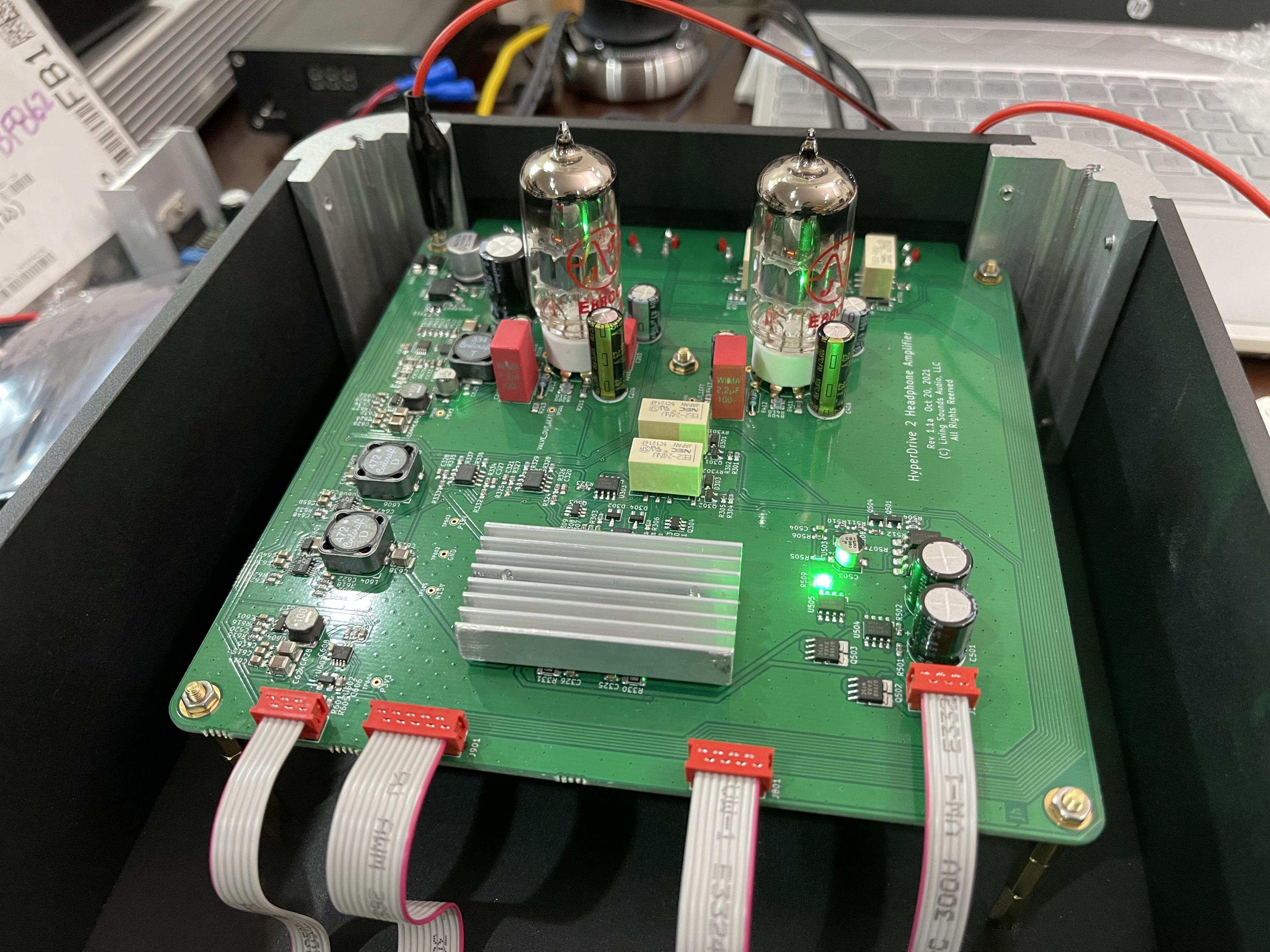

The production run samples of the HyperDrive-2 headphone amp (PCB assemblies and chassis) arrived for me to check final fit and operation. Looking good! The IDC cable assemblies came out perfect and give a clean and robust connection between the front panel and the main PCB.
I really like these chassis for the LSA products - very attractive finish yet minimalist too.
One thing I do not like is the TRS Jack with the locking mechanism - i have seen far too many headphone amps dead short and fail.
Short because of the latching mechanism? It’s only a physical lock to keep jack securely in. It’s friction so if you pull hard enough the plug comes out. I don’t think there is anything electrically different.
This amp has a SSR DC output protection as well as turn on delay and instant turn off mute to prevent any headphone thumping.
the latch catches and it creates a short to ground. The output protection will likely protect the circuitry but many an amp was suffered due to inexperienced users - high volume , attempts at rapid switching - completely a user fault but it only exists because of the latch. I have just been around the headphone world for a while and have seen most everything people can do to cripple an amp with a TRS jack 🙂
that said, many commercial amps still use the jack.

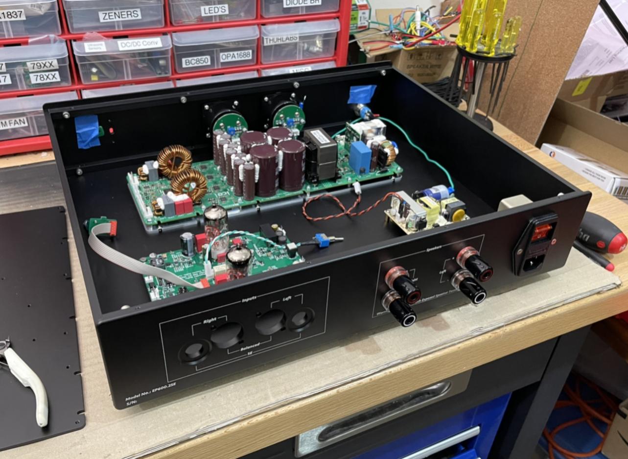

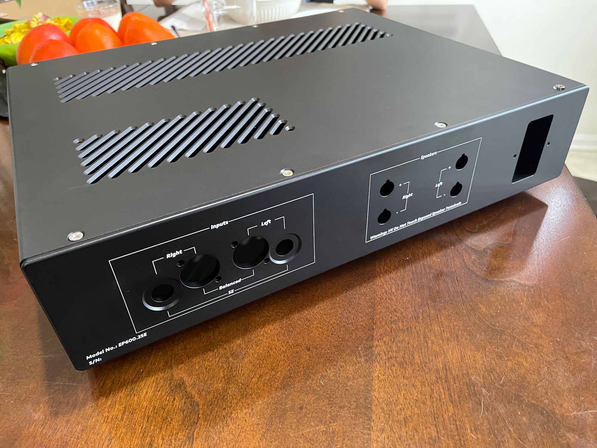

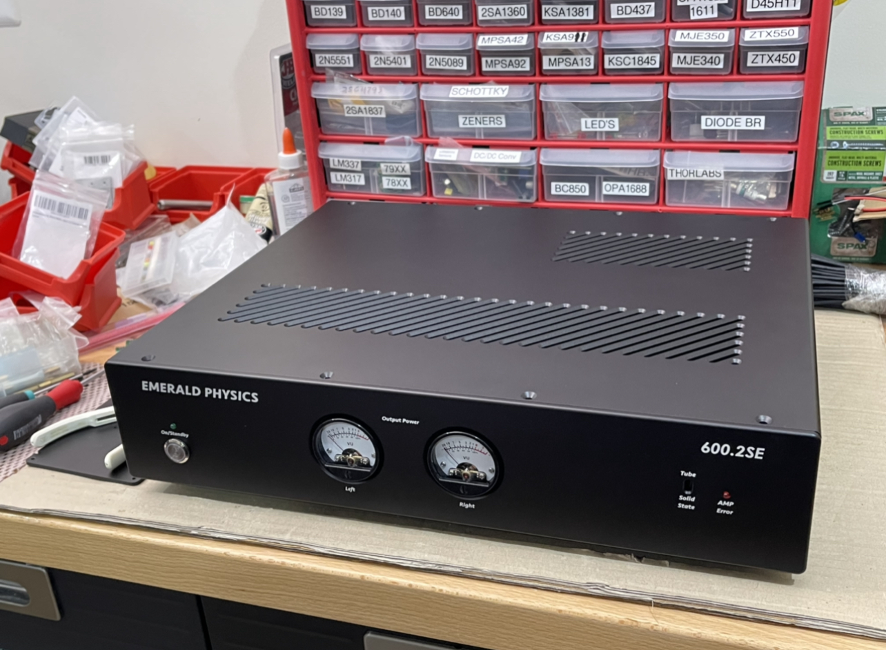

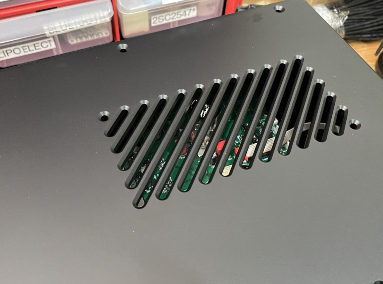

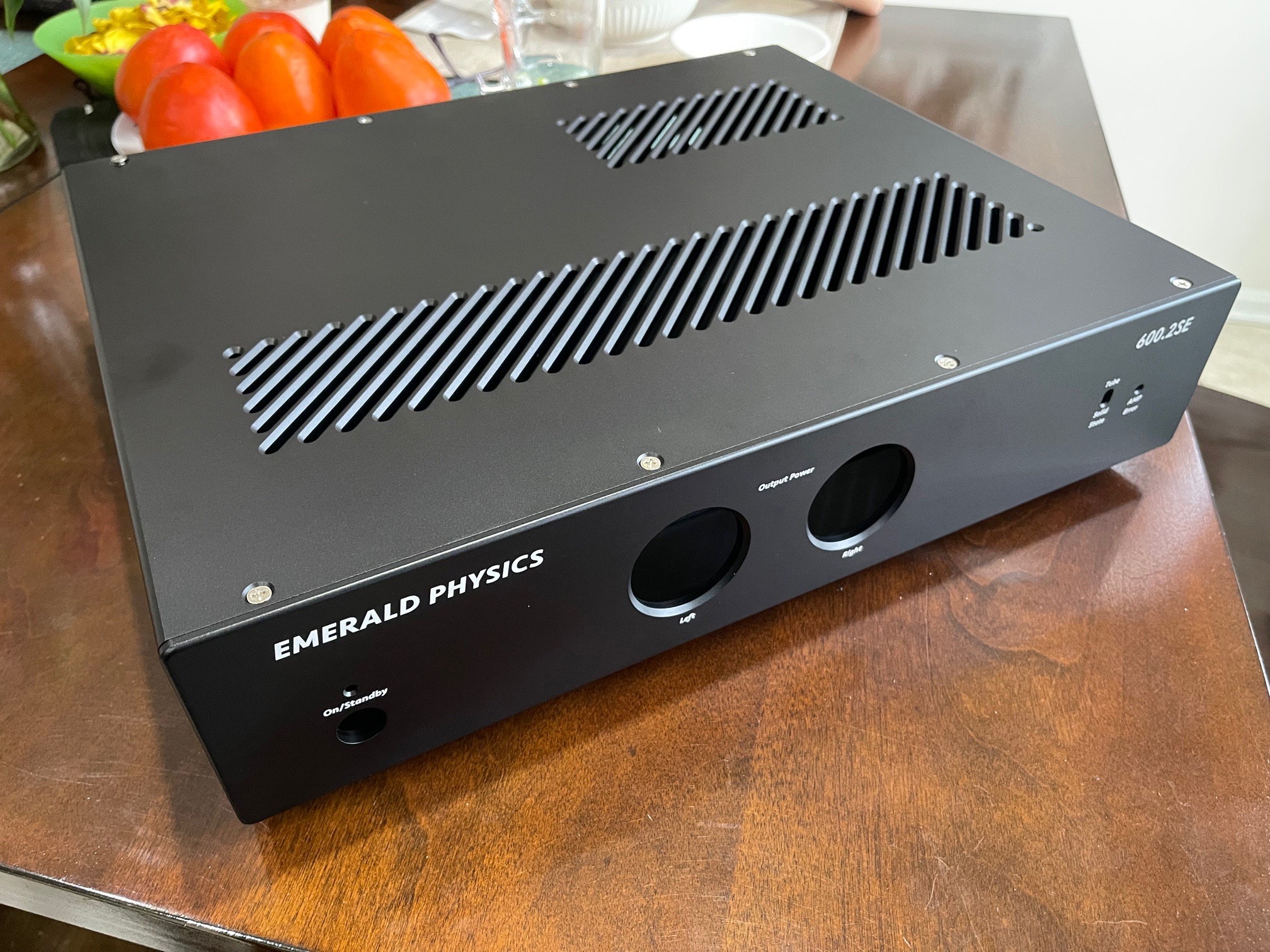

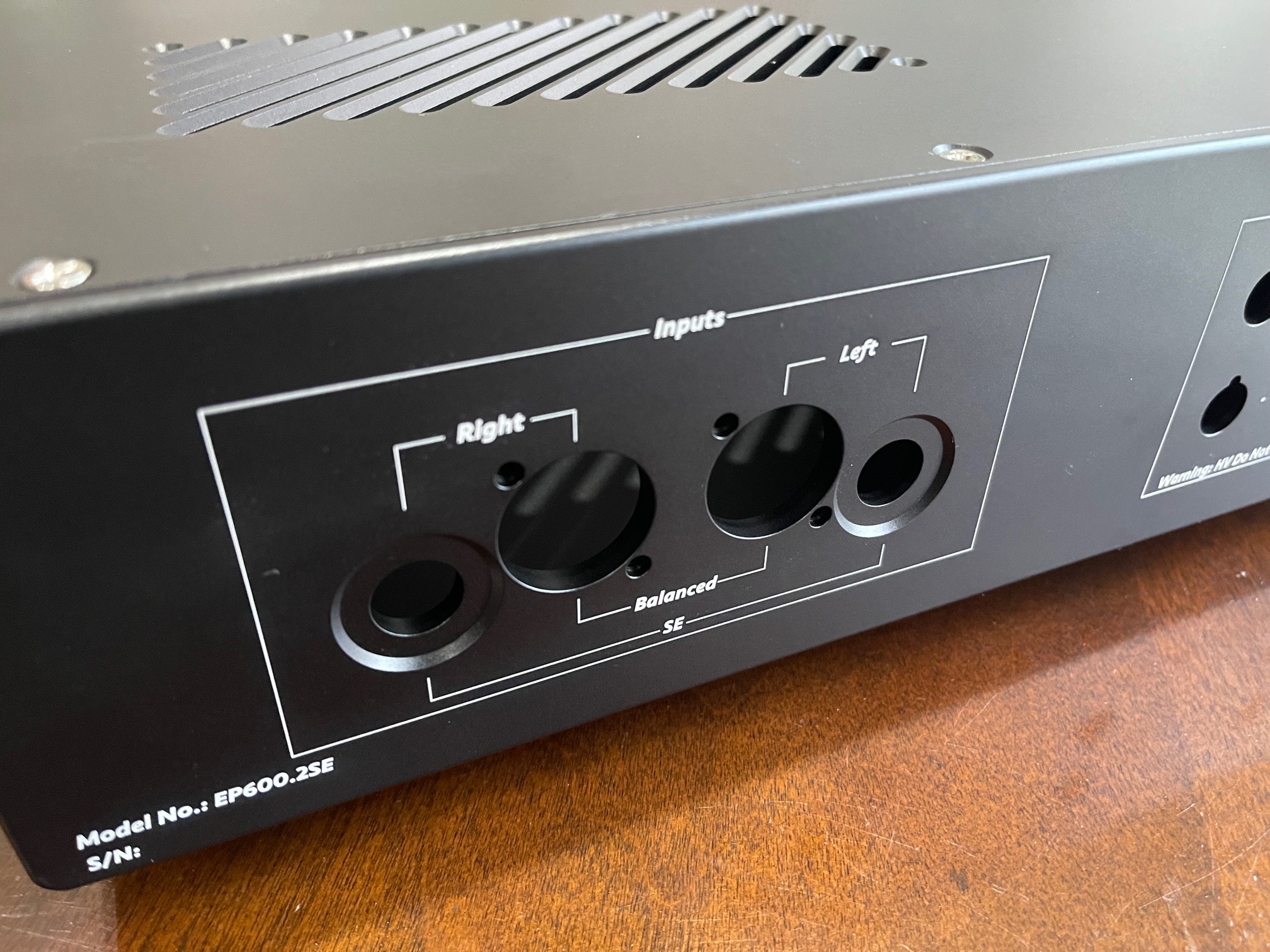

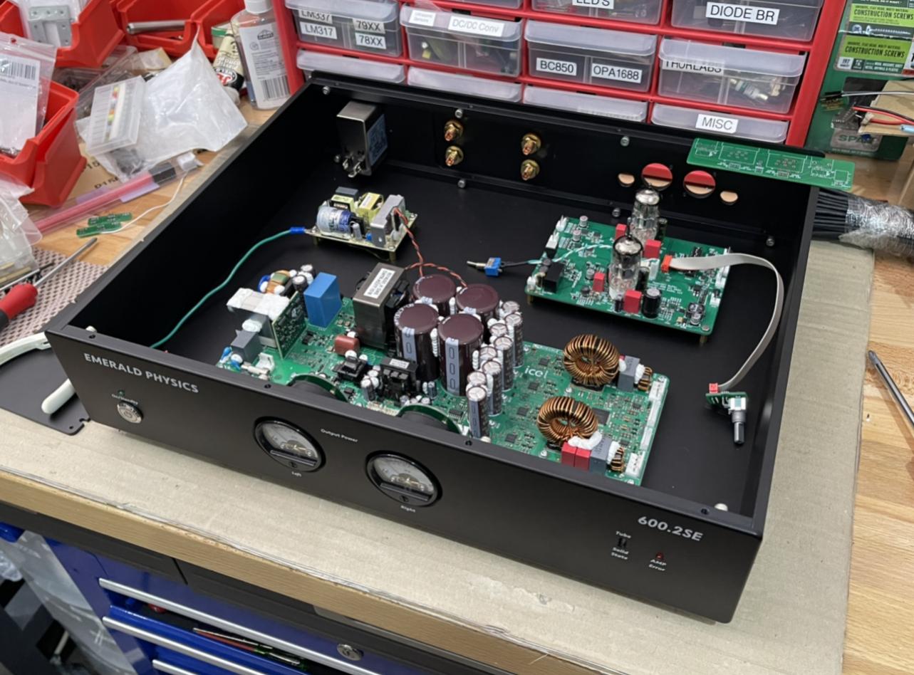

Also on the bench tonight, the new sample chassis for the Emerald Physics 600.SE2 amp just arrived. It’s gorgeous. Completely CNC’d from aluminum then covered in a exquisite luxurious bead blasted satin hard anodized finish. The panels are thick and the amp is huge. I really like how well it turned out.

Hi JPS64,
Thank you to you for getting me turned onto the MicroMatch cables. They are the bomb for production series hardware. Absolutely robust, fast, and cost effective. It took me maybe 2 minutes or less to connect all the cables on this build.

That is a nice clean looking chassis, I could see offering chassis for your projects a real bonus hint hint. I never had an issue with those headphone jacks, all jacks short that just makes it almost impossible to accidentally pull the jack. I alway turn my amps down or off before pulling jacks out.
Thanks WW, are you talking about the headphone chassis or the Emerald Physics power amp chassis? It’s starting to take shape. I am just checking fit of the main components. The final tube preamp is slightly different and no volume pot.
They both look nice.
X, is that Emerald Physics amp have an ICEDGE module in it with a tube input stage?

Hi Anand,
Yes. IcePower 1200AS2 for 600wpc into 8ohms. We developed a custom tube buffer with balanced or SE input and balanced output to drive the 1200AS2. The tube buffer has a tube or SS switch to bypass the tube stage if desired. Tube stage is E88CC with 90v B+. All power is from custom DCDC converters. Built in logic for safely starting and stopping the 1200AS2 from pops and thumps.
The tube buffer has DIP switch selectable gains of 0/6/14/20dB. The amp had intrinsic 22dB gain so the 6dB setting gives 28dB overall, which is about perfect.
The amp is very quiet and the tube stage gives the amp a slight dominant second harmonic profile as it should from a SE Class A buffer, for a more natural sound, but still very low distortion.
I have tested it extensively as a plank amp and it works flawlessly. Never any danger of turn on or turn off pops or thumps (which is not so friendly to speakers when an amp is capable of nearly 200Vpp output).
