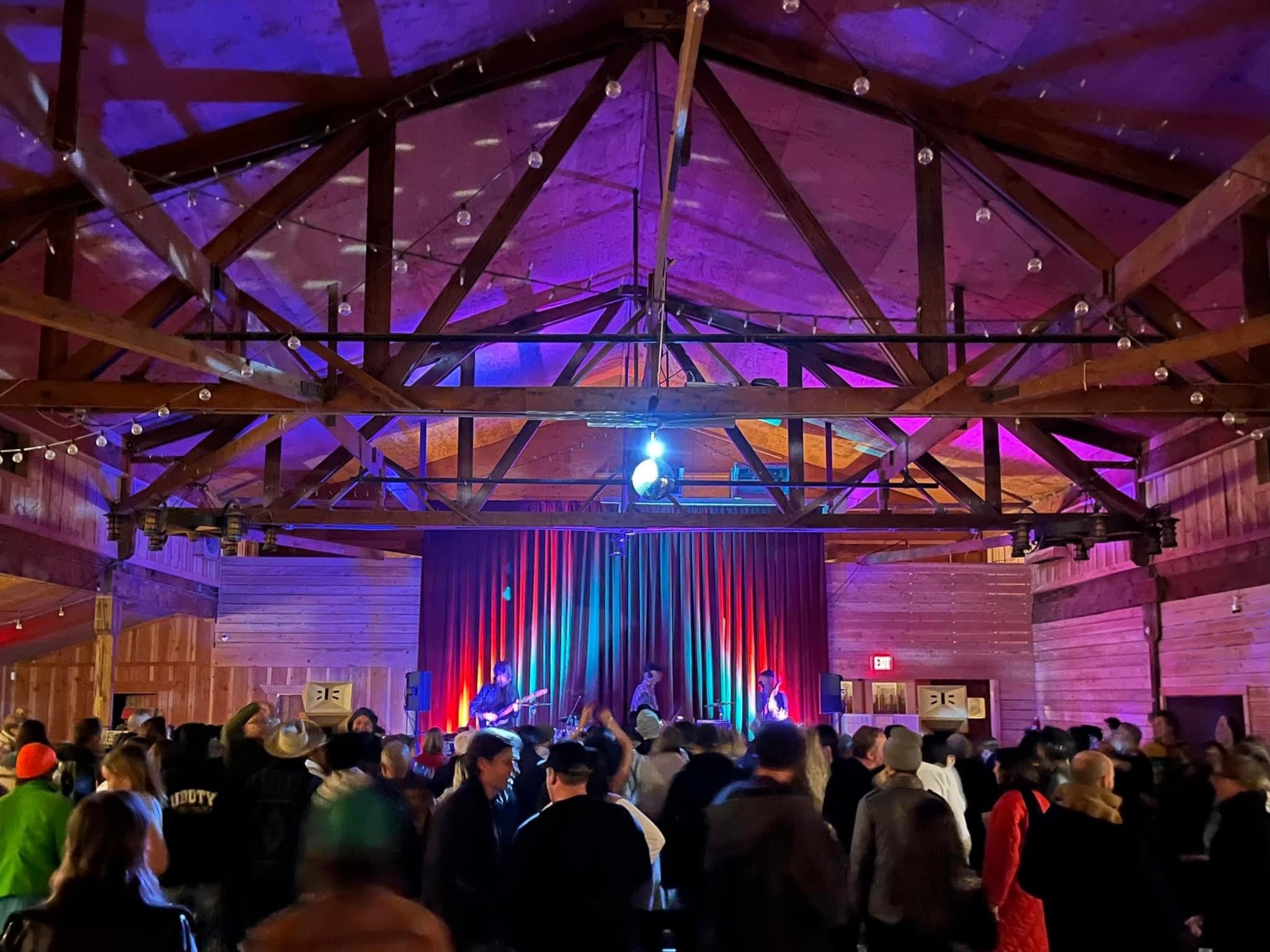

Also check out the TPL150 synergy that I helped designed at an installation for a recent event near Joshua Tree here:

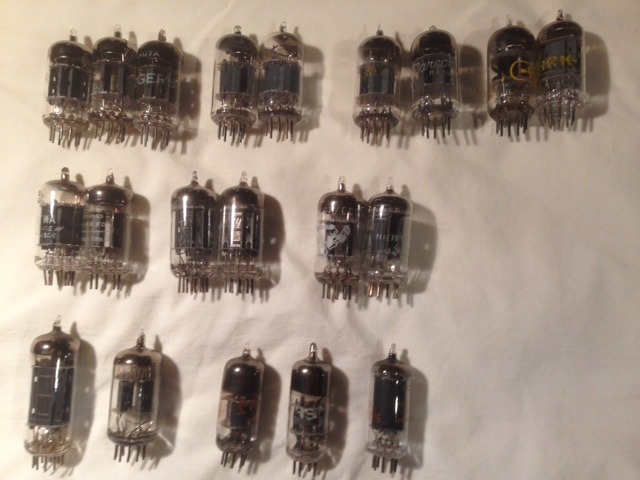

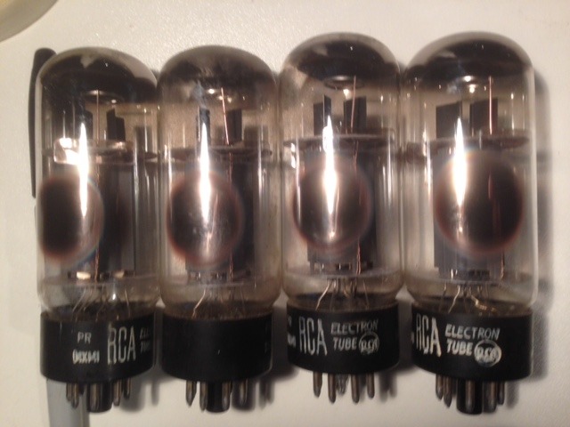

I noticed you are a tube enthusiast. If any of the following interest you, let me know. I have no use for these, so pricing is very negotiable. Most of the 12xx7 look like they have never been used.
View attachment 1005769 View attachment 1005770
The 7027 have hot spots
The 12AU7WA, !2AU7, Misc tubes, are listed below.
The 12AU7A from L>R 1st row are: (3 - Rogers Holland 9pin), (2 - No Name Canada 9pin), (1 - Sylvania + 1 - Marconi Canada 9pin), (2- Stark Canada 9pin)
The 12AU7WA & 12AU7 L>R 2nd Row: (1 - Tungsol + 1CV4003 12 AU7WA, USA 9pin), (1W... + 1? 9pin ), (1 Amperax + 1 RCA, 9pin)
The Misc. Tubes 3rd Row L>R : (1 - 12BH7A, Canada 9pin), (1 - 12AX7A, Canada, 9pin), ( 1- -Marconi 6CB6, Canada, 7pin), (1 - Rogers 6Bz6, Canada, 7pin), ( 1 - RCA 12AU6, USA, 7pin)

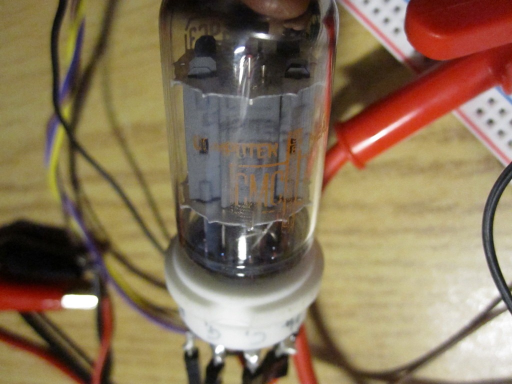

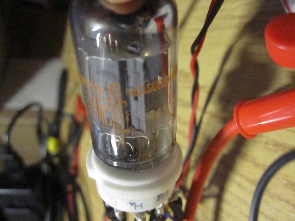

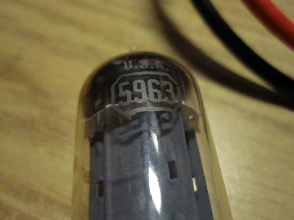

Snuck back into Lab 1 for the tube experiment today.

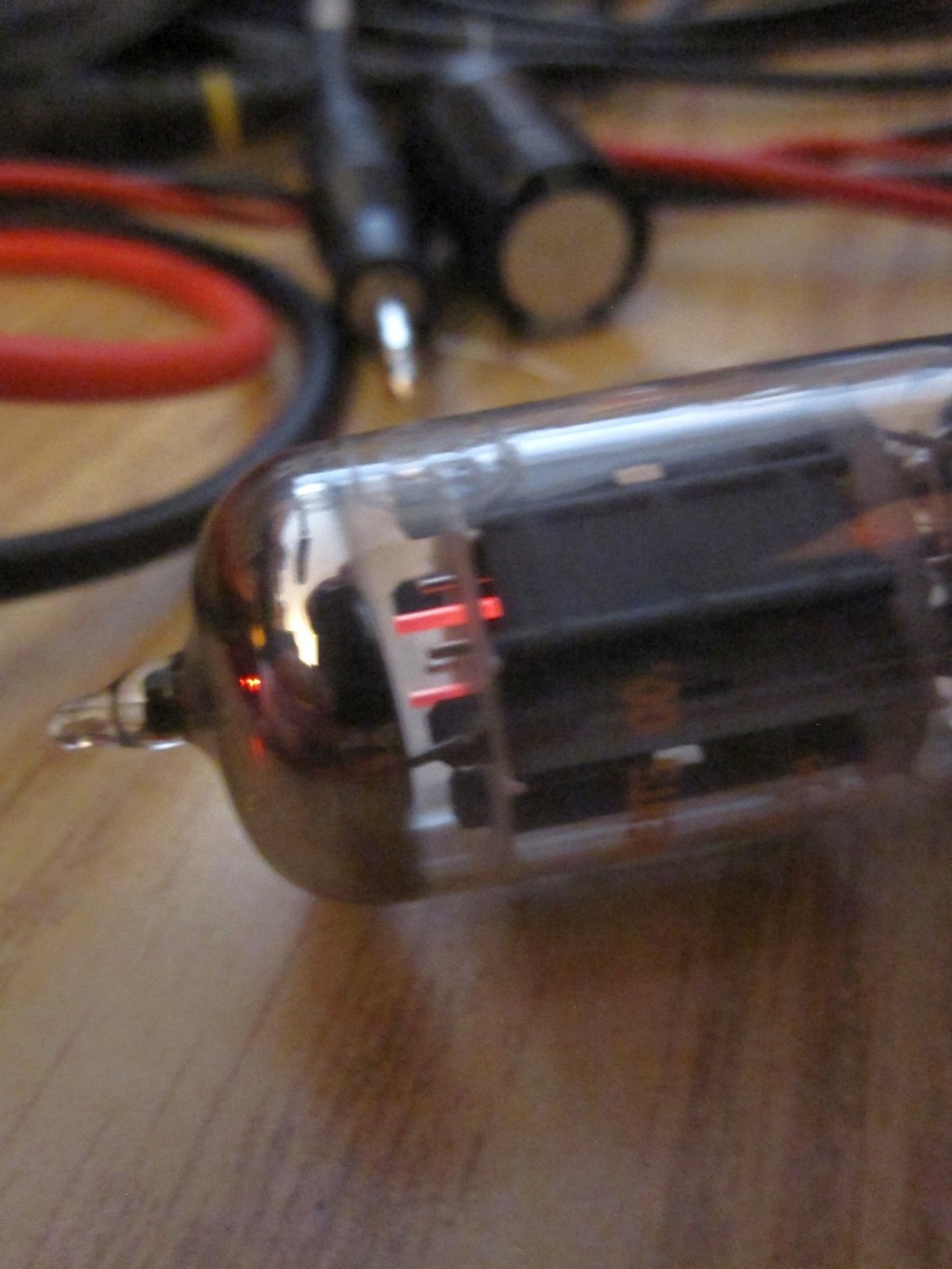

Got the 5963 in an alternate circuit to sound good, very good. Had a look at it heater because the whole tube seems quite protected by large metal plates. Couldn't see it before as I probably kept the wiring for another type of tubes, but this time I did after rewire.
That sound got me head bobbing.
12 Volts And The Truth!
The heaters, they're like little glowing red pillars inside.
The main markings: USA 5963.
You can see: COMPUTER and CMC and a bunch of numbers in a column.
'Measurement' something.
Also tested the other tubes in this circuit: 12AX7, 12AT7EH, 6DJ8 and related tubes, and all soudn very good.
There does seem to be some low level hiss. I don't know how to tame this yet. Layout probably plays a large role with that kind of response. The breadboard and flying leads everywhere doesn't help.

Tube hiss is sometimes intrinsic to tube buffer setpoints have a lot to do with it. Or maybe filament heater glowing too hot?
Red glowing pillars are outer shell, the heater wire is coiled inside...Snuck back into Lab 1 for the tube experiment today.

Thanks, it was fun.Nice Lab adventures!... Tube hiss is sometimes intrinsic to tube buffer setpoints have a lot to do with it. Or maybe filament heater glowing too hot?
Not too sure about hiss in this circuit, it might just need a lot of shielding and proper layout actually as all circuits before that one sounded without any hiss.
You may have a point about heater supply: IIRC, I used around 6V DC from P4 to P9 and P5 to P9 for the 5963 which is supposed to be related to a 12AT7 (but of course, the datasheets show that the 5963 is a tube intended for computer applications, not audio).
However, I am switching not only between circuits, but sometimes testing the other tubes I scored recently as well as the older 12AX7 and 12AT7EH in my possession, so a mistake could happen, but I don't think I'm able to erroneously have 12V go to the heaters, maybe half of 6V if I make a mistake though.
That might be the case indeed, but the 5693's construction is such that everything is hidden, you can only see that protruding part. Ah wait, do you mean I am heating something other than the heater wire to red hot?Red glowing pillars are outer shell, the heater wire is coiled inside...
