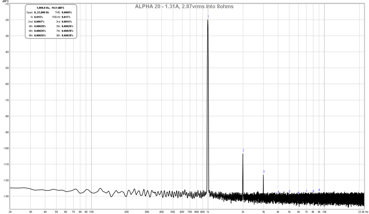

You can use any digital audio interface with REW software for a nice analyzer.
more here:
https://www.diyaudio.com/community/threads/howto-distortion-measurements-with-rew.338511/
Here is FFT of the Alpha 20 Class A amp at 2.83vrms using a $99 Focusrite Solo USB audio interface and REW.

This plot does not do anything for me.You can use any digital audio interface with REW software for a nice analyzer.
more here:
How was it measured?
What was measured?
What is dBFS? Is it calibrated to something? Is it dBV? Is it SPL?
It is just hanging out there.
Yes! I really like R.E.W., been using it for a few years now, as well as Audacity which has a nifty internal Spectrum plot. R.E.W. calibration from the soundcard is really super useful for better measurements here. It gets really better with each release.
I have three ADCs I can use: an old M-Audio which caps at 96kHz, an Apogee Ensemble and a newish Behringer UMC-202HD. The latter two can both do 192kHz (less than half that for actual Nyquist response, esp. the Behringer, but that should cover good cases). The Apogee has an internal SMPS though. I thought the Behringer had quite good isolation from USB bus power since when I used the DIY USB isolation connector and my DIY Linear Regulated PSU, I couldn't detect any audible change in sound quality.
The Behringer can be improved upon ADC-side and a member here did some great work to enhance this.
A great ADC + R.E.W., and you have yourself a setup that rivals some older AP if I'm not mistaken.
I’m just showing you an example of what it can do. Go to the thread to the Howto use REW thread for distortion measurements to find out more.
That was an 8ohm dummy load measured at output of the Alpha amp using a basic resistor divider to keep signals below clipping of the front end mic XLR input. I think I used internal REW frequency source as oscillator. Later on I use external Akitika 2ppm of Victor’s ppb oscillator. The scale is in the graph title: 2.87vrms is -20dBfs.
What was measured?
Thanks DT
I wouldn't let that stop you from trying it in your setup and explore its features.
R.E.W. is absolutely stellar analysis software.
I actually only found out about it in a Home Theater forum when I was at the very beginning of my Audio DIY pursuit: I needed a way to correct my room response in an acoustic, organic way (no DSP). I made custom acoustic panels from there.
And that's precisely the original purpose of R.E.W.: measure and correct room acoustics.
I went to the How-to reference.I’m just showing you an example of what it can do. Go to the thread to the Howto use REW thread for distortion measurements to find out more.
Okay -20dBFS equals +9.1576dBV

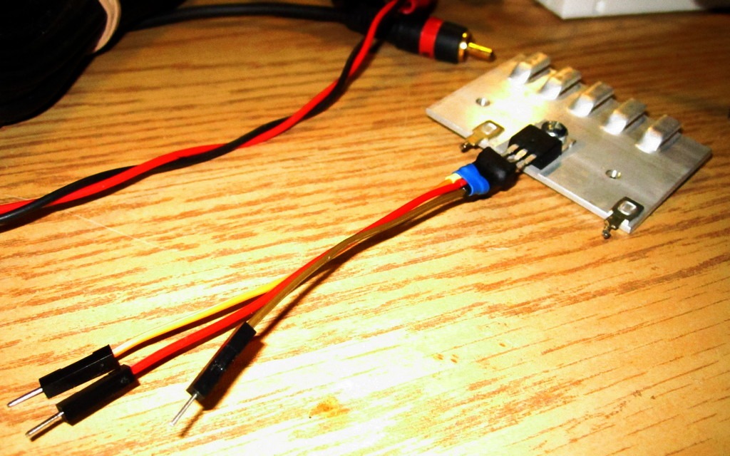

Getting serious(ly hot):
Small half op amp socket with leads for the breadboard, and small heatsink with isolated mount and heat conducting separator.
Will allow for longer testing on the breadboard with proper biasing and also allow easy swap of transistors. The heatsink can rest on the desk or on a larger piece of aluminium if necessary.

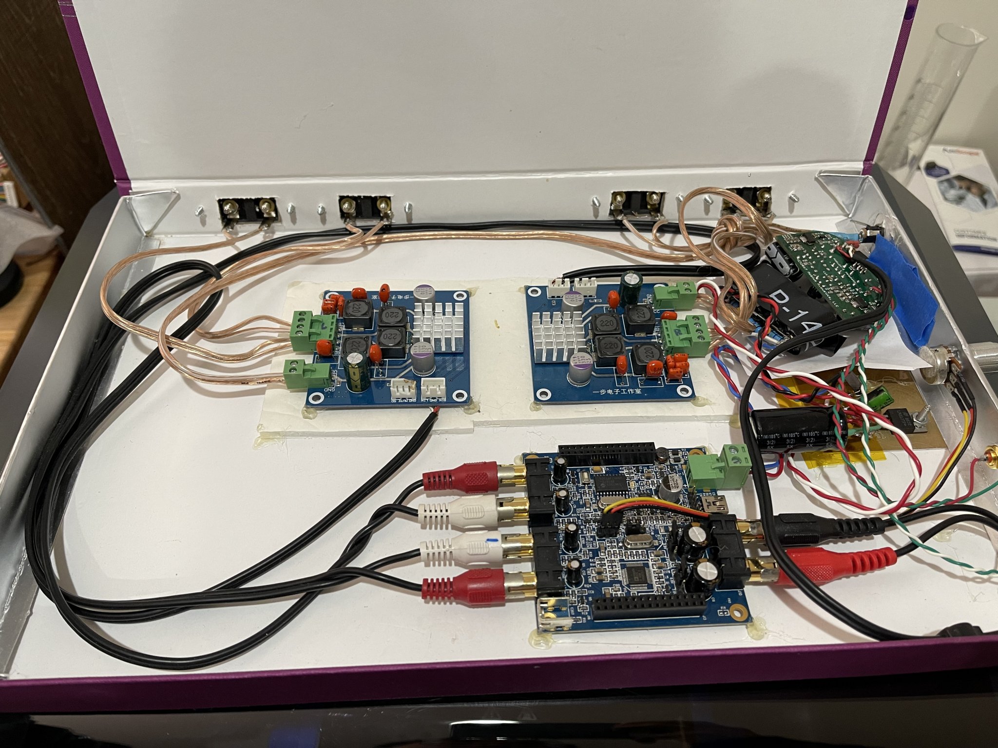

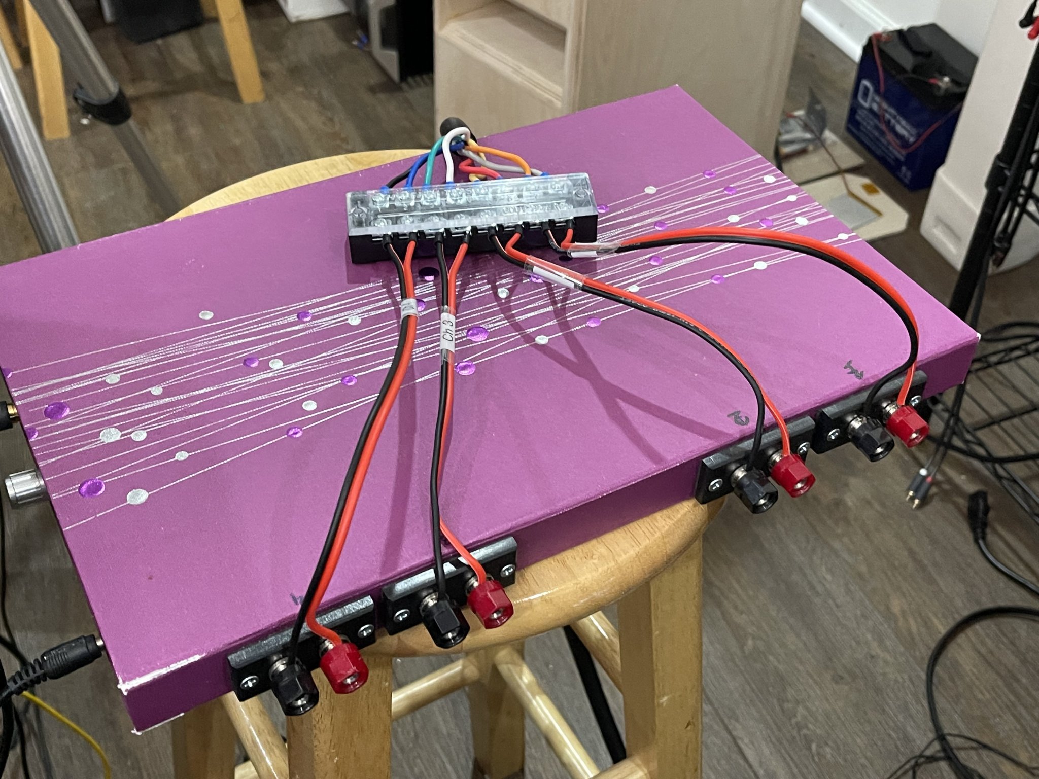

On the bench today is my old miniDSP 2x4 setup with two TPA3116 amps and a PCA preamp. Will be using it to test out a new subwoofer design I made that has 4x 10in drivers in a ring topology.

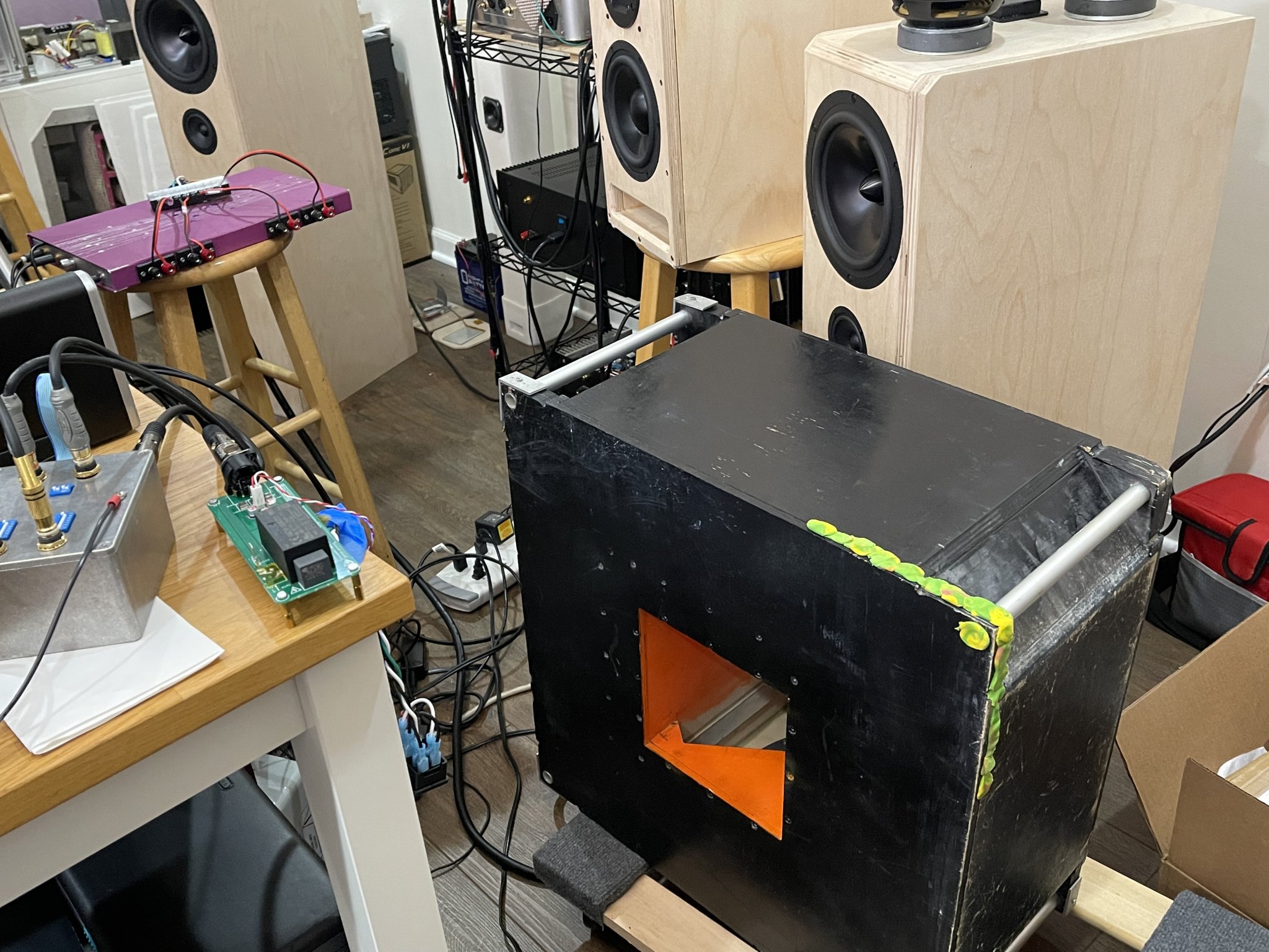

I got the miniDSP hooked up to the monster subwoofer.
This sub is insane. It has 4 drivers in a ring horn. It can take 1000w and I was only playing it at 25w and the house was shaking. Very clean deep articulate bass.
It’s a commercial design I have been working on with a team of partners in Califomia for a number of years now. The company is Mobius Acoustics - we were at the last in person Burning Amp event. This is an early prototype. Once it is released we can give more details about the internals.

not sure what a ring horn is but that looks awesome for a portable non-backbreaking P.A. Too bad my gigs dried up 2 years ago and now I'm probably too old to get back in the game if the pandemic passes.
That is a nifty sub by appearences. I was display at that Burnning Amp and probably missed them because I generally stayed around my stuff. Drat!
It’s a new horn topology that Anthony Bisset and I came up with.not sure what a ring horn is but that looks awesome for a portable non-backbreaking P.A. Too bad my gigs dried up 2 years ago and now I'm probably too old to get back in the game if the pandemic passes.

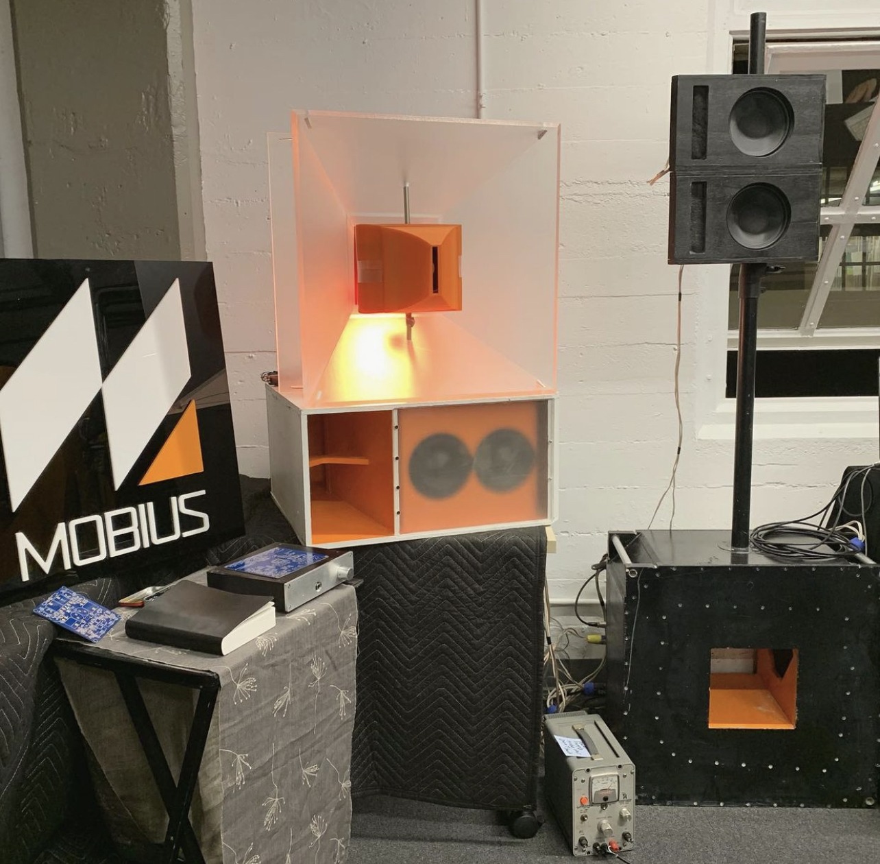

Here was our display at Burning Amp. I was not able to make it but others from Mobius were there.

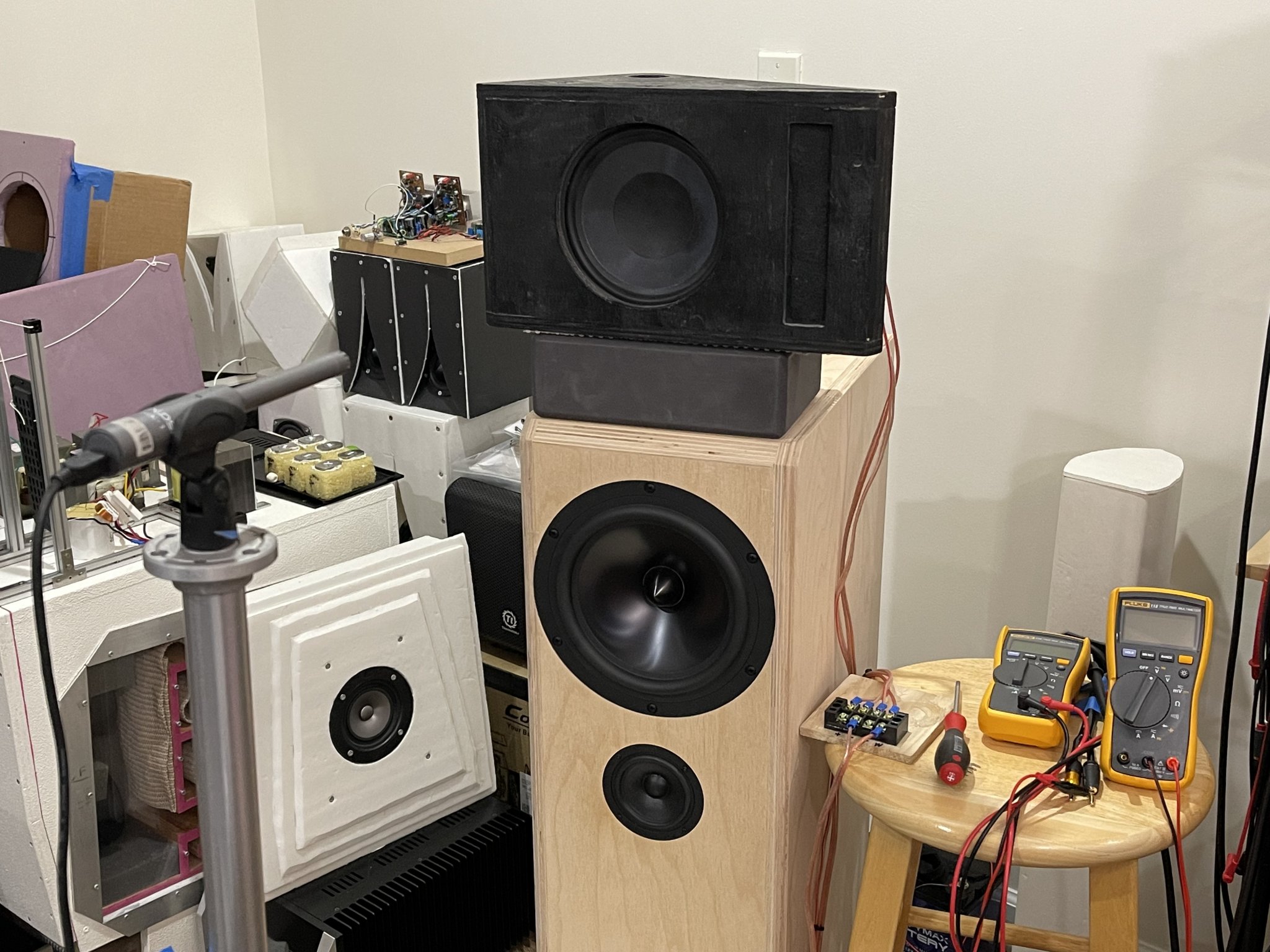

On the bench tonight is the top speaker from this setup. I am developing a passive crossover for it. We can save a DSP active amp channel this way.
Initial simulations are good. Will make some Wago connector P2P and try it out soon.

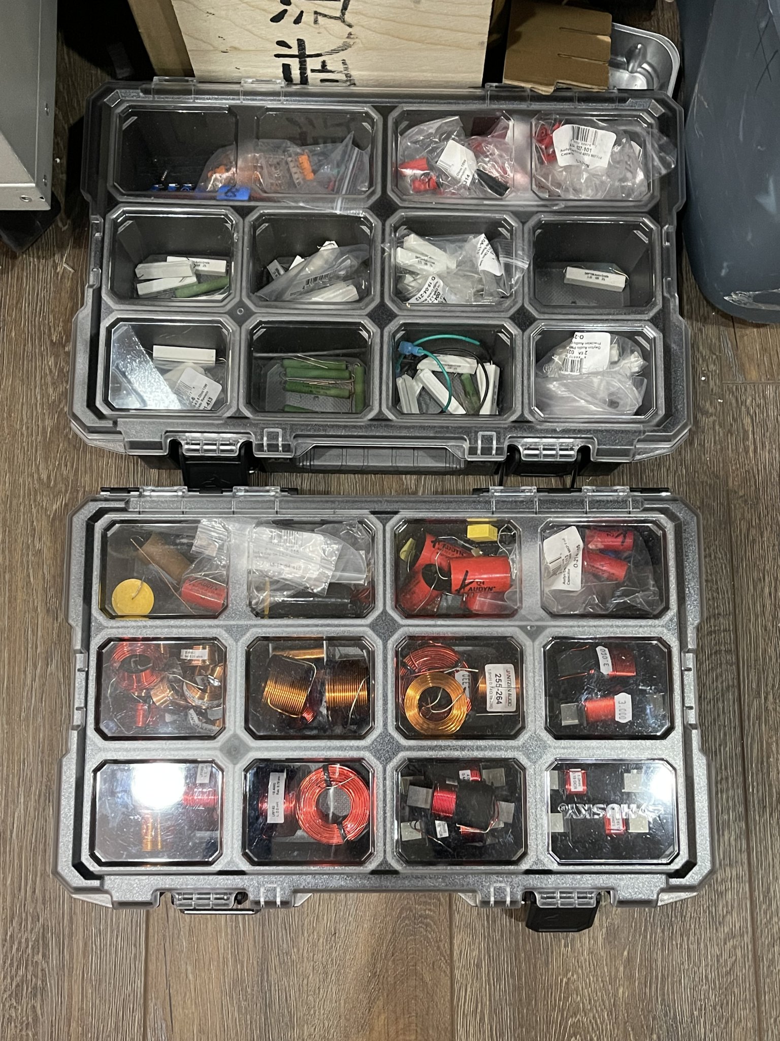

Pulling out the crossover development kit. It’s grown a bit and has quite the assortment nowadays. The copper and iron adds up quick.
