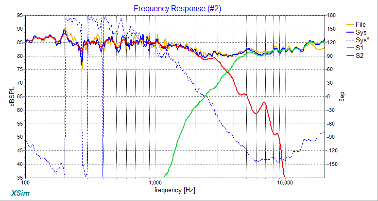

I finalized the crossover for the Signature 80’s today. Took a new set of raw data and tweaked the crossover - several components changed values oh so slightly but they make a difference.
Here is the new measured (yellow) vs predicted (blue) response:

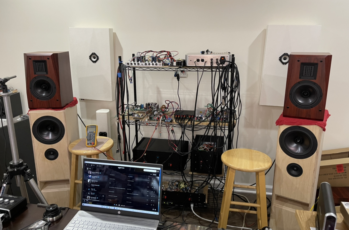

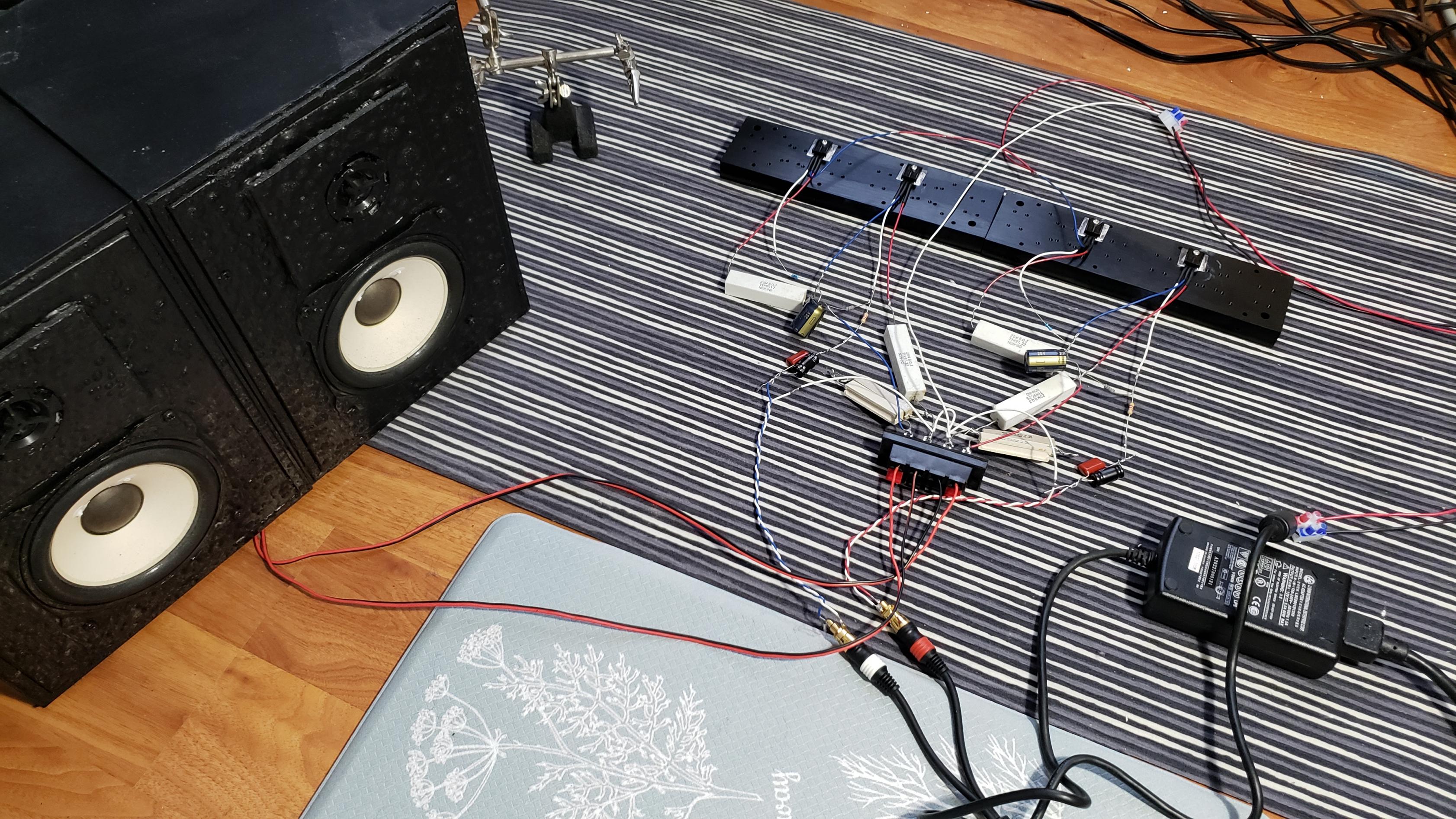

Speakers completed and now in stereo:
Video of speaker in stereo:

You have golden ears! Here is the chain. Warp-1 is TPA3255 amp with BTSB panel mount input buffer.
Amazon HD music (track was only 48kHz 24bit)//USB//Khadas TB1 (192kHz 24bit setting)ES9038 DAC//SMSL E30 preamp/headphone amp//Warp-1 amp with RCA inputs//12 ga speaker cables//LSA Signature 80 speakers.

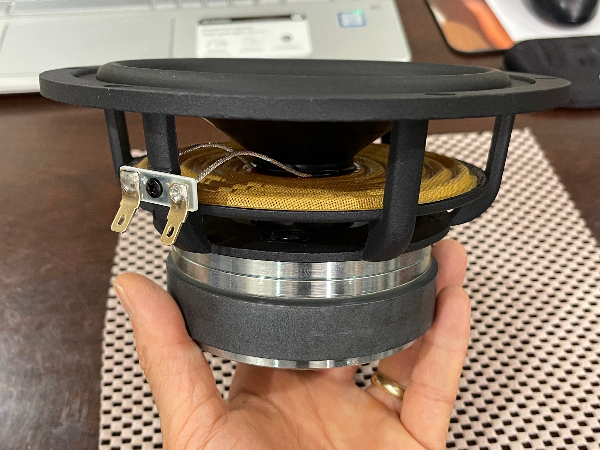

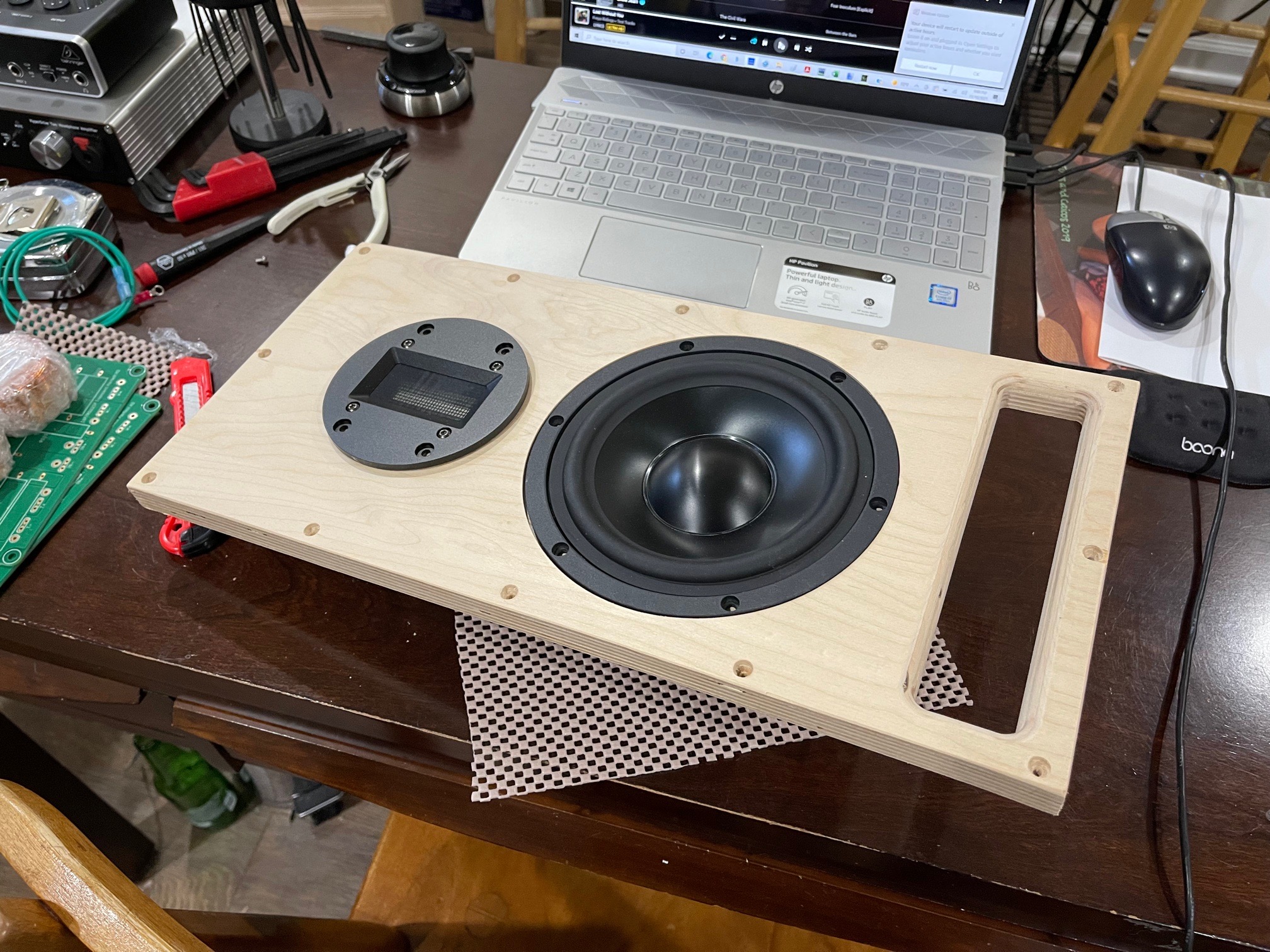

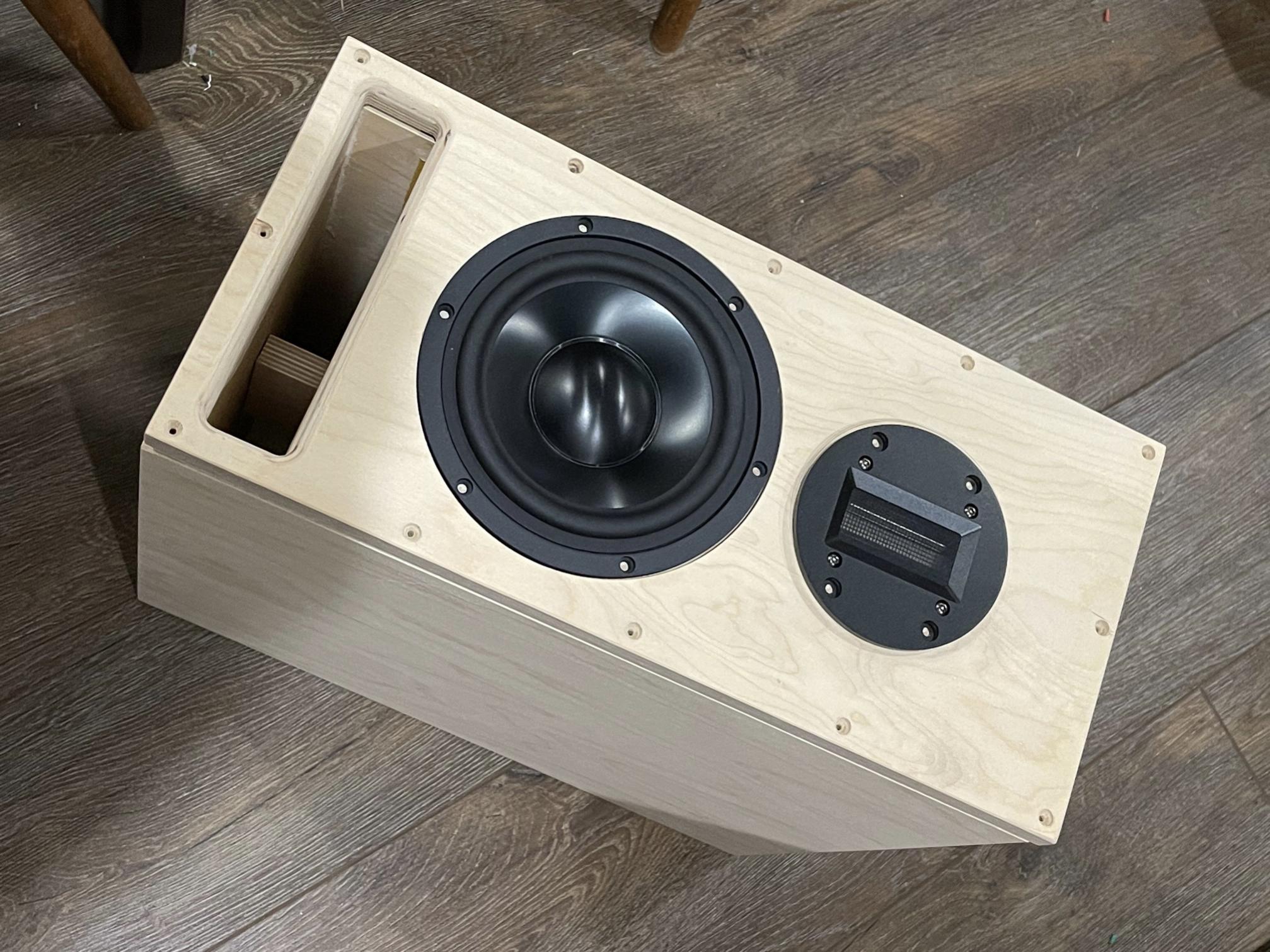

This 6.5in Al cone woofer sample I have just happens to fit where the Purifi used to go. This ribbon tweeter also happens to fit where the RAAL used to go. Hmm… could the TL work? It would just be too much luck if it did.

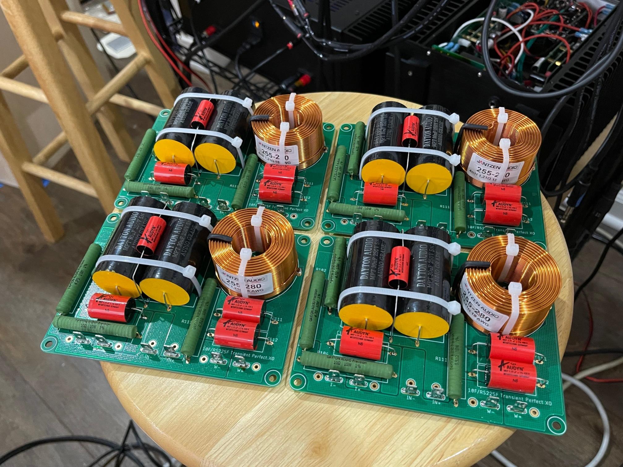

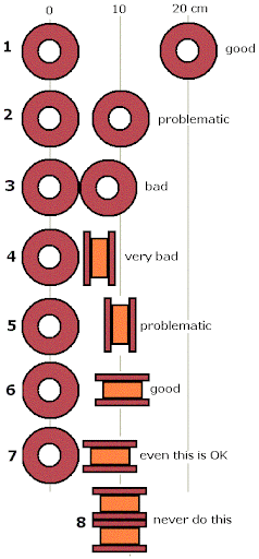

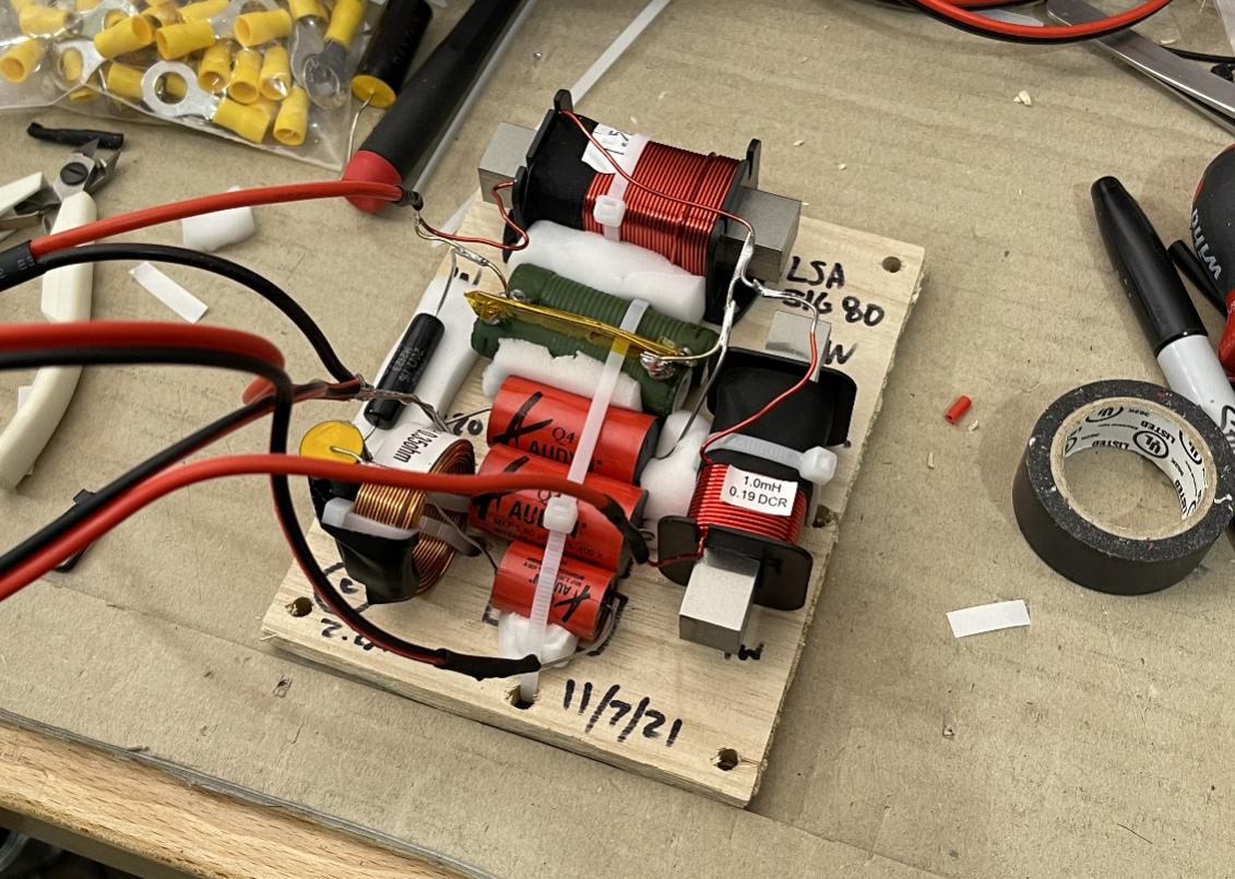

I finished assembling four new crossovers for the TLs for a customer in Hawaii and a friend in Texas. As I was testing them, I discovered what is meant by inductor crosstalk. Air coil to air coil transformer!
Demonstration of Inductor Crosstalk in a Crossover - YouTube
You need to put at least 1A through to get some power.

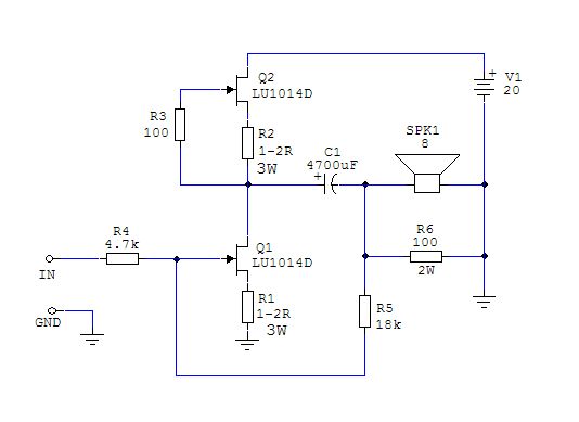

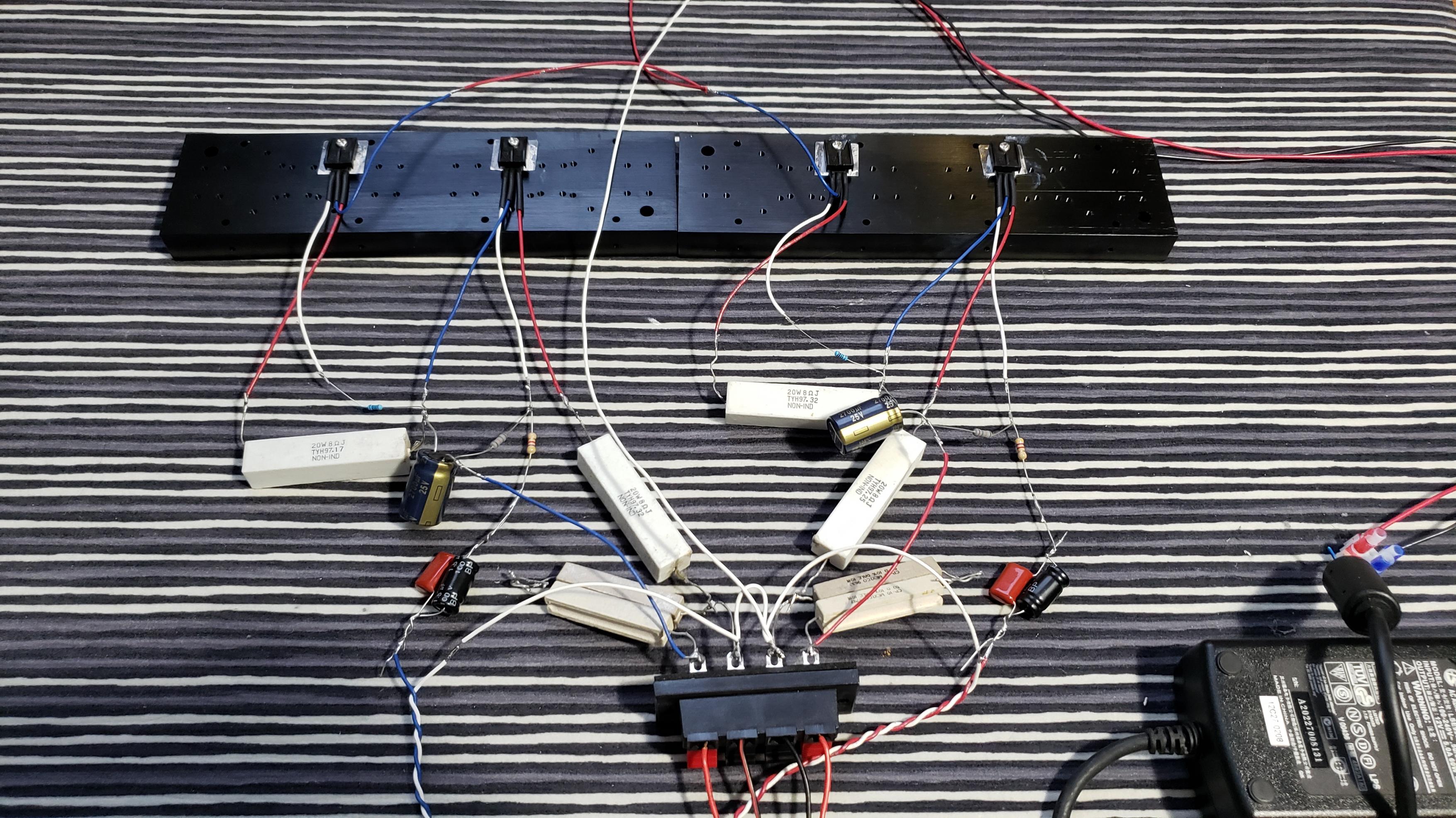

I am tempted to try this next. Credit goes to Juma.
I have 'simulated' this circuit. Works. Had some hum on linear supply, so i switched to 12v brick. No hum. Sounds loud and clear.
I started with 8 ohm for those resistors, as i do not like things toasty.
Definitely nice circuit. Even i do not fully understand the nature of the feedback.
Vunce, try this circuit.
When i used linear supply and variac, optimum power supply was about 12-14 volts only. Increasing it to 20 decreased the volume and was not sounding as good as at 12v. Just my observation. Maybe with some modification, it could work on higher supply. But why, it sounds plenty loud now.
