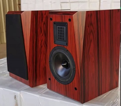

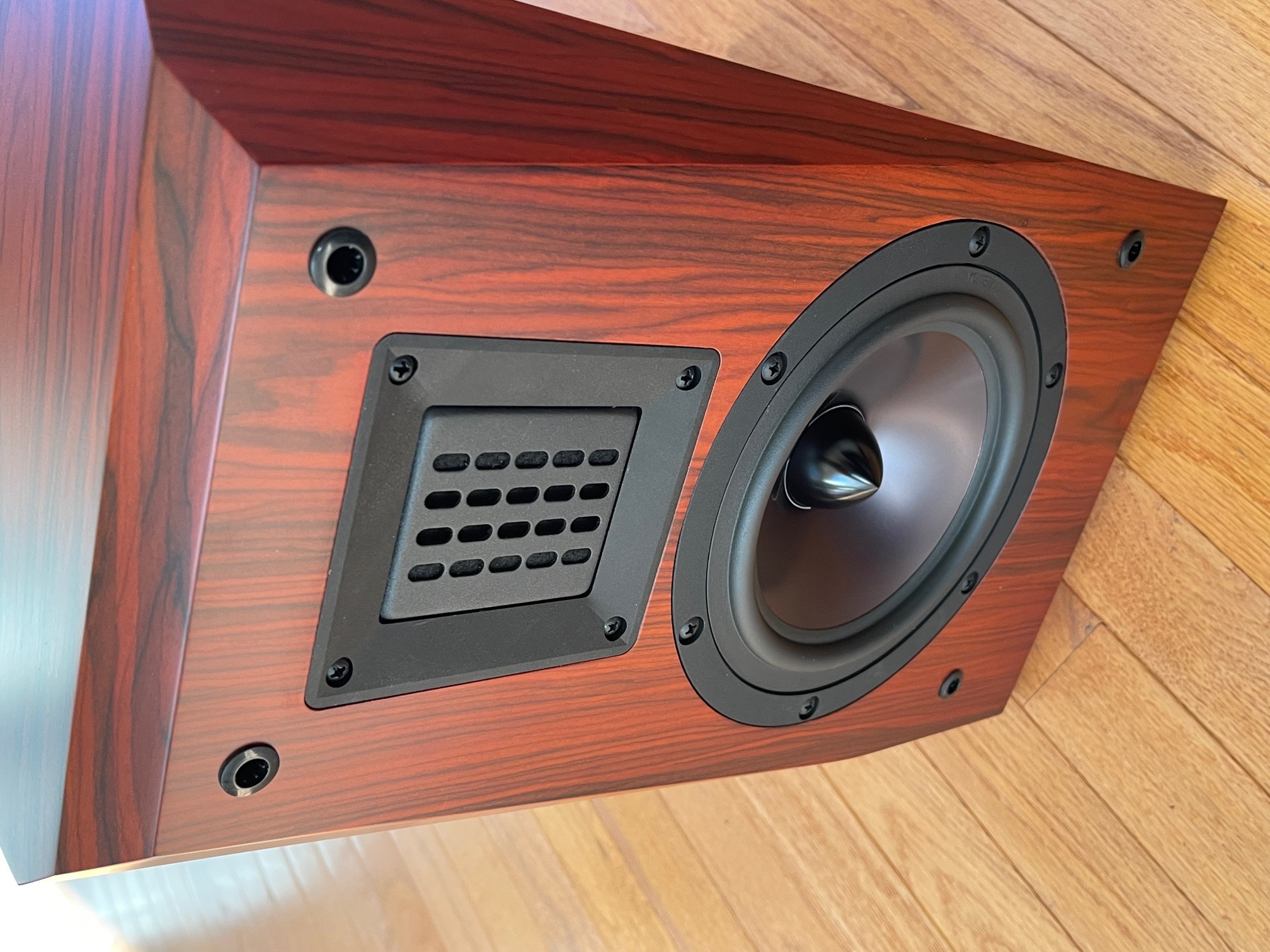

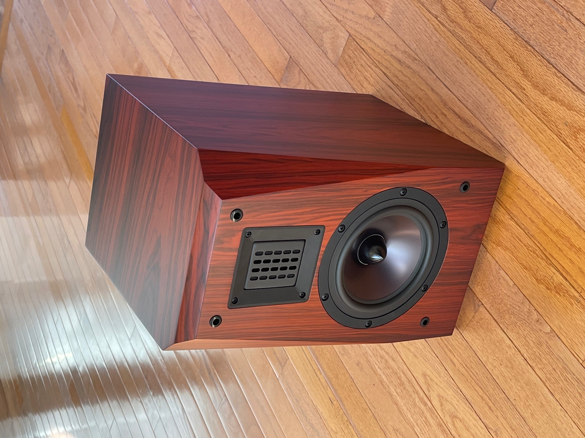

I have some pre-production samples coming my way for some final XO tweaks and adjustments. These speakers have the custom CNC waveguide for the tweeters, and a beautiful rosewood veneer cabinet with solid copper Viborg binding posts. Crossover will use nice custom made MKP caps and heavy gauge inductors.

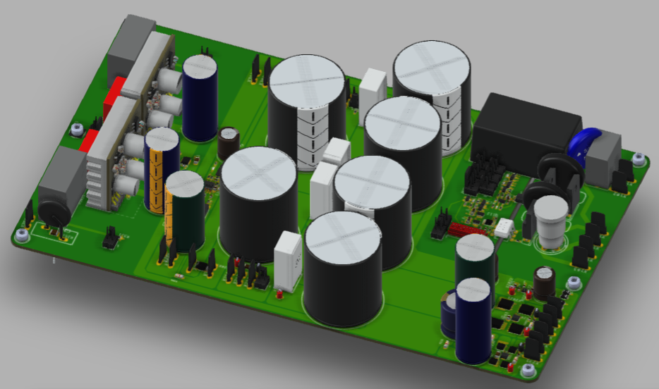

On the virtual bench, I am working with JPS64 to develop a main board for a new 100w Class A amp. This holds the soft start, an active bridge and CRCRC PSU, front end HV balanced preamplifier, and solid state relay speaker protection.

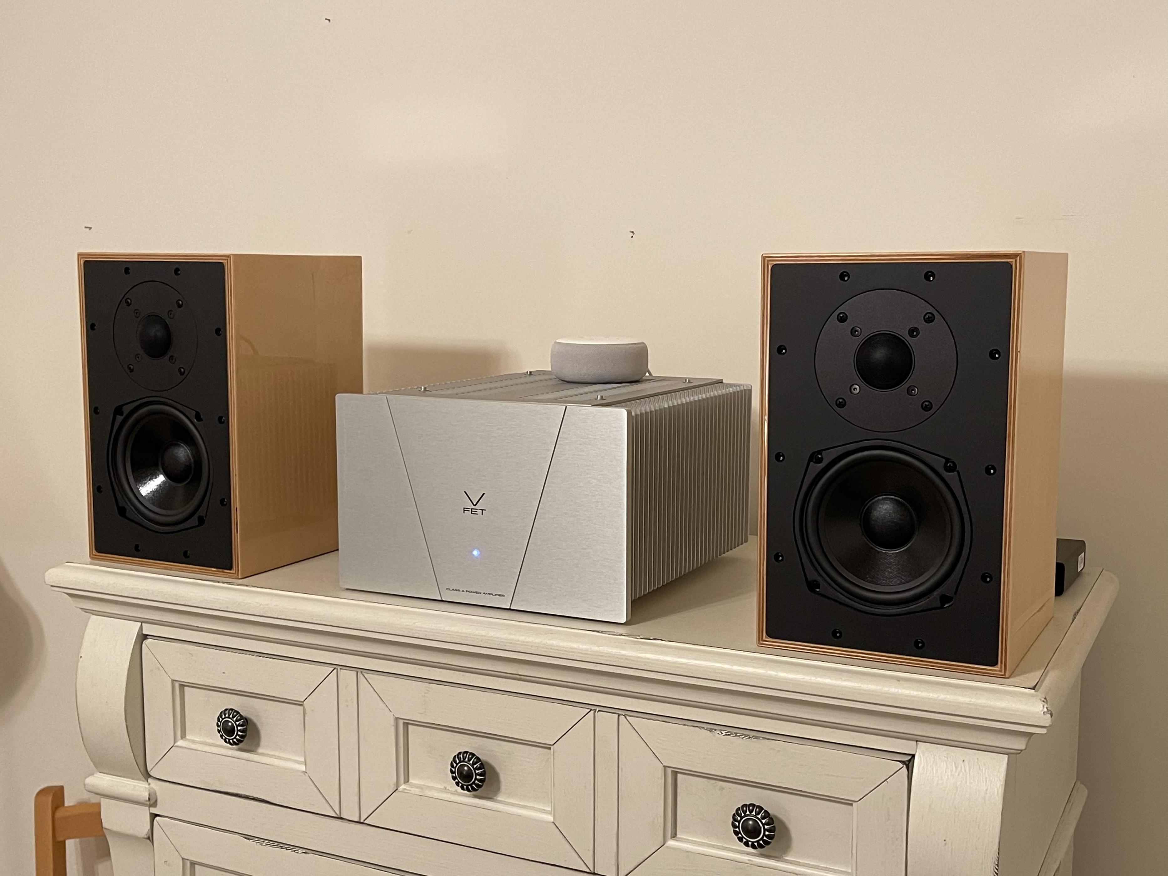

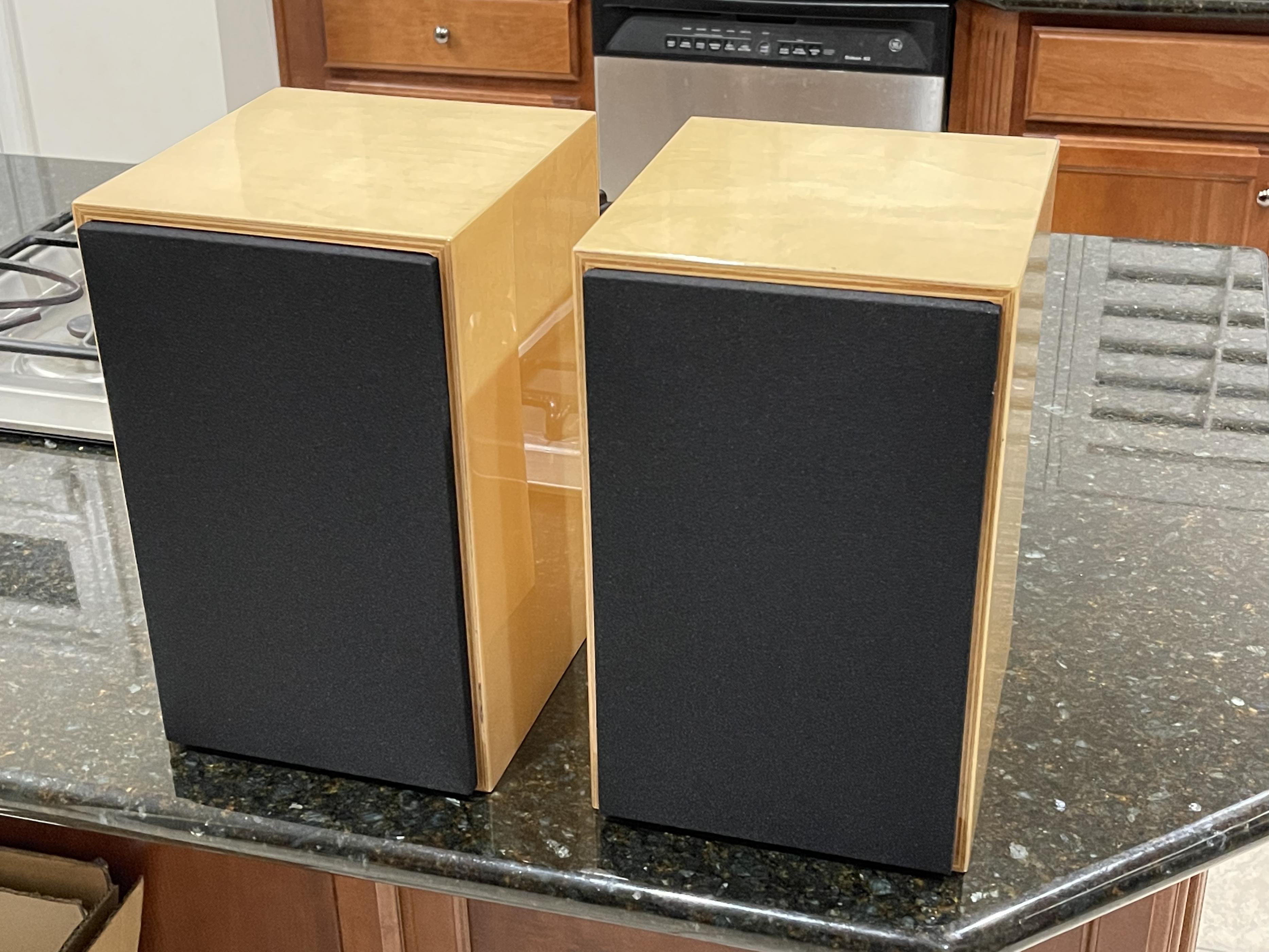

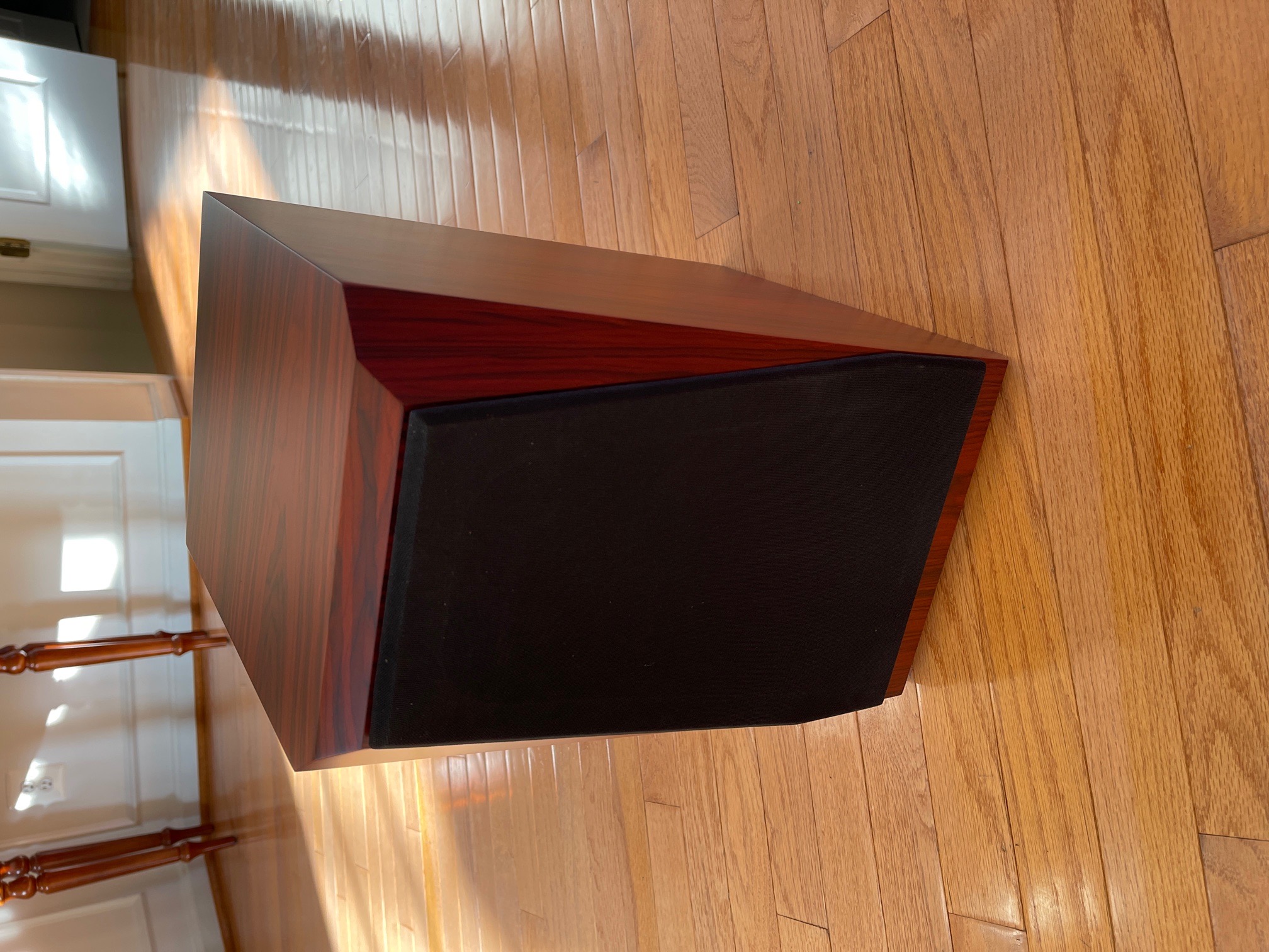

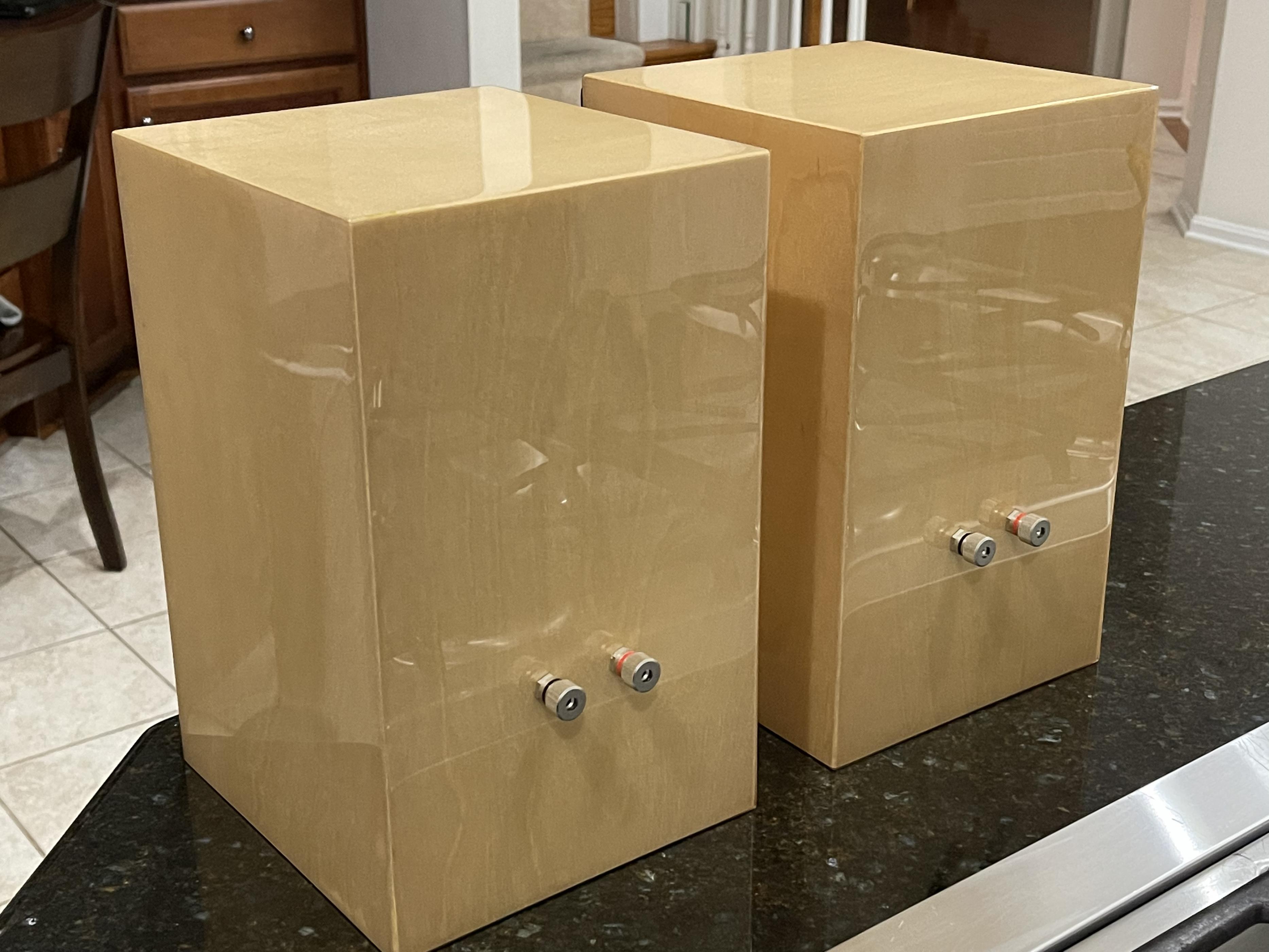

The new samples of the Vanguard speakers in high gloss finish are here. They sound great paired with a VFET.

Beautiful finish there, X! When might these hit the market?

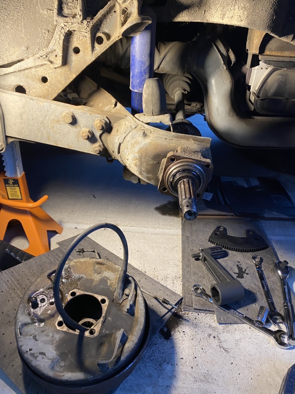

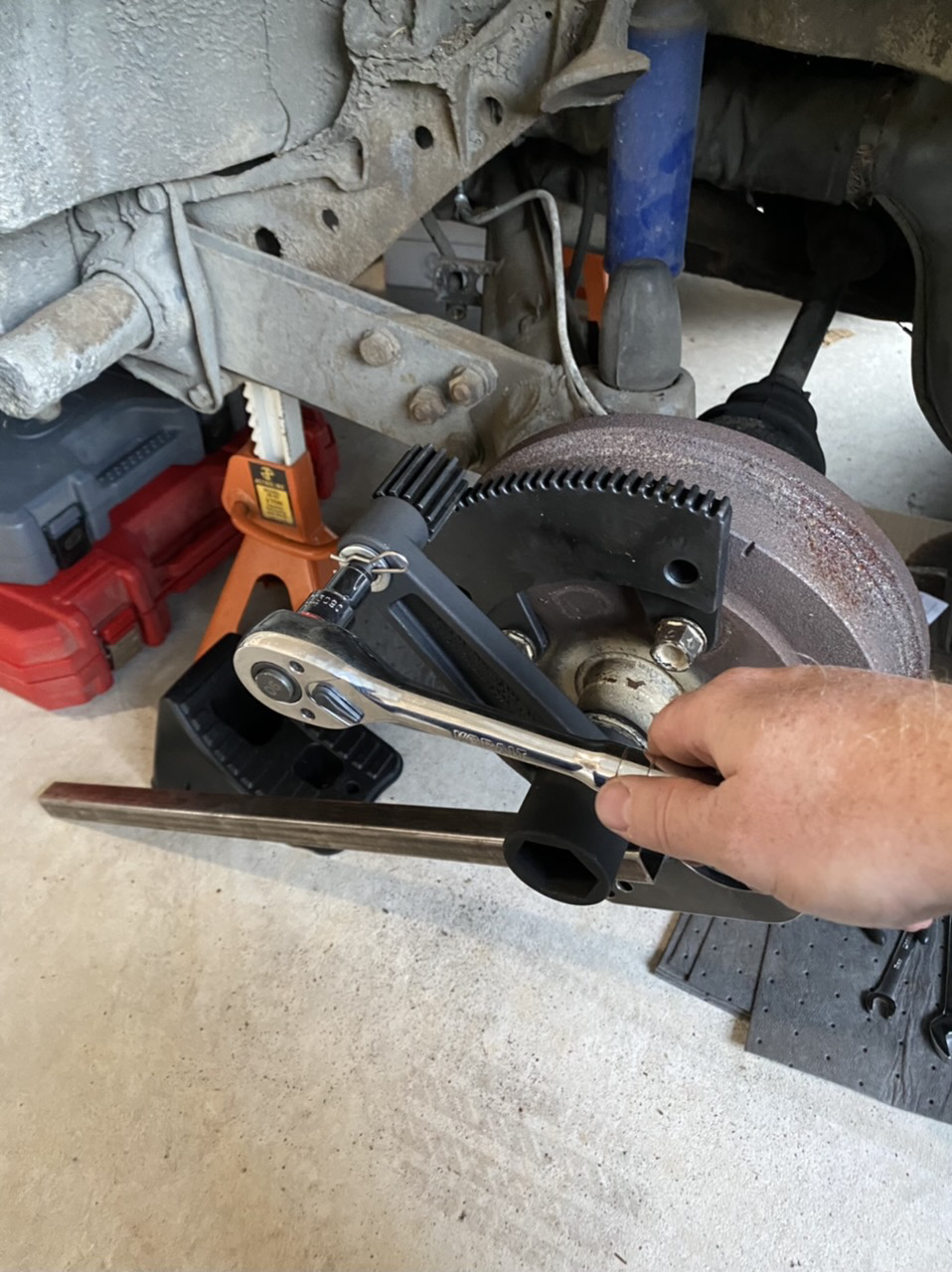

Shifting gears, literally. My bench has moved to the garage for now. Working on disc break conversion on all 4 wheels of my ‘69 VW Beetle. One of the best parts is the new tools I’m gathering. In particular a torque multiplier. The rear axle nuts on these cars are torqued to 225ft-lbs. After years of driving it can take over 300ft-lbs or more to break them loose. This tool multiplies torque by almost 10:1 making the task as simple as turning a ratchet.
