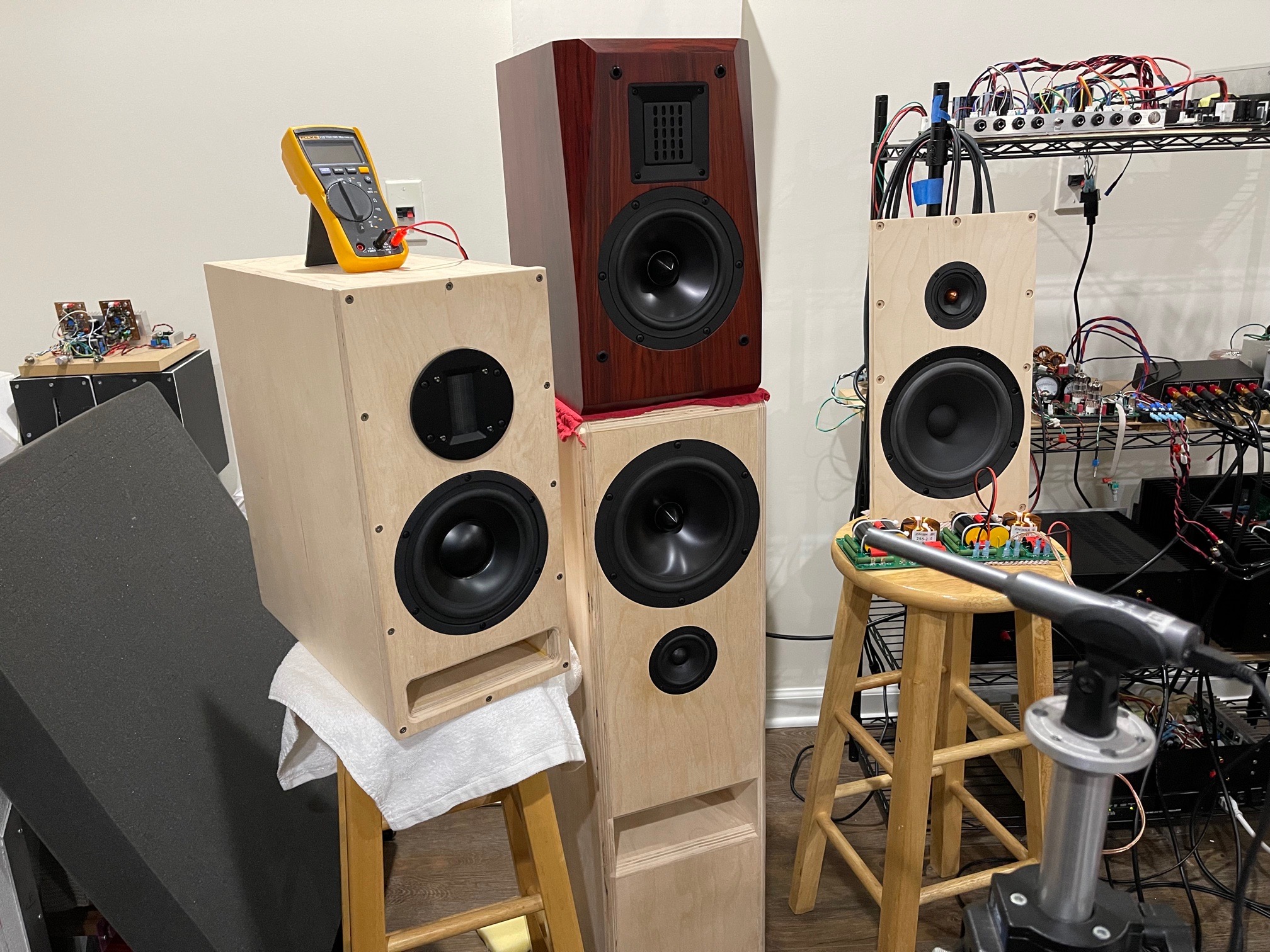

What happens when you stick a random woofer and tweeter into a TL cabinet and XO designed for another set of drivers? Surprisingly good results is how I would describe it.
I got samples of a new OEM ribbon and it happened to fit the cutout for a RAAL. The aluminum cone woofer also fit the cutout for the Purifi PTT6.5. I had the crossover already - a Harsch passive design and adjusted the tweeter padding. Here’s what it sounds like with that simple change to a resistor:
