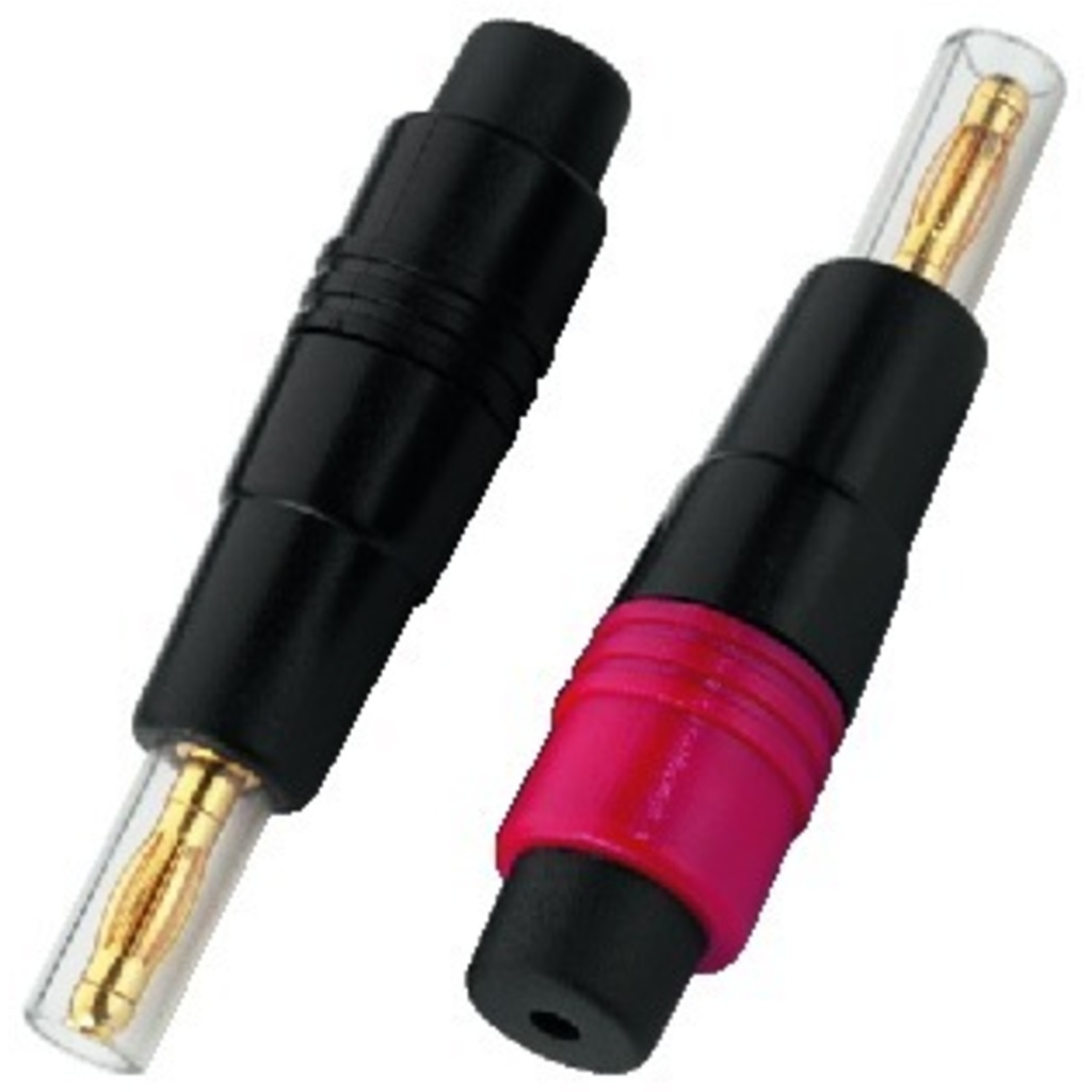

My all time favorite. Works on the speaker cabinet as well as on the amp. $2.88 🙂
My other all time favorite (inside amps and speaker cabinets) are crimped spade connectors. Cheap, reliable, high current, very fast to switch out.

I have done a number of base-plate mounted terminals. Mostly WBT terminals. Doing custom work, when a customer comes to me with more money than brains, whom am I to
not oblige? Silver WBT's with silver wire to the drivers is audiofool heaven.
Seriously, though, base-plate mounted terminals are easy to do and with the right choices are a low mass solution. My only objection is that the base plates do not come with 3/4" terminal spacing, so double bananas can't be used for fast swapping. I suppose you could drill your own base plates, but....

As much as I like speakons, I agree that they need some space behind the speaker -- 6" or so depending on how stiff the speaker cables are.

A binding post have to be rated for correct current, have good connection and plated fo no or minimal corrosion over time.
For normal home use, I think current is not a problem, but for high power it is an issue

These are pretty good connectors for shows if you can't use Speakon or those Y shaped double-pronged plugs (great providing the spacing between the binding posts matches. If not, you're screwed). Endless fun terrifying half the people in the room by hot-shifting between different speakers. Neat sliding protective cover.
