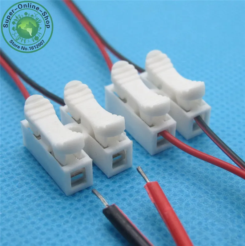

So I can see how bare wire hanging out of the back of the cabinet is probably a no go for commercial speakers, but for a DIY-er like me, it could be just the thing. The three sets of cabs I'm making will be re-positioned many times, so I can't go bare wire right to the amp (i.e. the distance to the amp will change a few times over the lifetime of the cabs). So how about using some kind of terminal block/connector to securely connect the cabinet wire to whatever length is needed to get to the amp? Maybe there's something like this avail. but with just two connections..?
