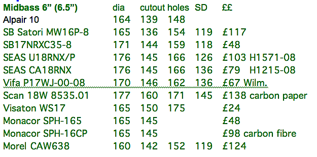

Maybe you need a good 2-way design?I've been looking at some 6.5" mid-bass drivers and here are some cheaper examples. Any recommendations here? I'll need crossover designs too.
Yes, indeed. I was previously thinking 5.25" but I'm looking at 6.5" now.

Why these designs? These are the only 6.5" 165mm projects for which I have crossover designs. Do you have any more designs with crossovers you can suggest?The Elsinore is not comparable to the others. And if I had to pick one, that would be it in this list. But why these designs? There are numerous 6"/1" designs out there worth investigating. Look for a well-documented one (including measurements), certainly if you're not able to listen first.
You seem to like the Elsinore - yes, it's a 3-way but I'm wondering if it's possible to just use it as a 2-way? It would need a revised crossover, and I don't know how to do that.

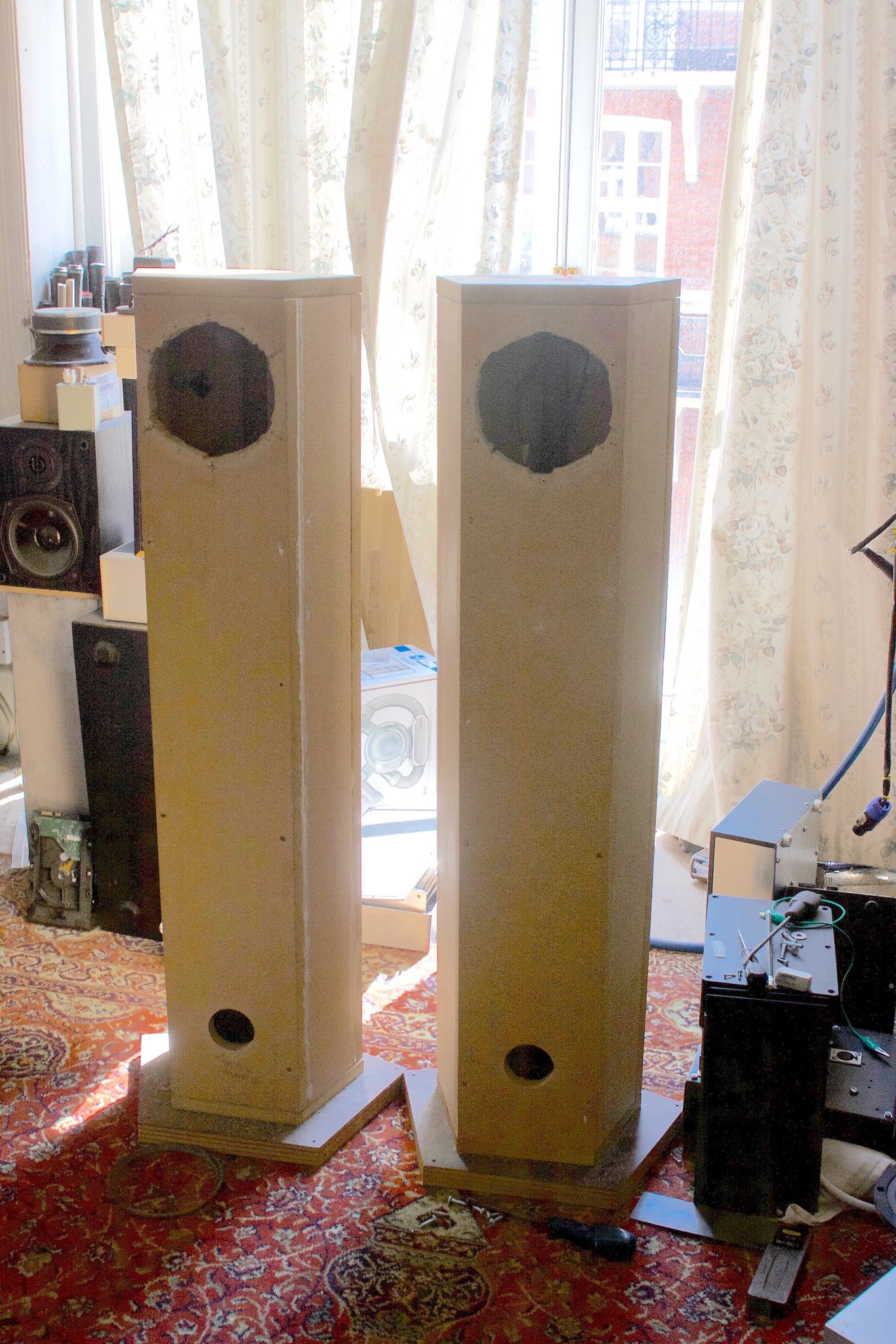

Reviving this thread since I need to make a decision on drivers and crossover. I have a pair of 5 sided columns I'd like to use. They are around 16.5 litres and the width of the front is 155mm. So a 150mm unit like the SB 15MFC fits the present opening. I'm a bit of a novice at speaker building and don't have the means to design crossovers, so I'm dependent on existing designs.
There are 2 or 3 designs for the 15MFC but in enclosures more like 10 litres. Here the enclosure of 16.5 litres seems more suited to the SB 17MFC for which there are also suitable crossover designs. The would require adding some extra wood panels to increase the width of the front. Not impossible but it would be a challenge to make it look as good. The tweeter will go on top of the cabinet in some way as yet to be fabricated.
So please advise where to go from here!
I'd be grateful for any feedback on the 15MFC versus 17MFC or suggestions for any other 2-way designs that might suit. I'm in London, UK, so would source parts here like SEAS, SB, Scanspeak or Monacor for instance. Not much Dayton over here.
What is the cross-section, and height? You look to have an ML-TL there.
Don’t know about mids but it is the right volume (but the shape?) is close to ideal for reflex Alpair 10.3 or A10p. No woofer or tweeter required.

Hello Dave. Cross section is 160 x 115mm, height 920cm. It was a MLTL with a height of 1200cm, 24ltr, but I cut it down to 16.5ltr. Looks better in the room. It did previously have Alpair 10.1 units but I wasn't totally happy with them and preferred my 2-way Wharfedale Program 30D-6 speakers with polypropylene cones. So the MLTL is gone!
Thinking of using the SB 15MFC. Fs = 39hz, VAS 17ltr, Qts .36, EBP 98. Thinking vented. Not sure how that would work in 16.5ltr. I'd like some opinions on that.
