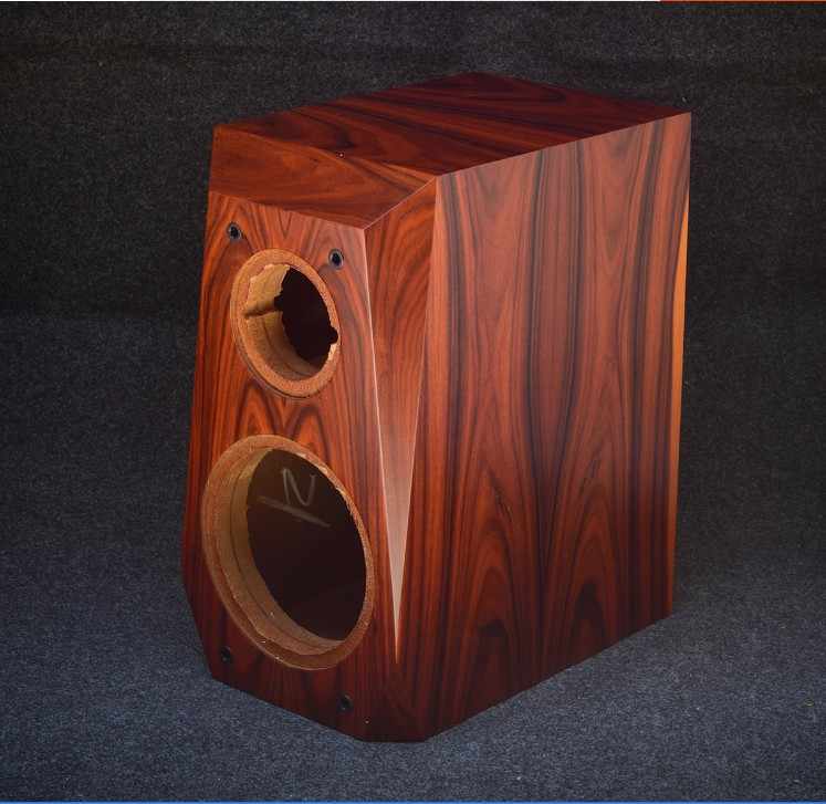

Something like this but with better internal bracing can work pretty good. A solid non resonant enclosure with non parallel walls will be a little bit better but is harder to make
