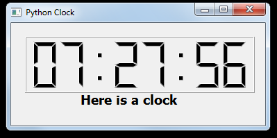

That succeeded. I wrote a tiny little Python GUI which implements a crude LCD clock:
Code:
import sys
from PyQt5 import QtCore, QtGui, QtWidgets, uic
qtCreatorFile = "MyClockGUI.ui" # Output of QtDesigner
Ui_MainWindow, QtBaseClass = uic.loadUiType(qtCreatorFile)
class MyApp(QtWidgets.QMainWindow, Ui_MainWindow):
    def __init__(self, parent=None):
        QtWidgets.QMainWindow.__init__(self, parent)
        Ui_MainWindow.__init__(self)
        self.setupUi(self)
        timer = QtCore.QTimer(self)
        timer.timeout.connect(self.showlcd)
        timer.start(500)
        self.showlcd()
    def showlcd(self):
        time = QtCore.QTime.currentTime()
        text = time.toString('hh:mm:ss')
        self.lcdNumber.display(text)
if __name__ == "__main__":
    app = QtWidgets.QApplication(sys.argv)
    window = MyApp()
    window.show()
    sys.exit(app.exec_())

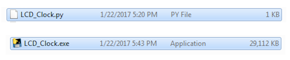

Then I applied PyInstaller to it, and got a self-contained Windows .exe file that runs on other Windows computers which do not have Python installed. Yaay! However there is one little snag (see Figure 1 below): the .exe is thirty thousand times larger! 1Kb input, 29Mb output. Cowabunga. Figure 2 shows this marvel of engineering in action.
